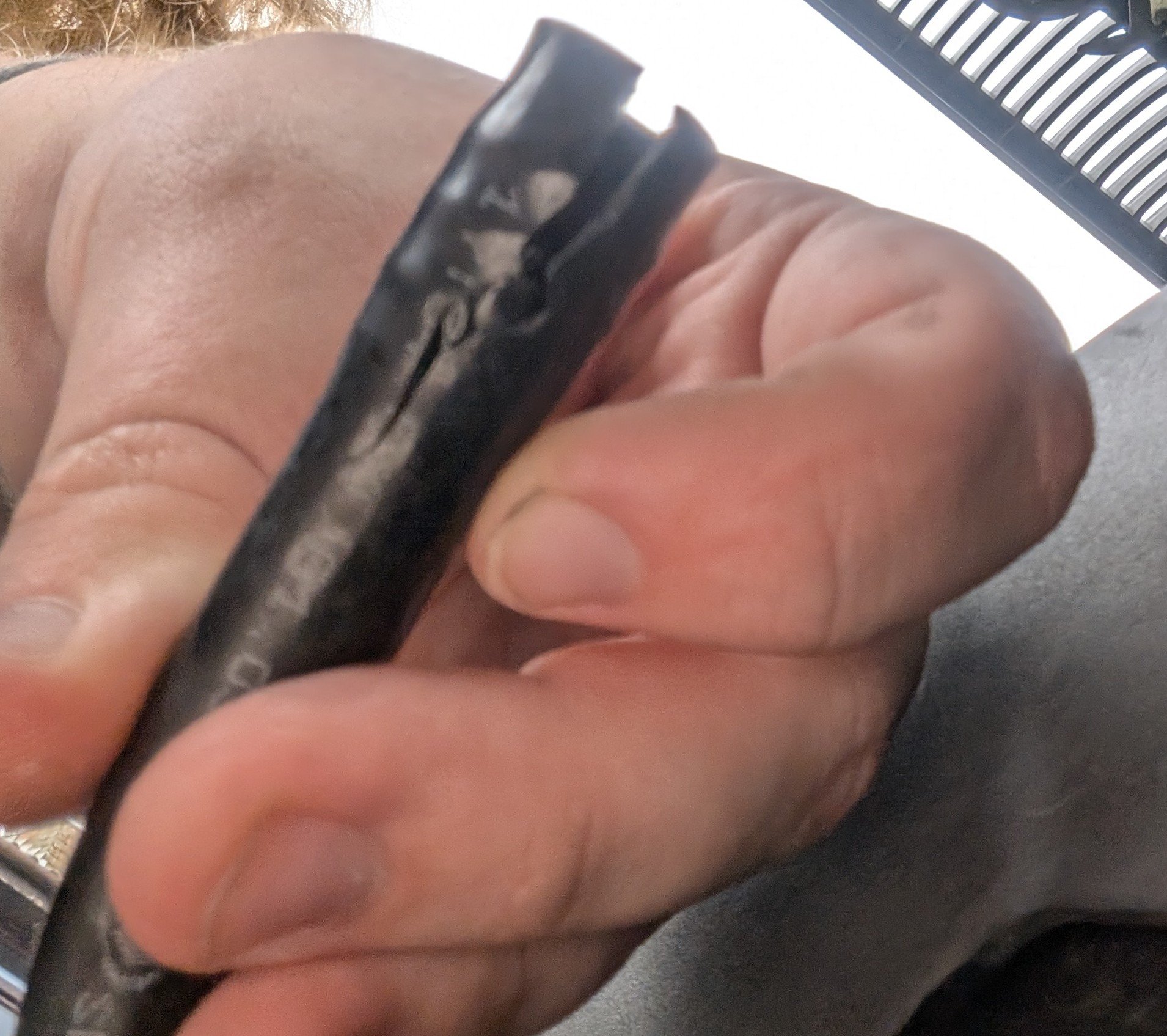

  1. After some shipping delays for the part, and a 2 week holiday of my own, I've finally fitted the replacement hose. The original part attached to the car was a bit different, being made of a short clamped flexible hose portion, whereas the new part is one single part for the whole thing. The trickiest part was breaking the single-use clips off the old part, plus also getting the new part to push in to the back wall of the engine compartment which needed a bit of grease first. The brakes certainly seem to actually have an effect with much less effort on the pedal itself, so I assume that's a good sign. Didn't notice any difference in engine idle which I saw some others mention. I've not tried it on the road yet as my car's blocked in by my parents' at the moment, but I might need to get used to the brakes again now. Thanks for everyone's help.

  4. I don't recall anything, honestly. It has generally been poor weather the last week or two, so it could be water, or it could be some other contaminant, or a mix of both. I did find that the rubber part of the pipe had split in another place, to the point that putting self-amalgamating tape around the bits I had seen caused it to fall straight off the hard plastic connector. In one of the pictures, you can see the slightly split connector with a grey pen or paint marking on it, which has a plastic connector, and another rubber hose on the bottom half. This pipe leads into the engine. The rear of that had entirely split, which is why I didn't see it. I have put tape around that as well, and ordered some jubilee clips to put around all 3 connection points for my own sanity. I do feel like the pipe leading into the engine may well need replacement as it seems to be quite inflexible compared to what I'd expect a hose to be like, but maybe I'm overreacting.

  6. I can't say either way really, but it does seem like that probably was what happened. Thanks for this. It does seem split where it connects onto other parts. Pics attached. I read a thread somewhere here that the part numbers should be clearly written on the hard plastic part of the hose, and they're unique to each engine model, but I can't see any clear part number on mine without taking it out and disconnecting it fully at least. I'll try and do some research to find the right part number for my model. Probably won't get a genuine one these days though. Tyre pressures fine all round.
