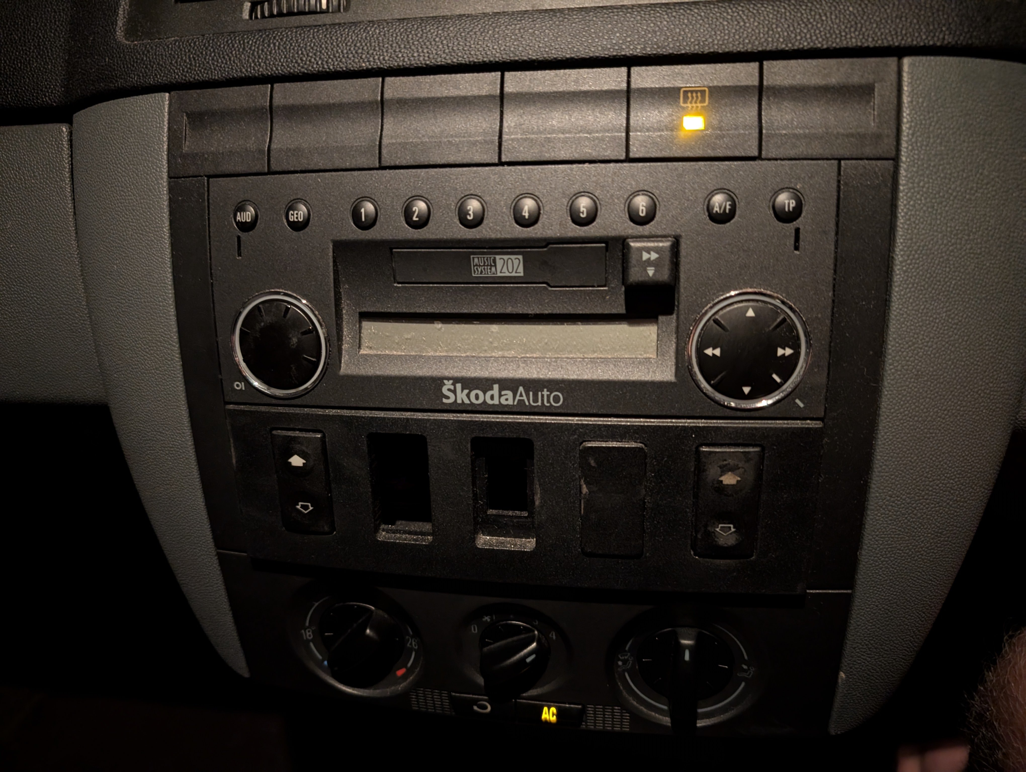

When the car was new from Skoda, I'm pretty confident it had manual windows all around, as the owners pack has a slip of paper detailling how the car was fitted with a electric window kit by the dealer prior to sale in 2003. This kit was a little panel of switches screwed into what would have otherwise been the recessed cubby/storage bay below the cassette deck. I've not seen any pictures online of any other Fabia that had this (picture below). I swapped out the cassette deck with a Sony double DIN head unit, so there's no space for the old window switches.

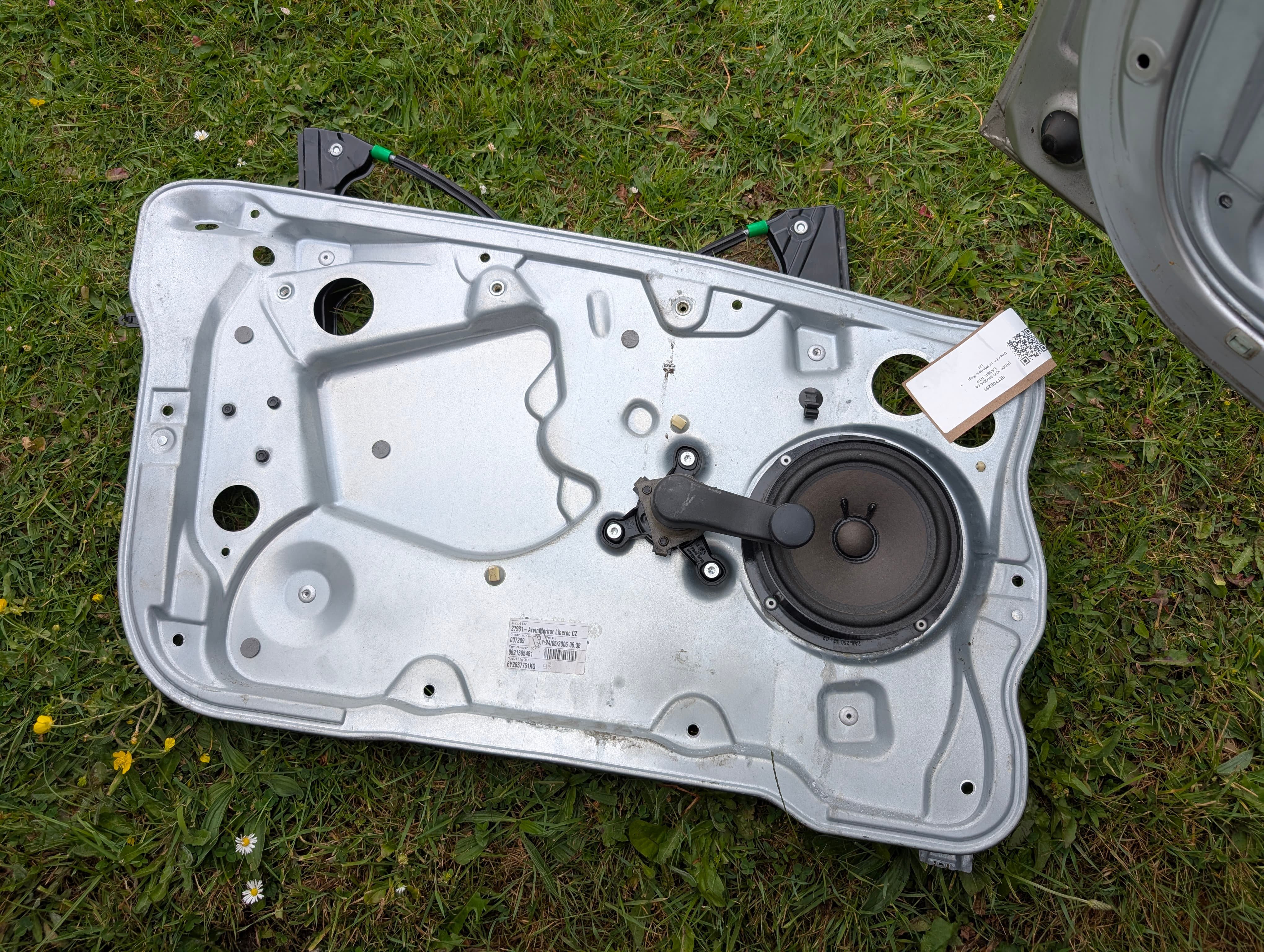

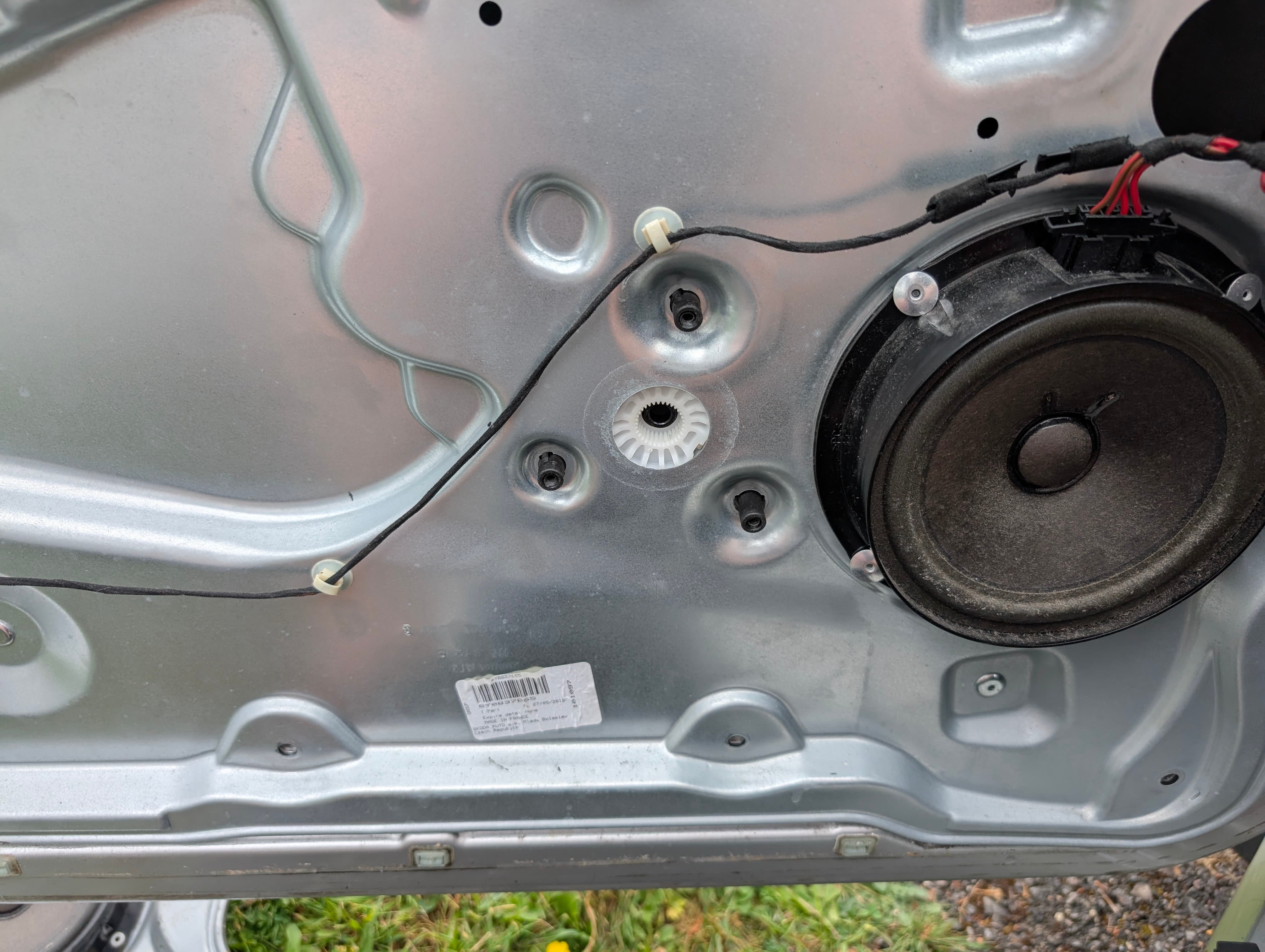

This is the replacement inner door assembly I bought off of eBay:

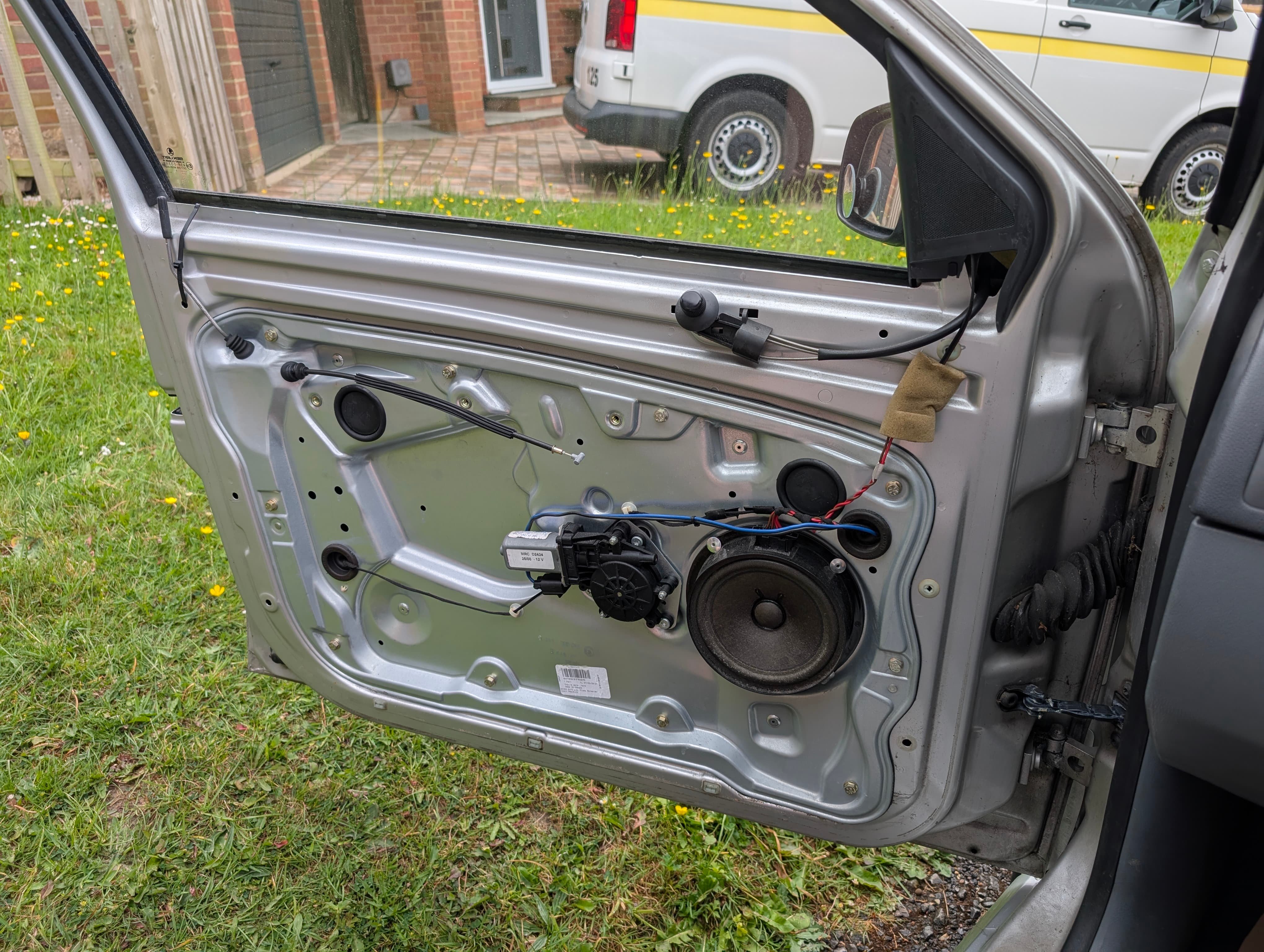

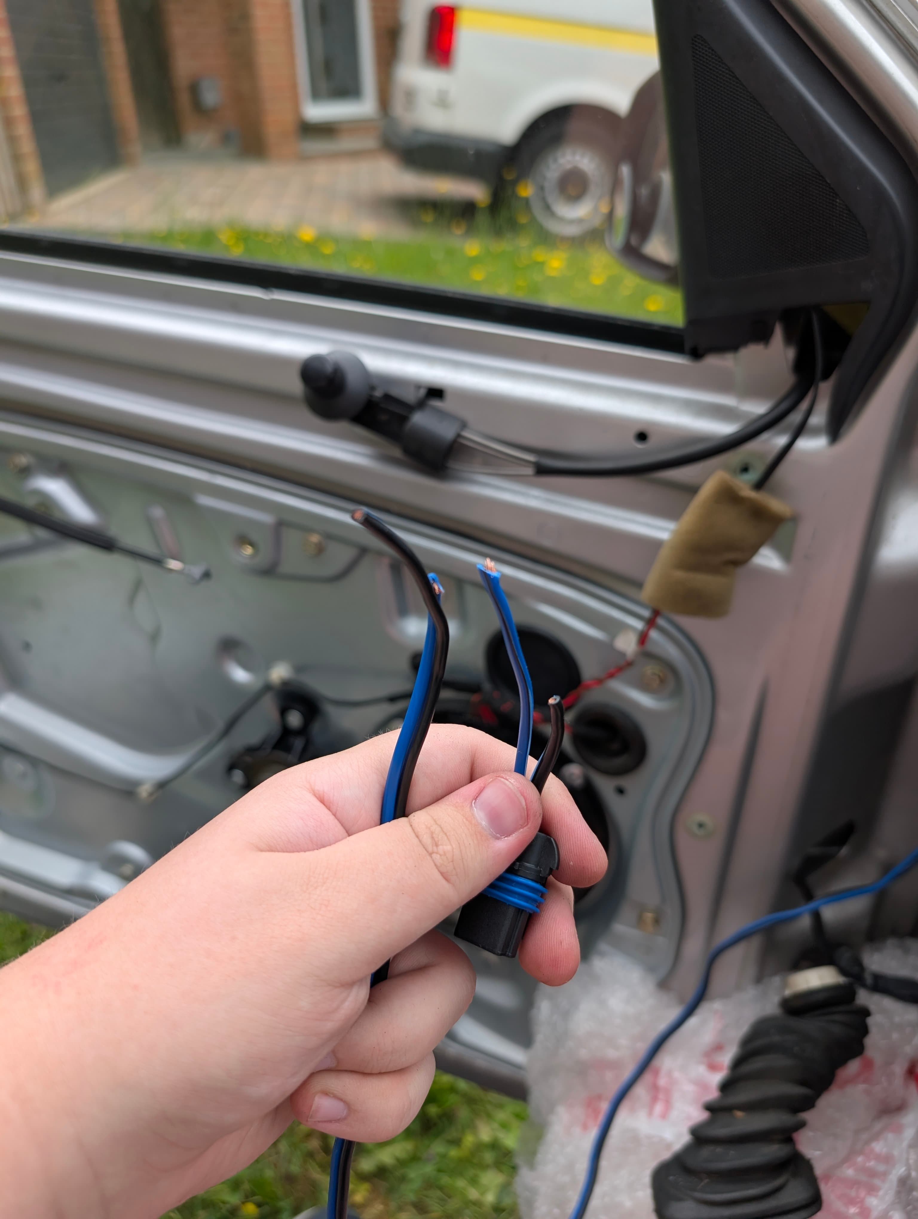

Here is what the door frame inside my car looked like before anything I'd done. You can see the blue+black cabling for the electric windows, which had been run through some existing gromits (with holes poked through them), directly through the door wiring harness thing and to the centre console.

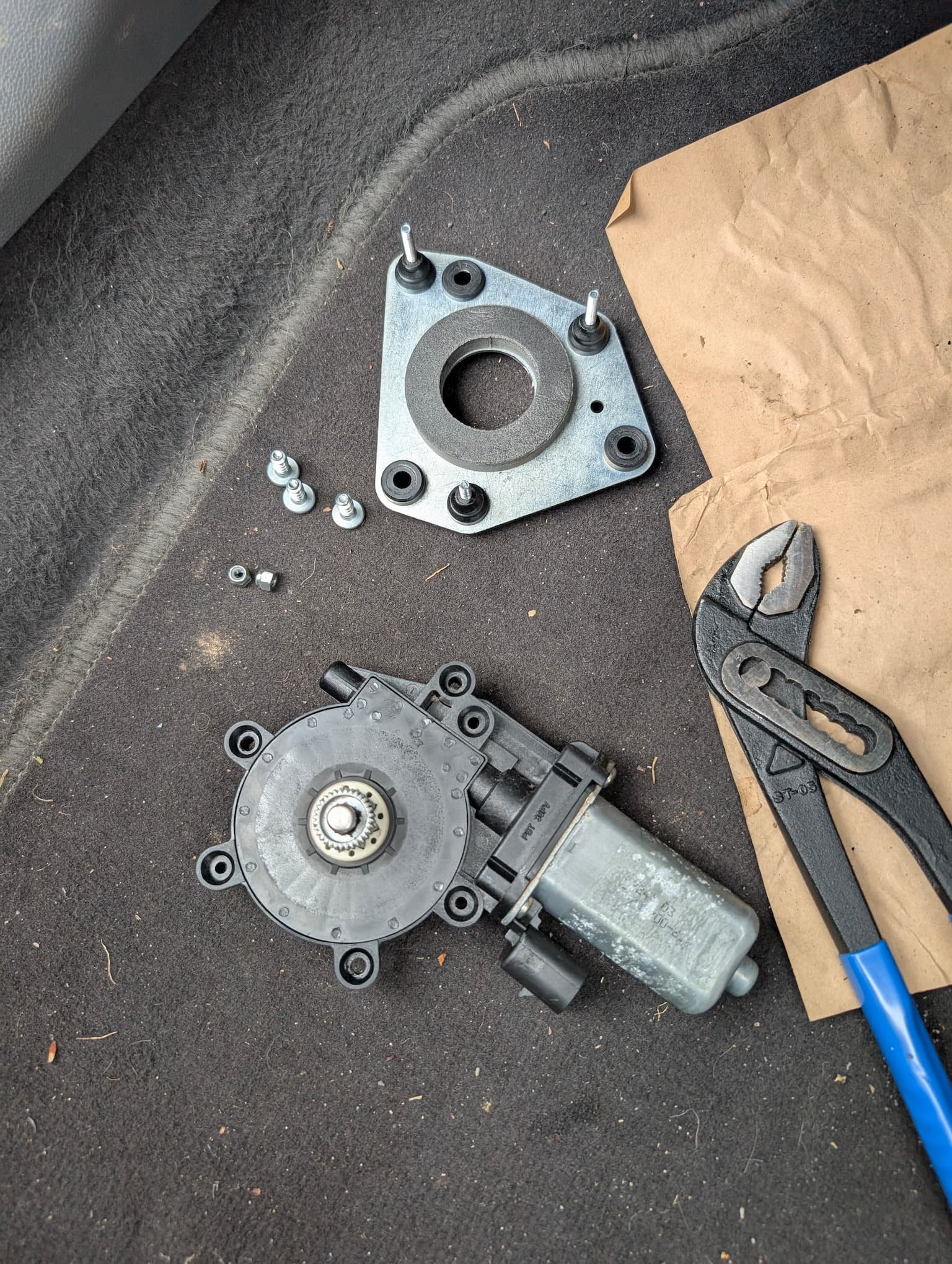

I took off the electric motor and adapter gearing, then snipped the connector off the end so I could pull it all the way through from the centre console to remove it.

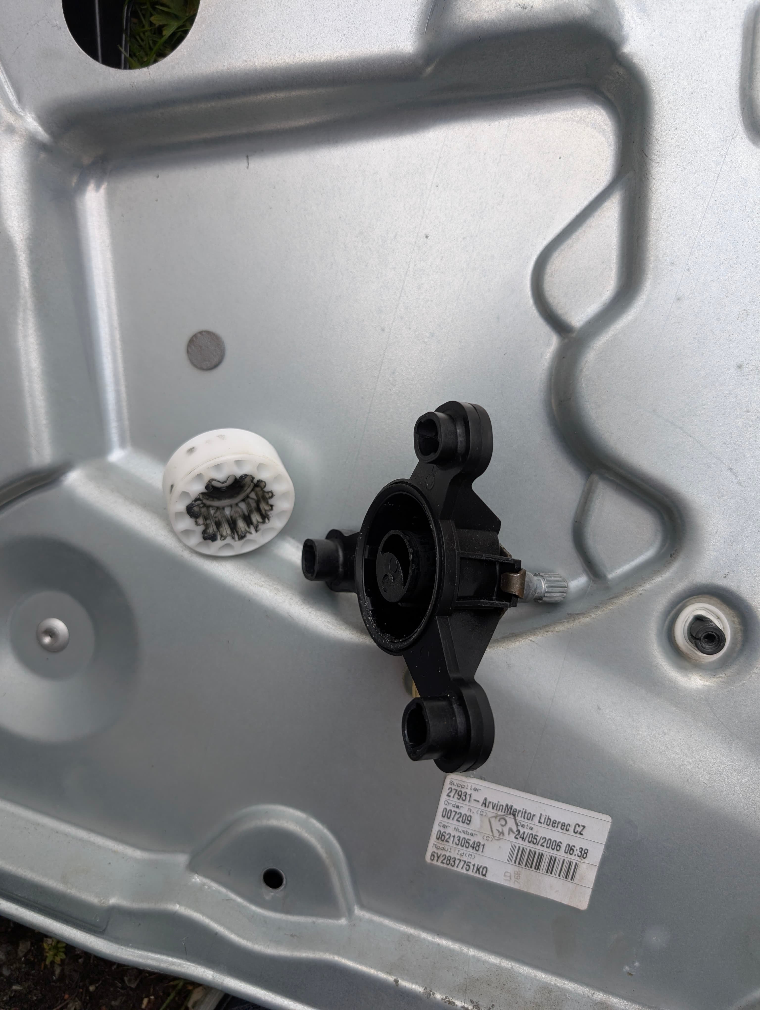

Here's the door assembly with the motor removed.

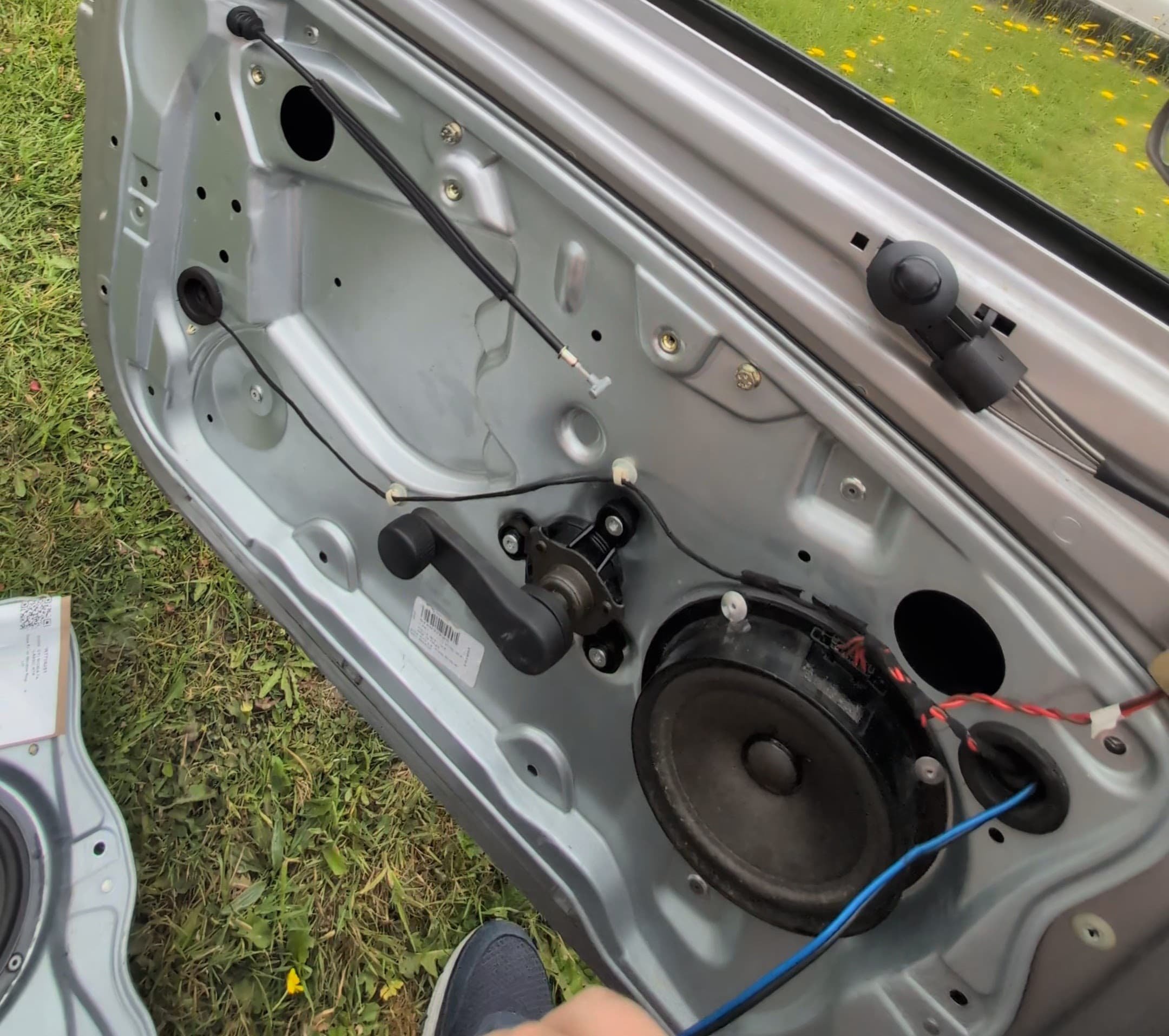

And here is the manual crank mechanism attached on to the car's inner door assembly. There was an adapter gear between the mechanism and the regulator itself. This was actually what had made me think I'd need to swap the whole regulator assembly (I thought they might be different between electric and manual), but thankfully I didn't need to in the end.
...and the old motor after removal below. It wasn't an OEM part, branded ELECTRIC-LIFE and labelled "Skoda compatible", but it was dated 19-04-2002. I think it's done quite well to last 23 years.

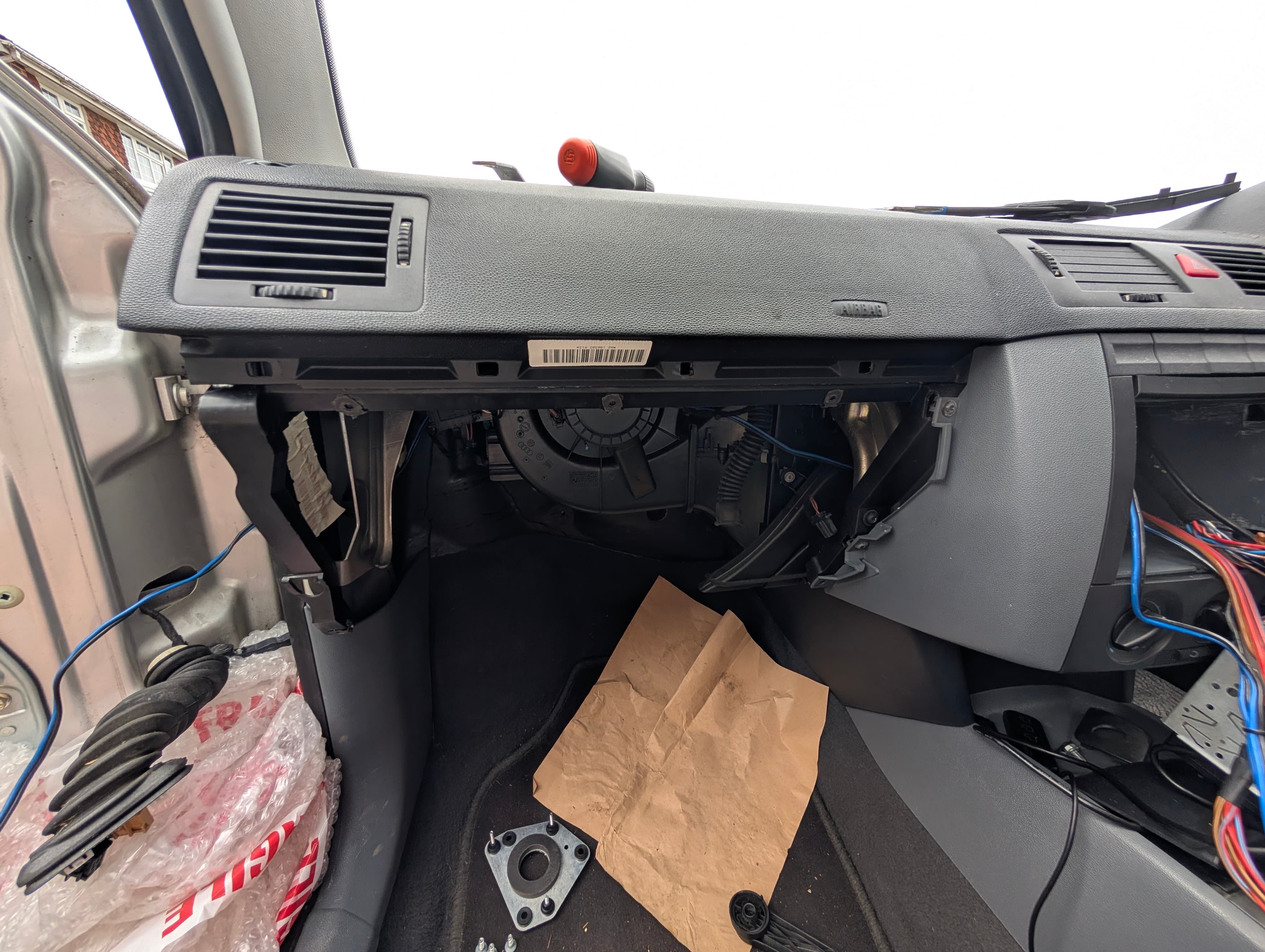

As for the surprises... I did need to take out the whole glove box in order to remove the cables. They had been quite liberally zip-tied to the existing car's wiring, so I had to snip those to remove it all. It also gave me a fantastic opportunity to re-route my Android Auto head unit's USB cable properly, as well as tidy up its microphone wiring. Overall, it was looking much cleaner after this!

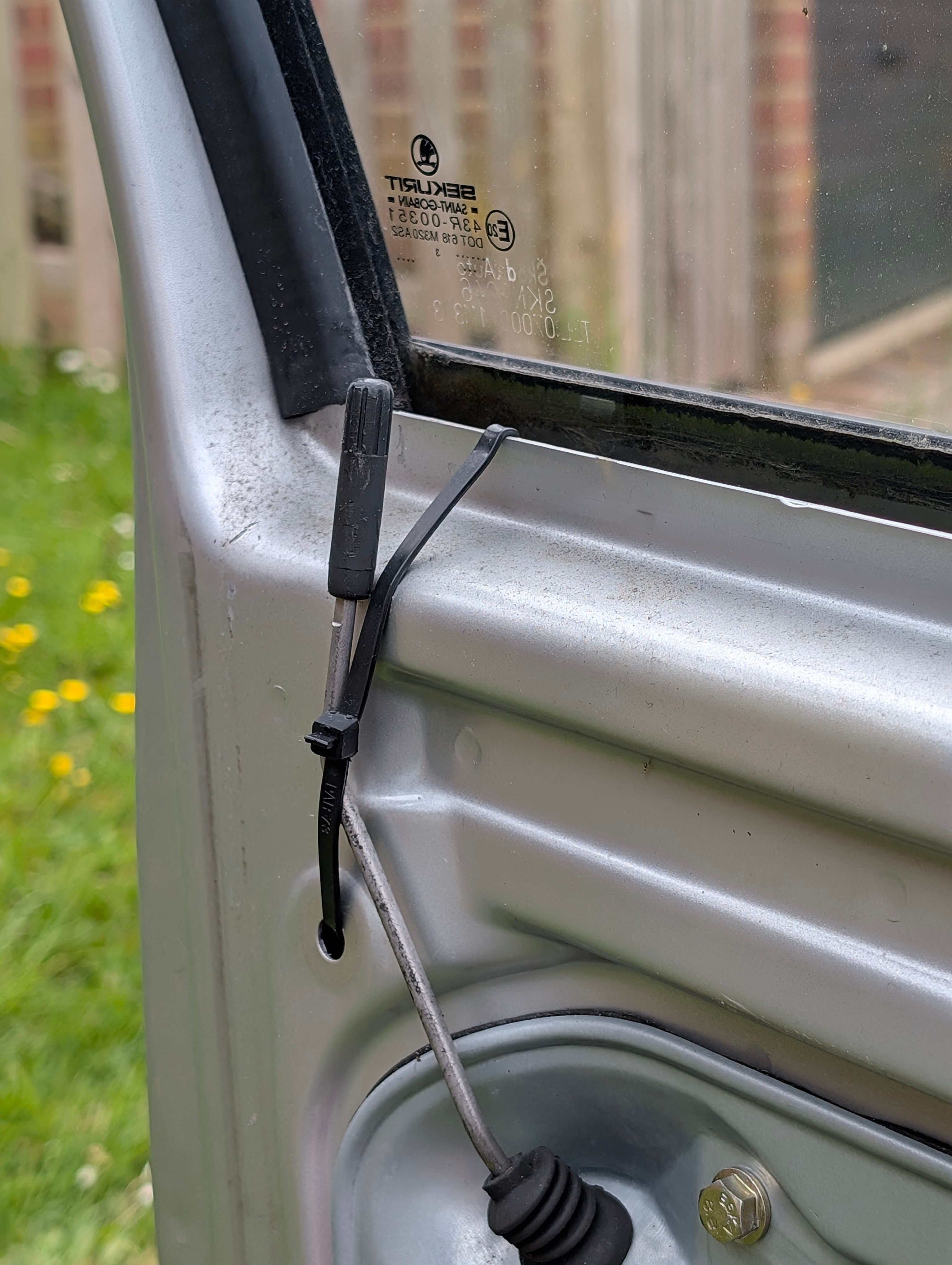

You might have also noticed the zip tie on the locking peg thing on the door. This wasn't me! Someone in the past had, seemingly, broken or disconnected the linkage which connects that to the lock, and in order to not make it fall down inside the door, decided to zip tie it to hold it in place. It does, surprisingly, still work, but doesn't pop up properly when unlocked. You can shove the car key down the hole and push it down to lock it. Not a big deal, but something I should look at in the future (if I care enough). I have absolutely no idea when this happened, though.
