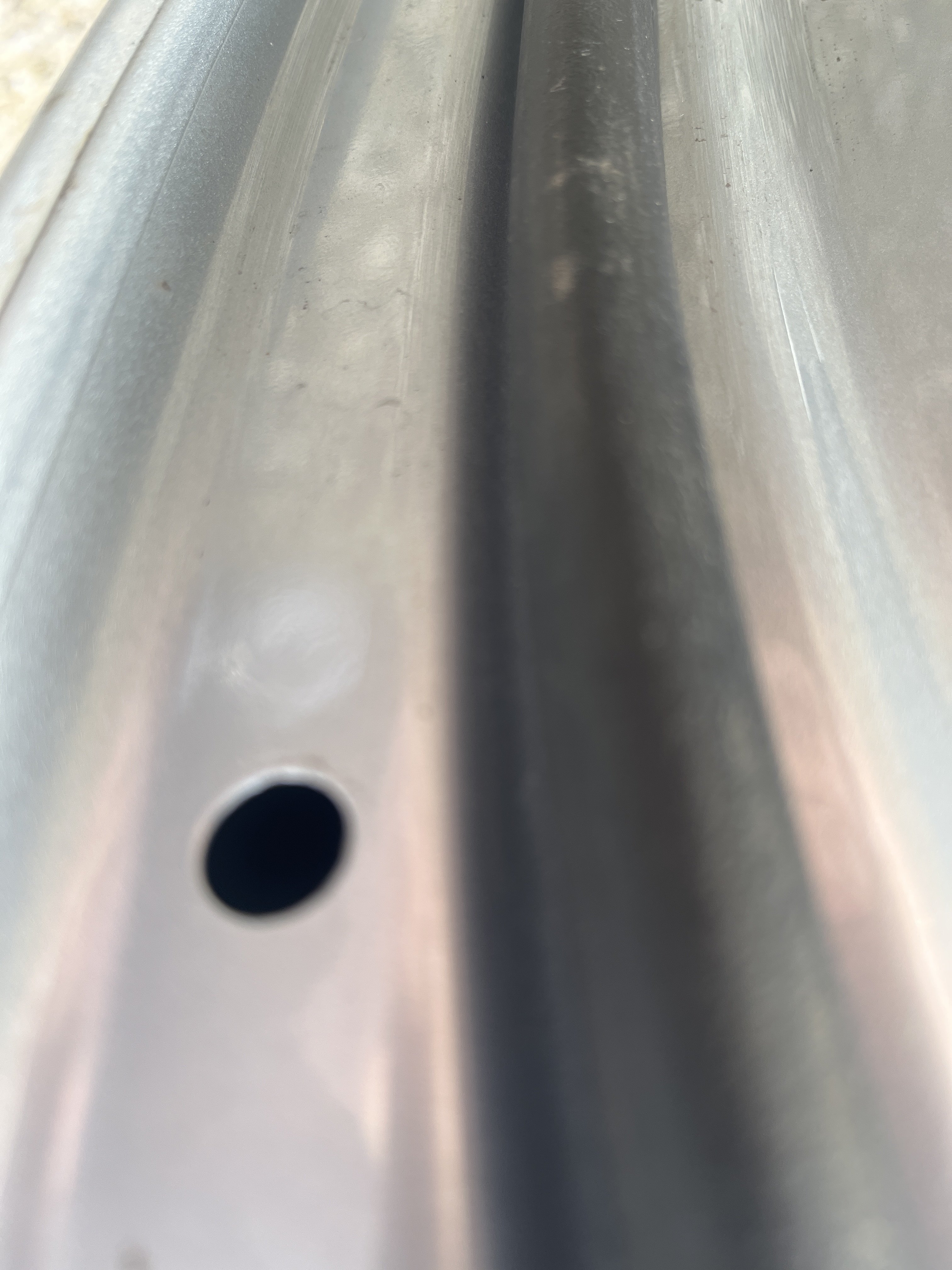

  2. as its the rear door, only got a single access hole on the door. Cant see anything inside as flashlight is useless in the small hole. So everything is feel Only. How long should the hook removal tool be and does it slide into hole in the back of the handle (which you cant see).
  3. Thank you my friend, I will Give this a go👍🏻
  4. Hi, Looking for some assistance, anyone know how to remove a rear door handle from a 2018 mk3 Skoda Superb? Lots of conflicting info on the net, some saying removal is a hook others a T20 torx screws. Many thanks
