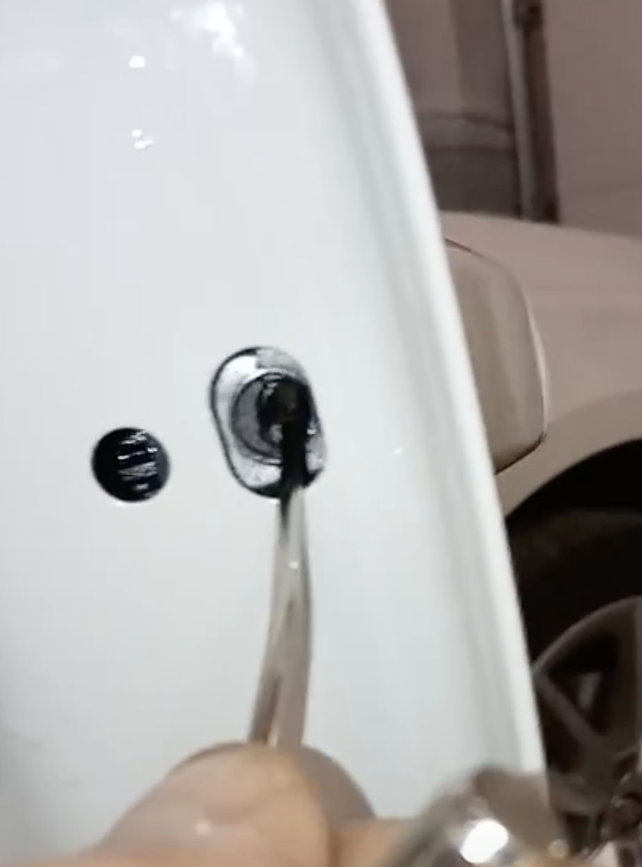

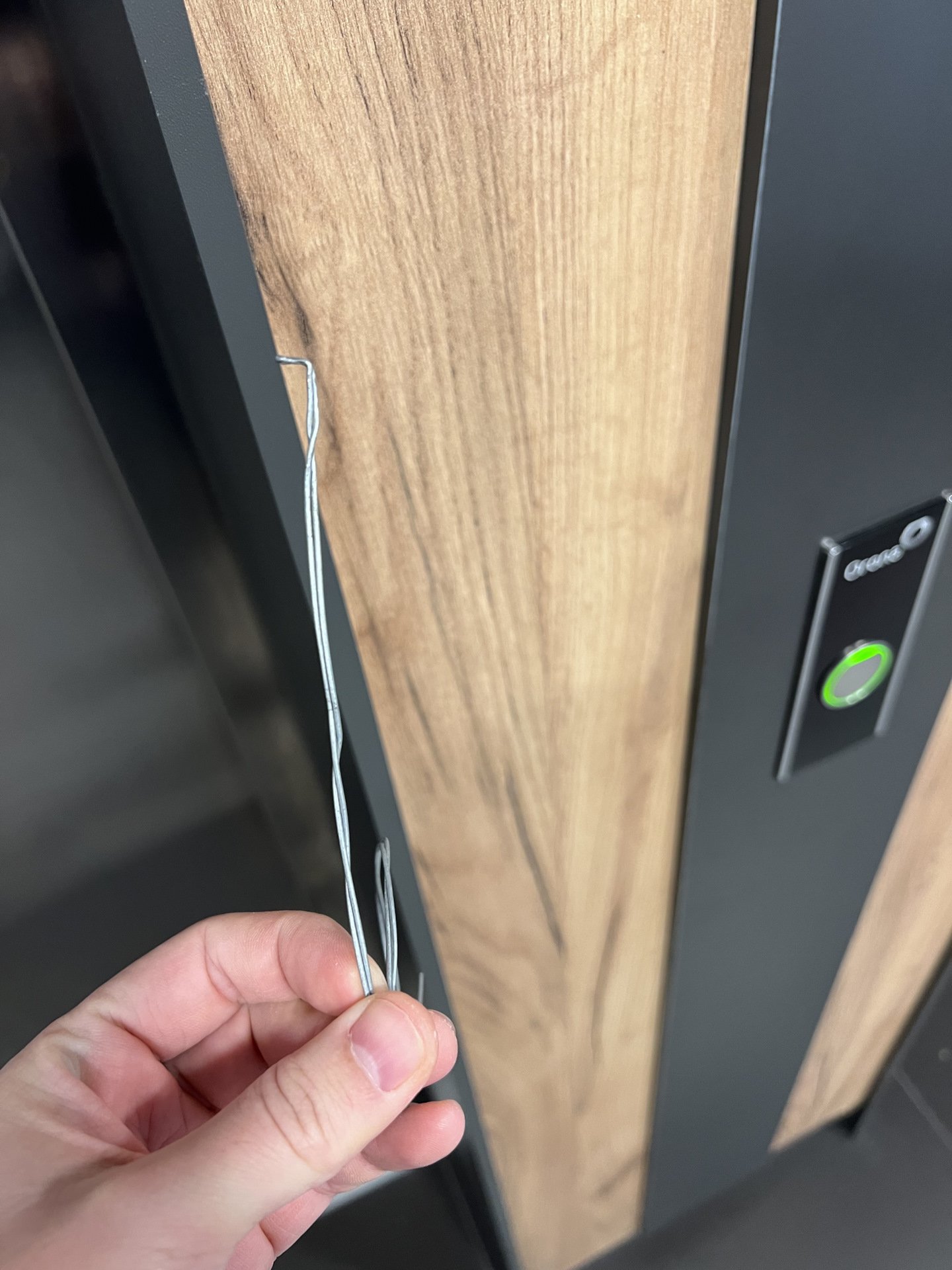

I used a homemade hook made of wire. You need to pull the latch; if you shine a flashlight, you'll see it.

as its the rear door, only got a single access hole on the door. Cant see anything inside as flashlight is useless in the small hole. So everything is feel Only. How long should the hook removal tool be and does it slide into hole in the back of the handle (which you cant see).
3 hours ago, Tamas530 said:
Got it, end of hook was too long. Thanks
