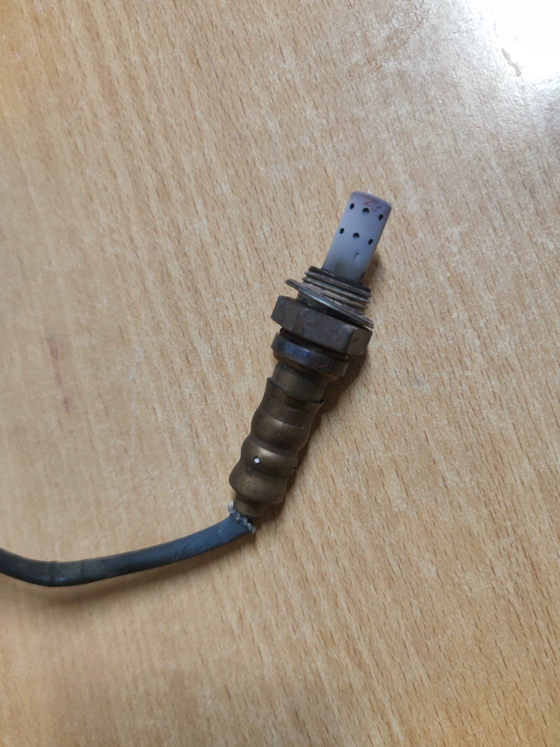

Hello again, I had removed and cleaned the sensor, but unfortunately, the warning light came on again today. So, I’m considering buying and installing a new oxygen sensor. My question is: can I do this on my own? When I look at the product images, I notice the cables and socket assembly. Do I need to assemble these myself? Thank you for your guidance.

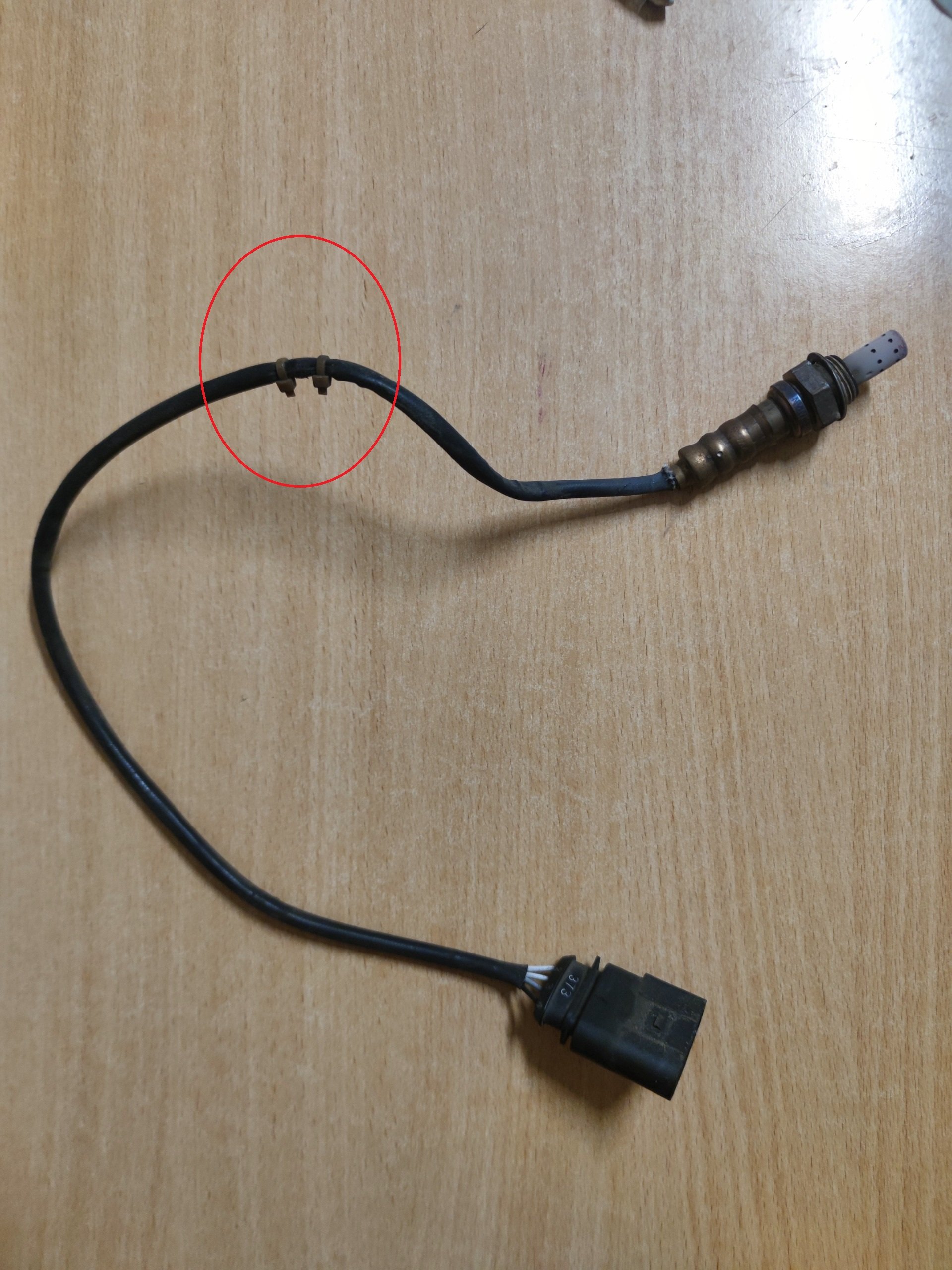

@Breezy_Pete No, there didn’t seem to be any visible issue. I just noticed that it felt a bit damp. In the new photo I shared, two clamps are holding the cable tightly at the marked section. I couldn’t understand why they are there.

Hello, I just had the chance to remove the oxygen sensor. Upon inspection, there doesn't seem to be any issue with the wires. I've attached the pictures as well. The head of the oxygen sensor was dusty.

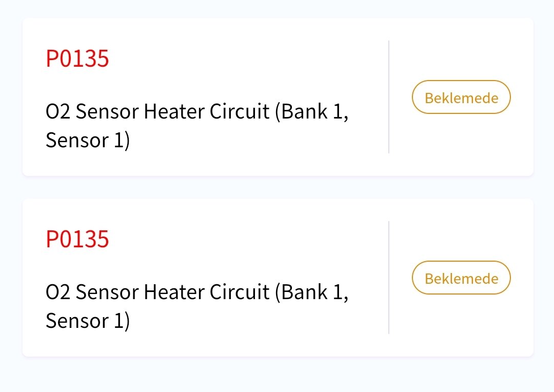

I want to solve this problem myself, but I don't know which sensor on the car I should look at and in what exact location for this error code.

Thank you for the detailed explanation, @Breezy_Pete Yes, I’ve been experiencing an issue where the check engine light flashes intermittently. When I checked with an OBD device, it indicated an oxygen sensor fault. The reason I'm considering cleaning the sensors is that the check engine light comes on for a few days, then turns off for about a week, and then comes back on again. This pattern makes me think the issue could be related to a dirty sensor rather than a completely faulty one. Would you recommend cleaning the sensors, or do you think replacing them directly would be a better solution? Any advice would be appreciated!
