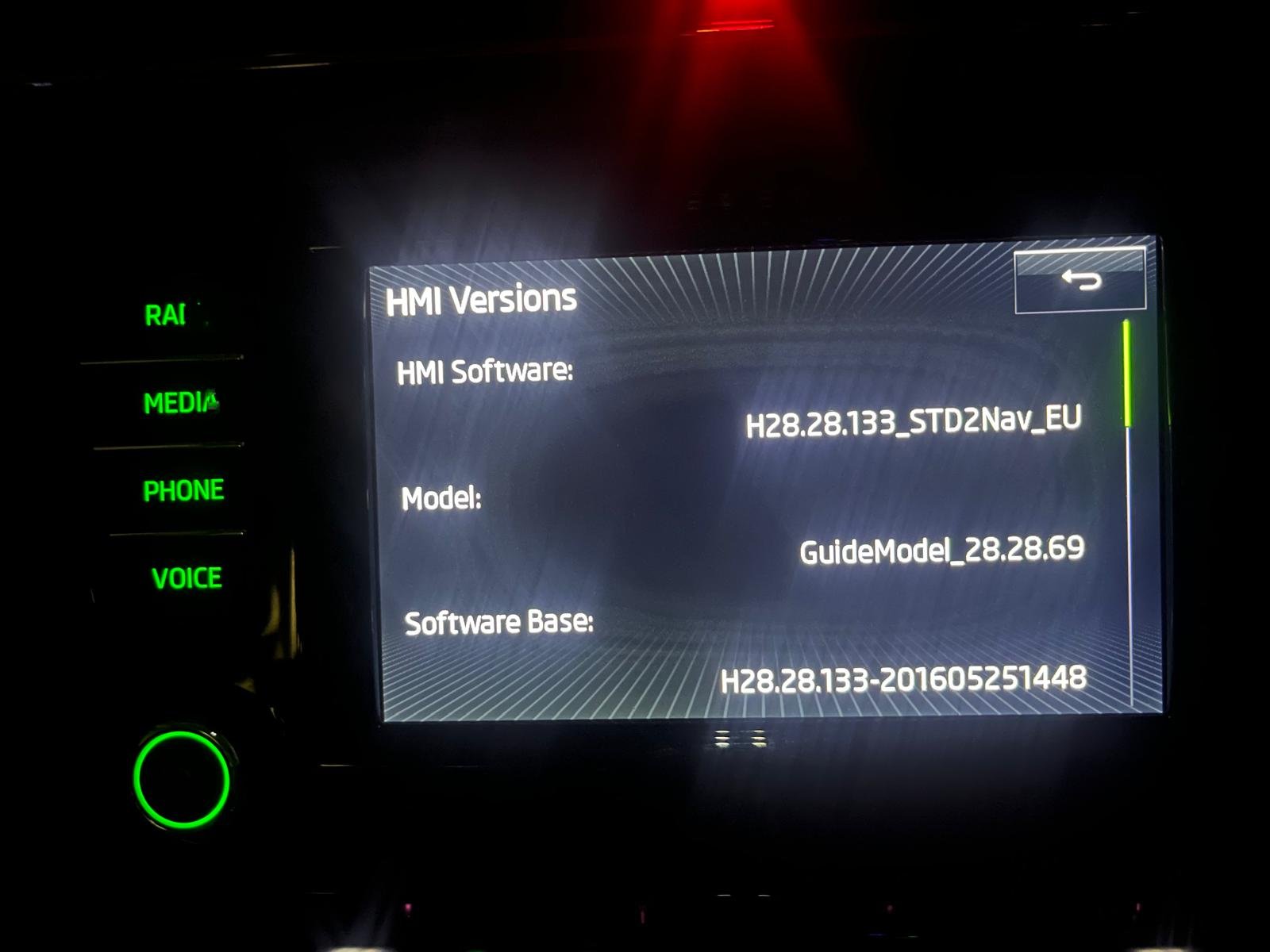

  2. Hi, thanks for that tip! here is the image:
  3. Hey, that just popped up on my car as well (after a service!) ? I didnt change anything ... no Idea why it happened, normally it attomatically populates the track list. Also need help with this.

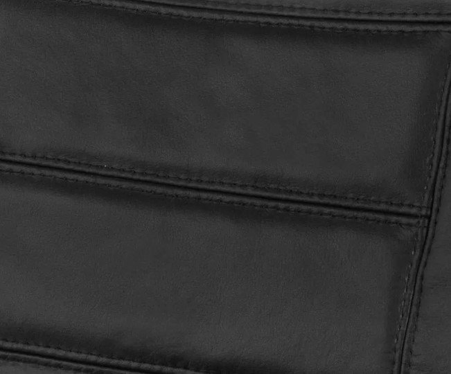

  4. It fits ok, a bit loose no where near as tight as shown in the ad photo as its hard to attach the elastic loops properly, I can slide on the seat now which is what I wanted as before my clothes got stuck and pulled up on the alcantara. I also find the skin feel/ temprature better on the leather. The downside is that I can also feel the thick seams where the leather sections are sewn together pushing into my back which is rather uncomfortable! I'm going to give it some time but I might end up taking it off again (perhaps I can find a cheap leather seat from a superb that fits and change the whole seat? (stick the old one in the loft and put it back if I ever sell the car?) I know drivers seat not most important thing to most but it's a crucial aspect of the car to me!
  5. Found an image of the one I used : hope it's ok... seems good so far to me.
  6. I just bought this https://www.walser-shop.co.uk/car-seat-covers/real-leather/billy-black/ for scout III (cheaper on Amazon) as I find the alcantara rather uncomfortable personally (also protects dirvers seat for future) . Will let you know if it fits ok...

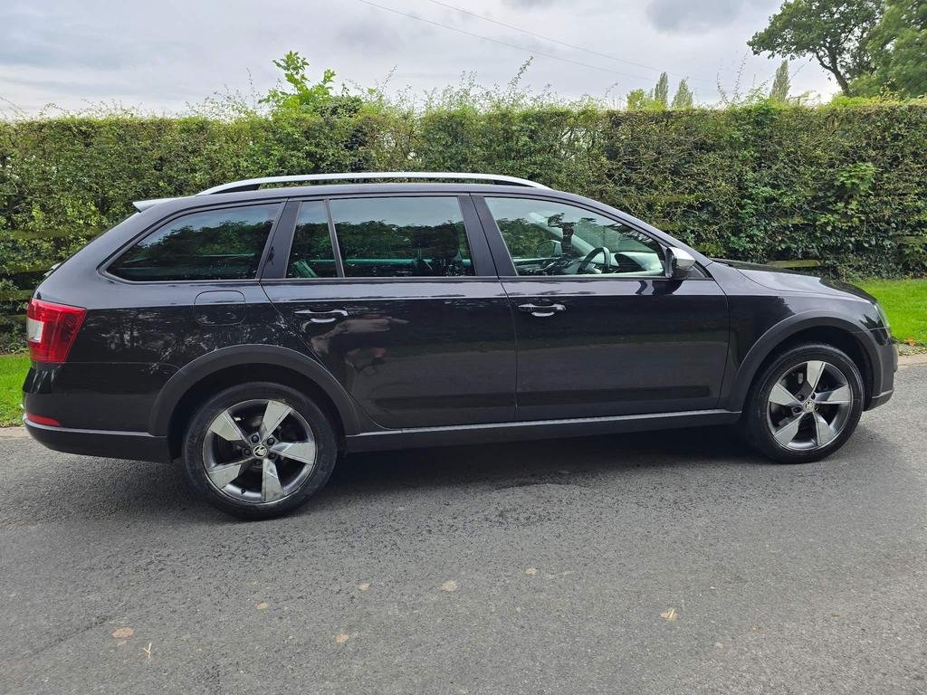

  10. Hello all, I'm considering buying a second hand Octavia (III) Scout 184HP (80K) (cat s) (with fresh MOT PASS) and was wondering if there were any things in particular you would look out for? curently I have this list: service History: cam belt replacement, water punp replacement, haldex (V) service (inc. filter)x 2, dsg service x 2 test drive: does AWD work properly (on rear wheels), emergency stop - any vibrations in the frame/ steering, any pull left or right hood: cheese under the oil filler cap (water ingress), check dipstick, interior: is reversible rubber mat there, is parcel shelf included, have air bags been replaced, head unit connection working exterior: locking wheel nut included, pannel gaps Thanks very much, Aidey
