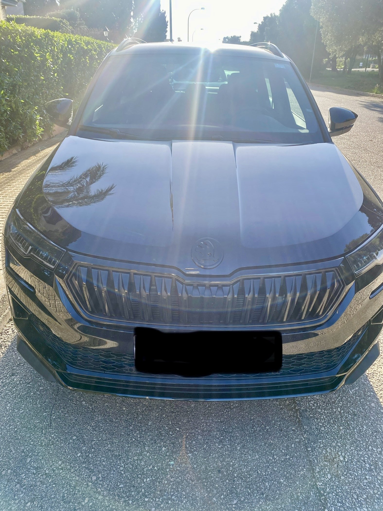

  2. Yeah and no! I used a hairdryer for about 8 mins and the some floss. it needed some jimmering with a flat head screwdriver too 🤦‍♂️ (nervous part) so I protected the paint with a towel and masking tape. left some residue behind that I scraped and rubbed off most of it with my fingers. After that dead easy. 😮‍💨 good luck 😉
  3. Swint replied to Cvak's topic in Skoda Karoq

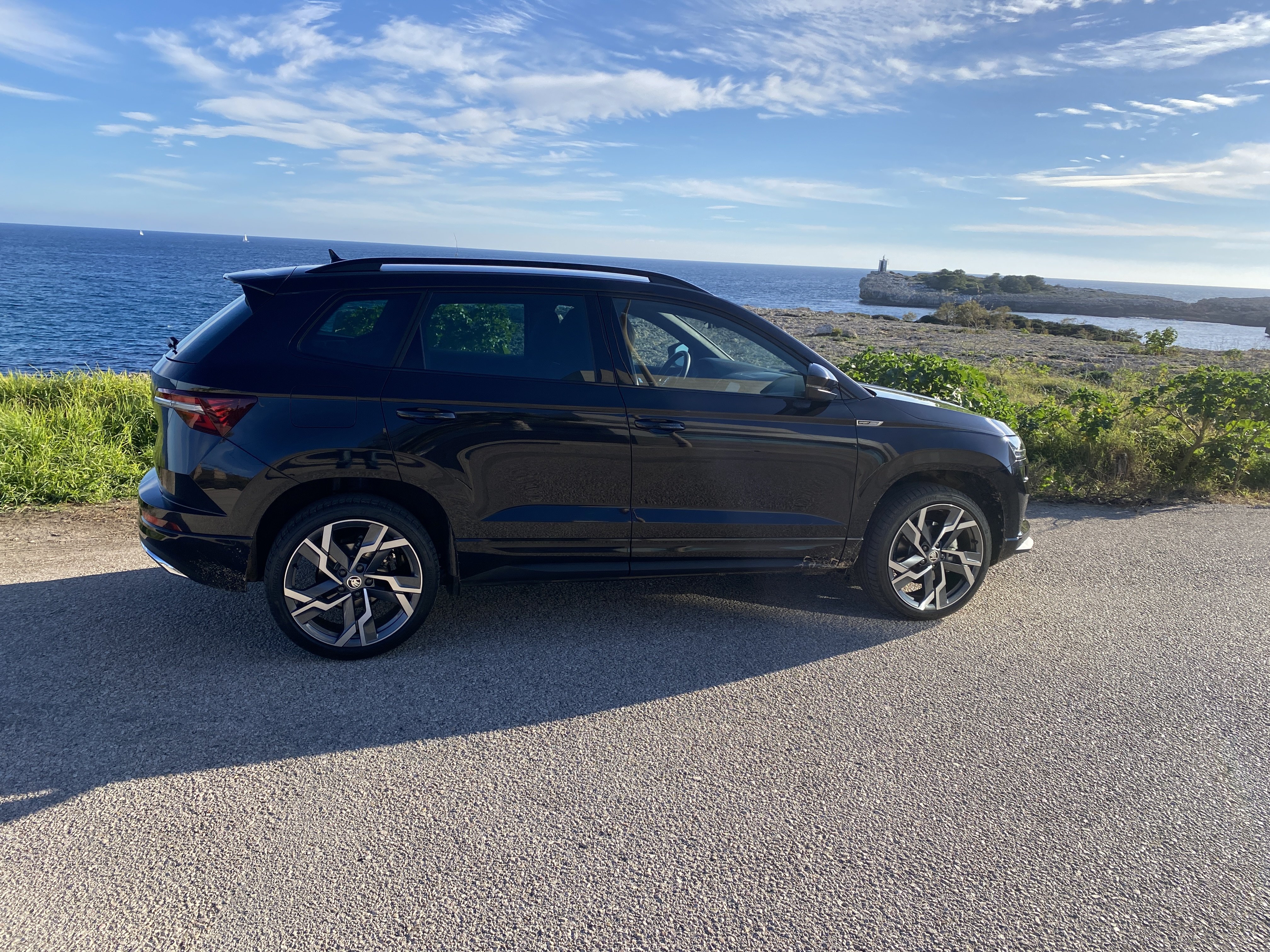

    Had my beauty for 2 weeks now and so far I’m a happy chappie What’s peoples opinions about the the ‘rubber band tyres’ and alloys’ Any suggestions will be grateful
  4. Very good information indeed changed my badge too 👍🏼
  5. Ok (please. Don’t take this post as gospel) After looking at several YT videos You have to order the badge with the 3 Tabs on the back to align the badge correctly. iskng a heat gun, heat the badge so the adhesive becomes malleable and use dental floss to in and around the badge to pry the badge away. hopefully not to much sticky residue is left. clear away that gunk (video I watched the guy uses a rubber disk on a grinder/polisher to remove the glue) why am I telling you this? Here’s the video!
