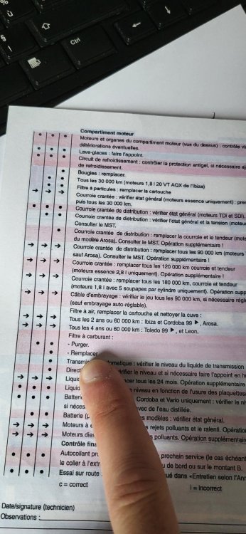

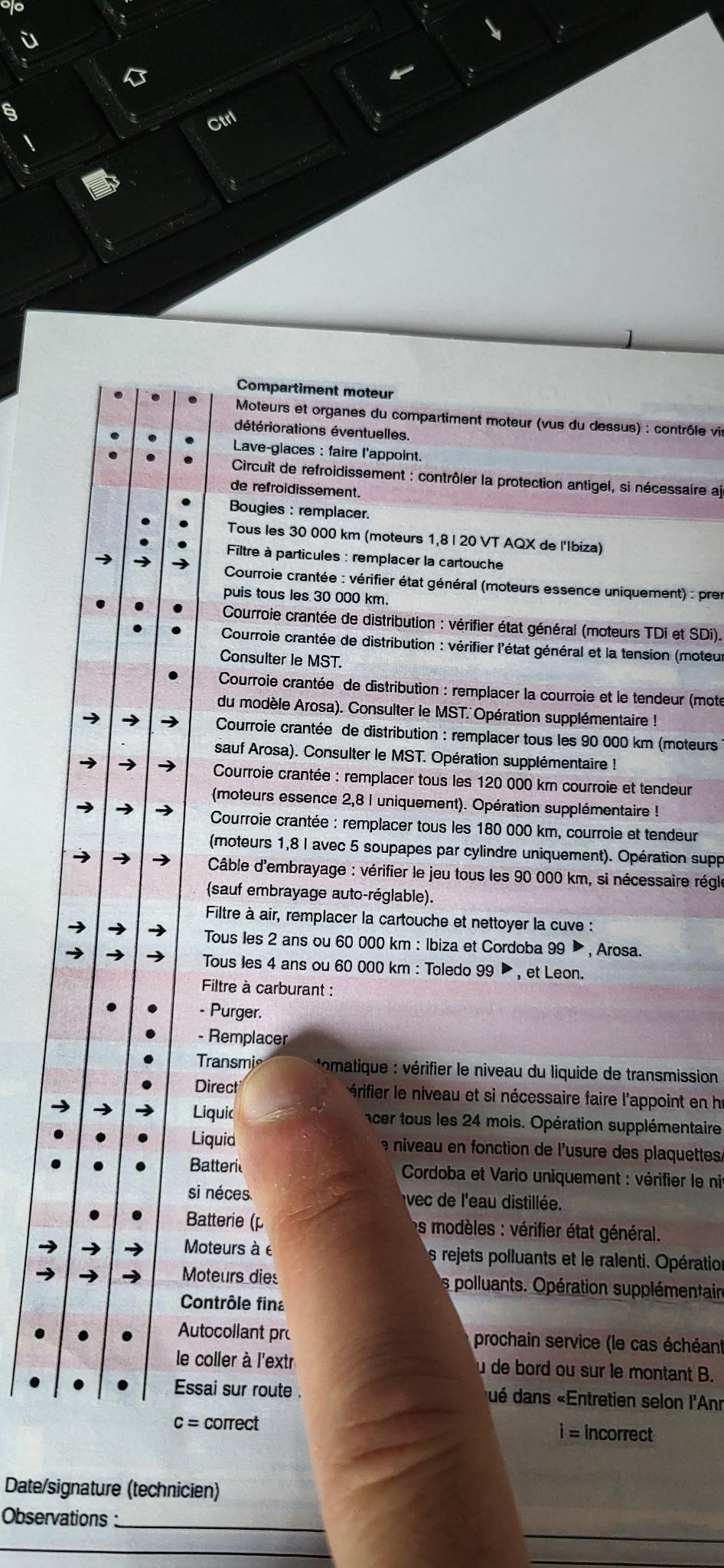

Hi Team, Indeed I had seen this video already and bought the correct part number. I also saw some VW Up! (therefore Citygo) where this filter is clearly accessible. Have done it several times on my former Ibiza II 1.4 MPI (quite similar to the video) and a very old BMW 316 in the past (those were very small and in the engine compartment) However, this is the theory ... but when the car was lifted up, the sad reality did not match at all !! I opened a case at Skoda France asking for more details. The person indicated that I should suscribe to Erwin Official platform for more information but this fuel filter no longer needs to be changed in the current maintenance program ...

Hi All, Thanks for your answers. Indeed, I saw on YouTube people with the very same engine, 1.0 MPI / 60 hp / code CHYE, changing it in a VW Up! On my Fabia, I could not locate it at all. I bought one from the part catalog because I wanted to change it, as every time I buy a second hand car, I like to give it a deep full maintenance. If it is integrated in the full pump, I won't dare to access it ...
