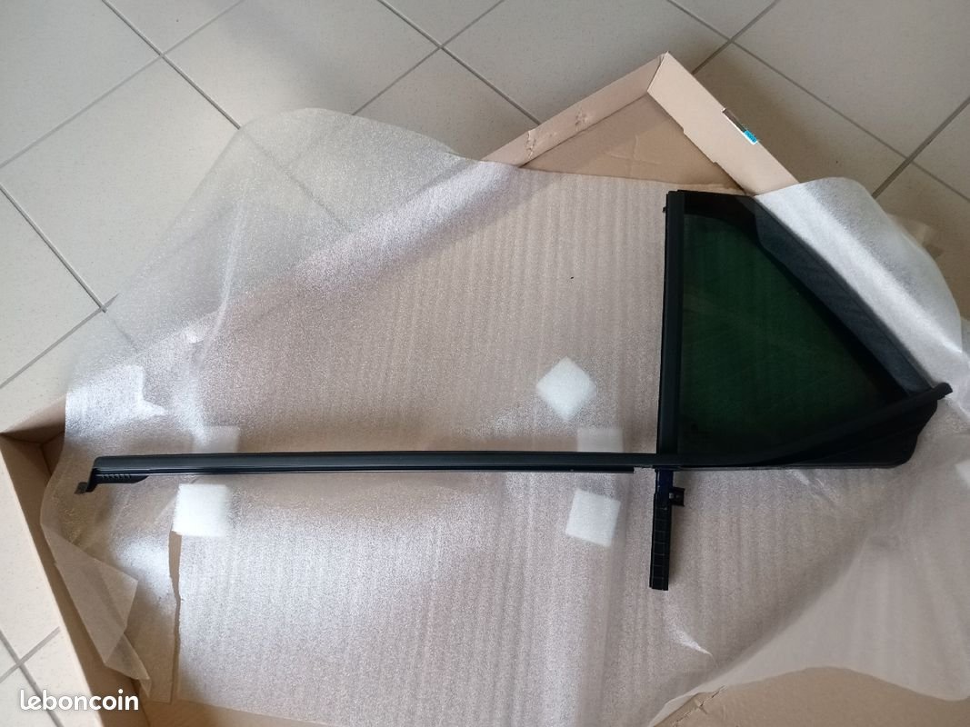

Quarter window replacement
Eventually seems not super difficult : I found this on YouTube : Therefore I understand I just need to : 1./ open the rear window 2./ remove my manual door crank 3./ open a bit the top of the inside door panel 4./ remove the horizontal bar 5./ replace the quarter window 6./ do the same operations in an opposite way 4. 3. 2. 1.
Hi there, Has one of you ever replaced the rear door's quarter window ? If so, did you have to remove the internal door panel ? Thanks.
