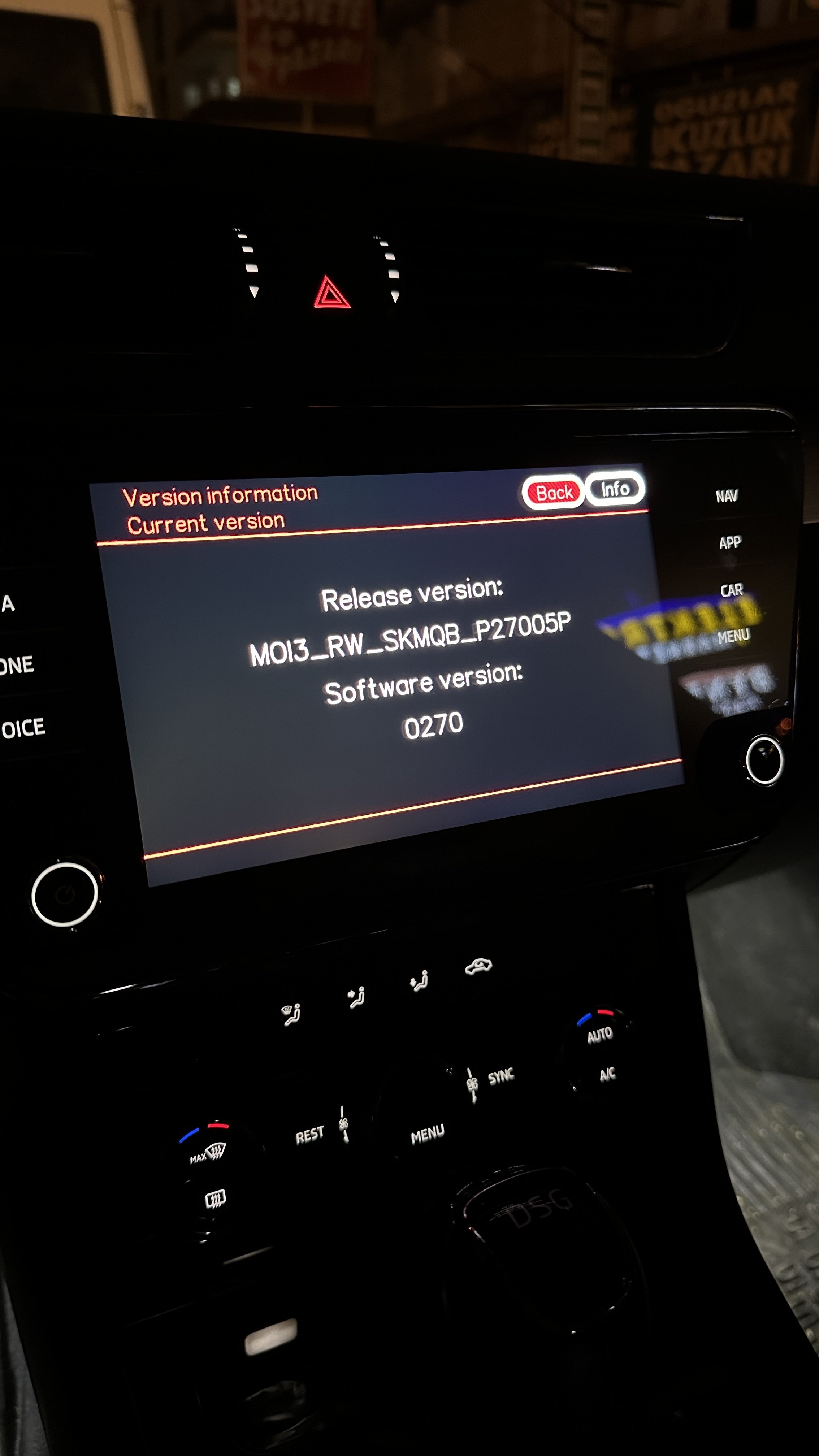

  10. hi everybody. mibsolution website update files are faulty (330).I recently updated it 0270,308,330..I applied navigation patch after 330(with vcrn code).I didn't have any problems.If the hidden feature is active in your vehicle before updating, you need to restore it (video motion,radio AM enable..).I will share the new update link and details below. 308 and 330 update file (only RW not EU) https://www.drive2.ru/l/695736324514133028/ The procedure is as follows: 1) Reinstallation of 332 software 2) Checking the full.bin file (exactly the VCRN has changed) 3) Disabling functions: — MirrorLink disabling speed threshold in motion (MIB3): 0 — Wi-Fi 2.4 GHz Hotspot (MIB3) [U:5F][$0519]: Disabled — MIB3: Ethernet configuration channel 4 [U:5F] [$09D3]: Disabled — Applink: Mirrorlink [MIB3] [U:5F][$0555]: Disabled — Activate the developer mode in the multimedia system [U:5F][$243F]: Disabled functions (do not forget about the manual, open hood) with GU overload. 4) Patch reinstallation
  11. So where can I find the RW software?
  12. hi friend my car mib versıyon M013_RW 270. eu files 0330 can be uploaded? (M013_EU_.. ) .Is there a Turkish language option? Will there be a problem in my country?
