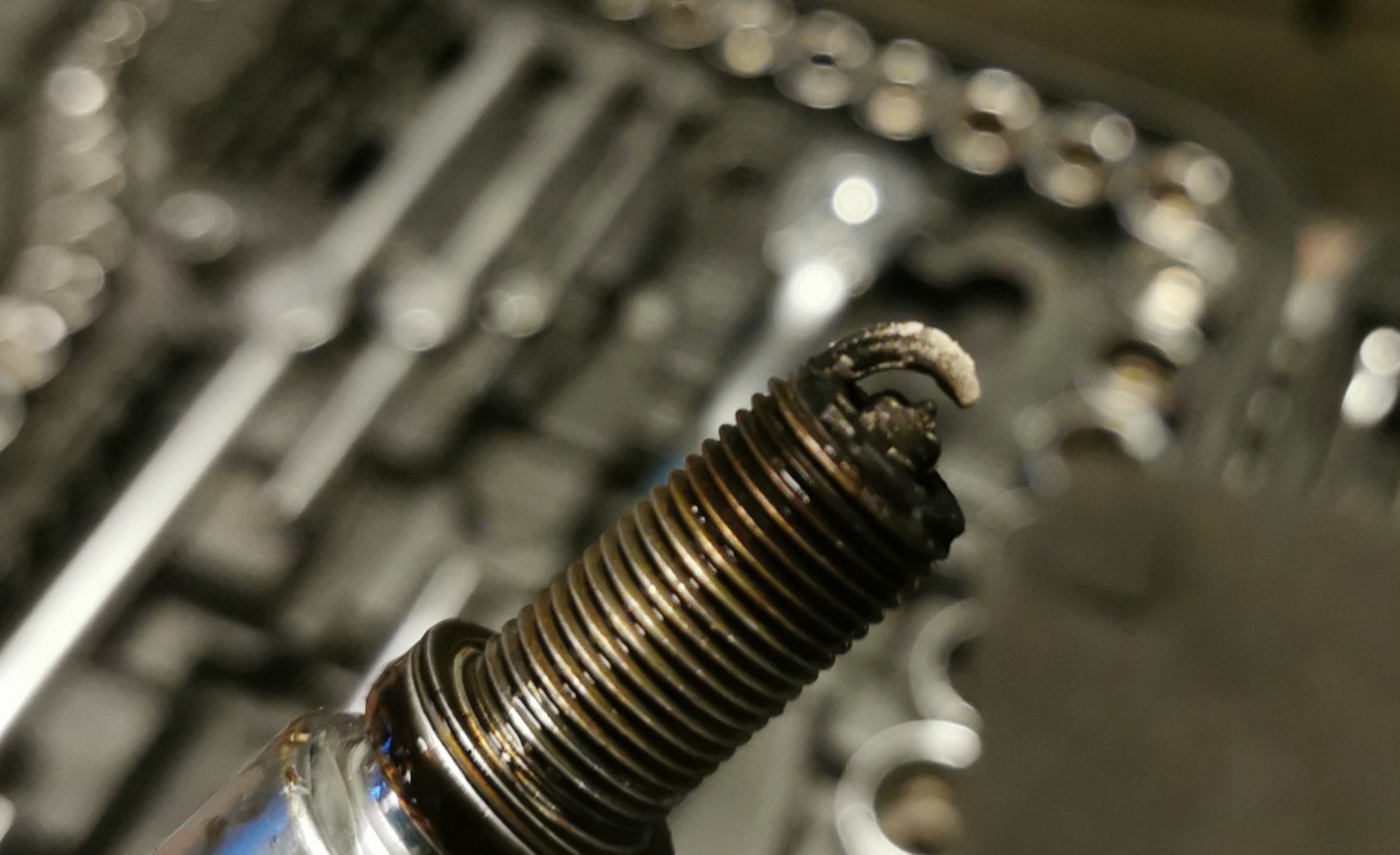

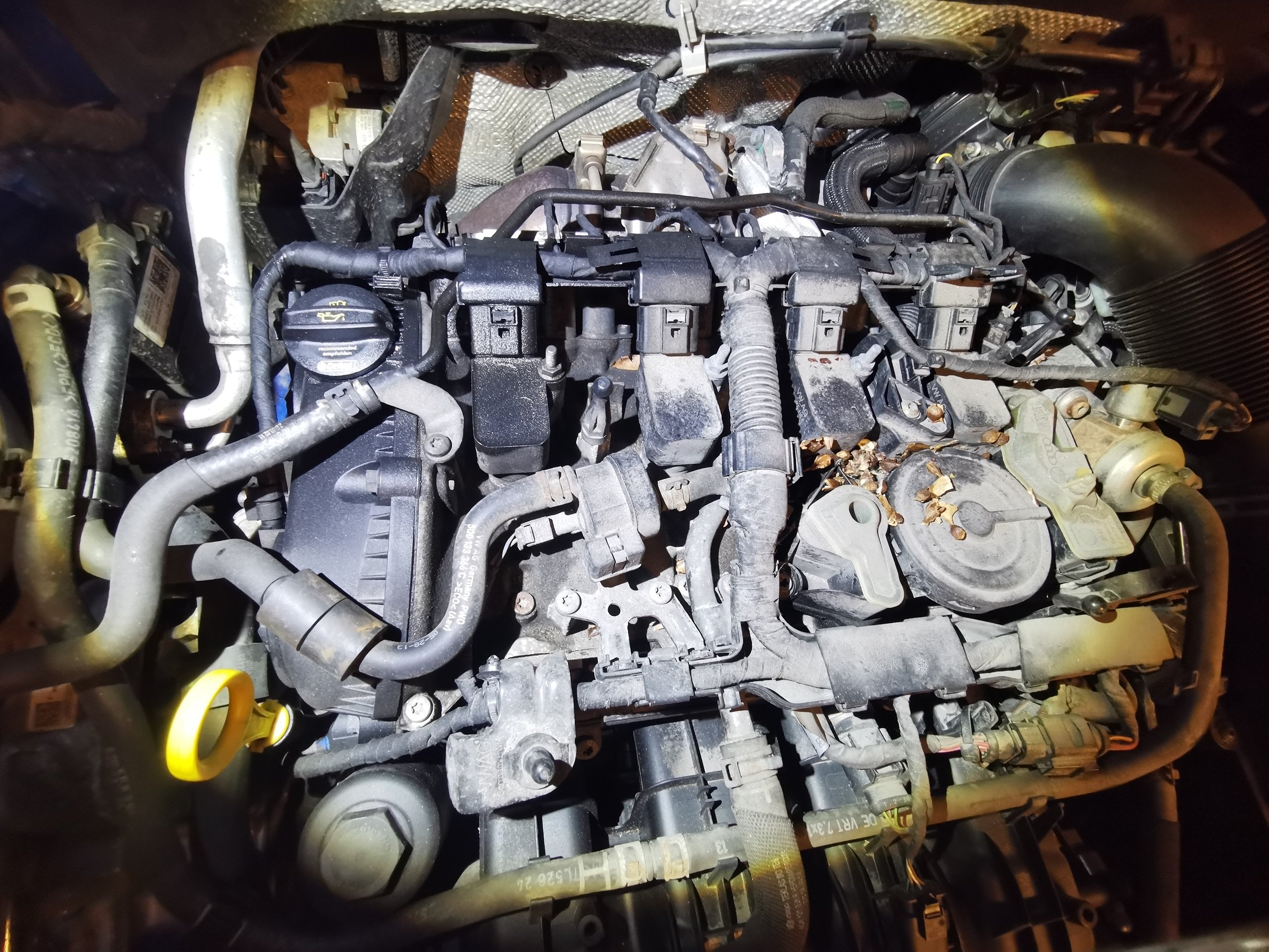

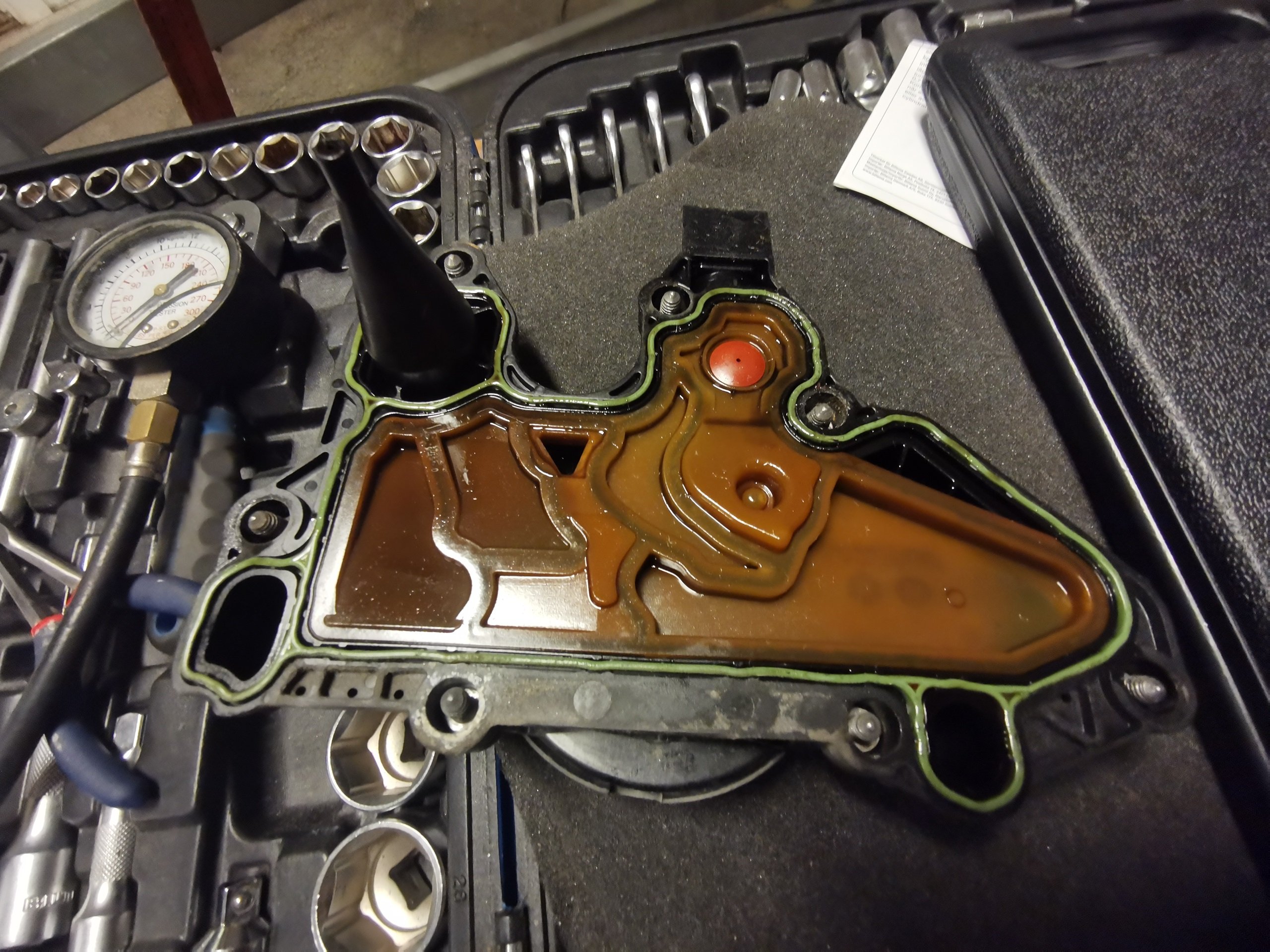

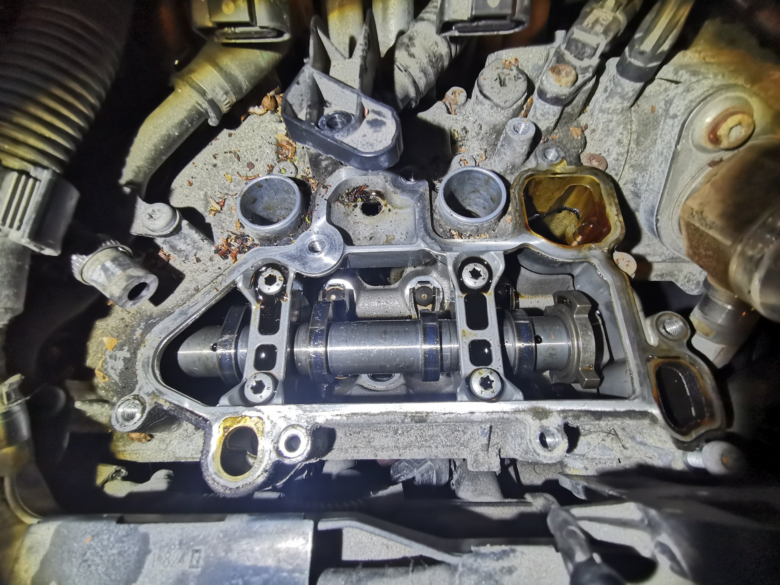

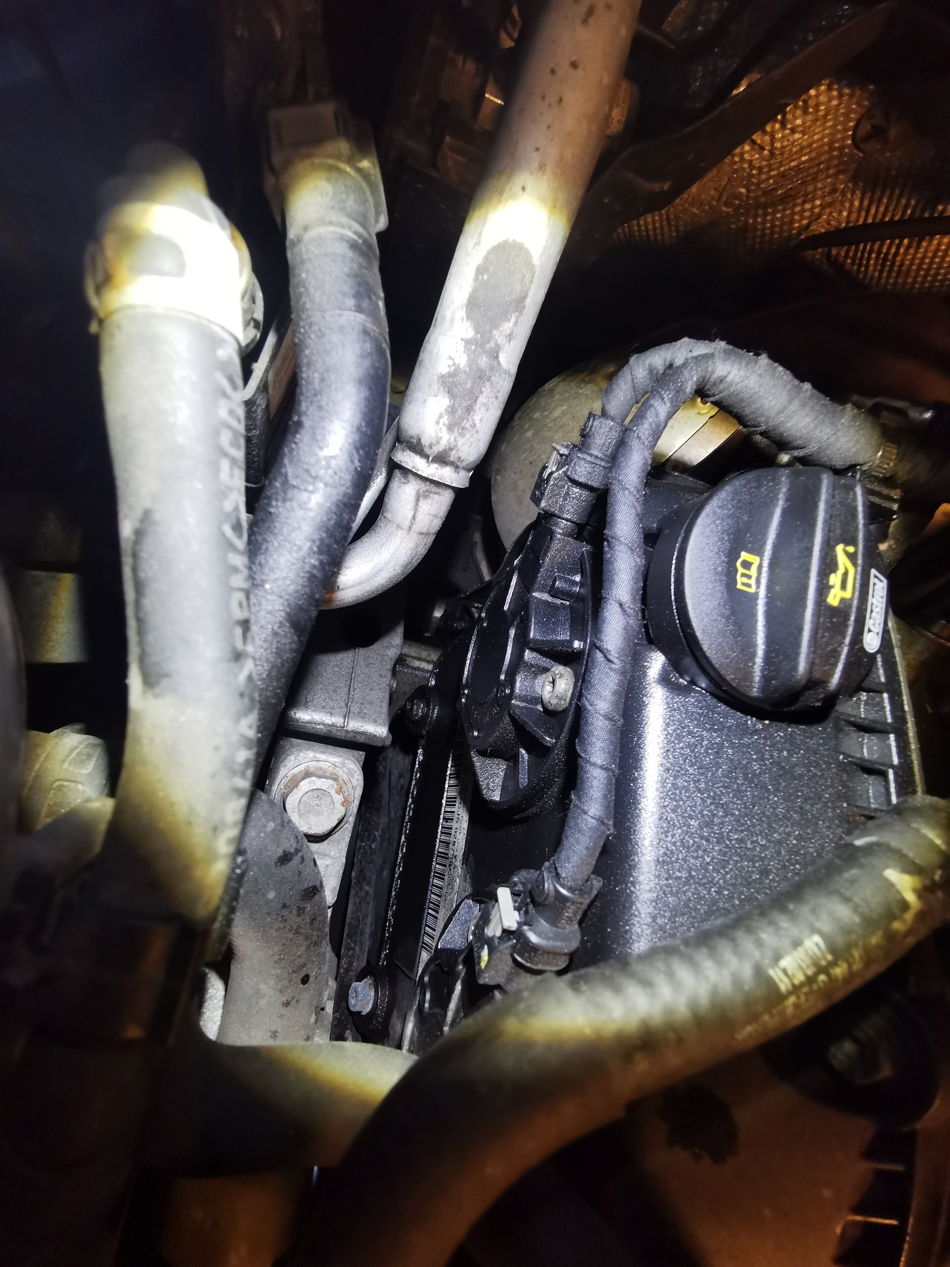

Hi 1. I did a check on the PCV valve but not sure how to tell if its bad or not. Its locks clean and when i blowed into the little "funnel" it was not blocked. 2. Then i did the compression test. Engine was up to temp dry. 1. 12,5 ---- 2. 12.5-----3. 11.5 -----4. 12 Bar Wet. 1.14.5 ------2.14--------3. 14.-------4. 14 Bar But it locks like i have some sort of oil leak close to the filler cap. Its oil residue on coil 1, around filler cap and down the side off the engine. Maybe is a leak under the side plastic cover that hold the filler cap. The coolant is also clean, no oil.
