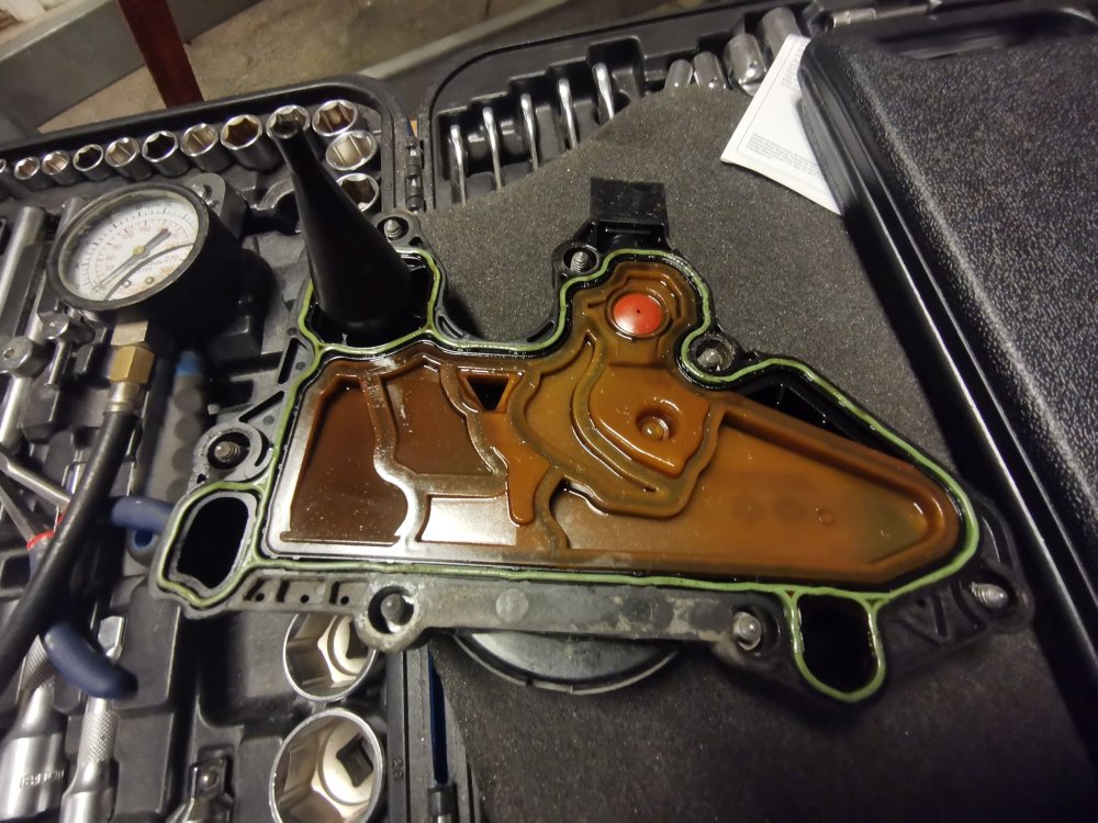

1. I did a check on the PCV valve but not sure how to tell if its bad or not. Its locks clean and when i blowed into the little "funnel" it was not blocked.

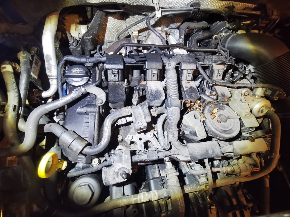

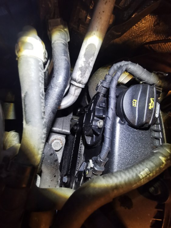

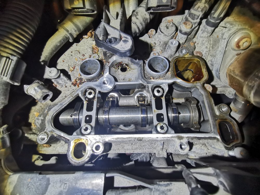

But it locks like i have some sort of oil leak close to the filler cap. Its oil residue on coil 1, around filler cap and down the side off the engine. Maybe is a leak under the side plastic cover that hold the filler cap.
The coolant is also clean, no oil.
Edited by mlimseth

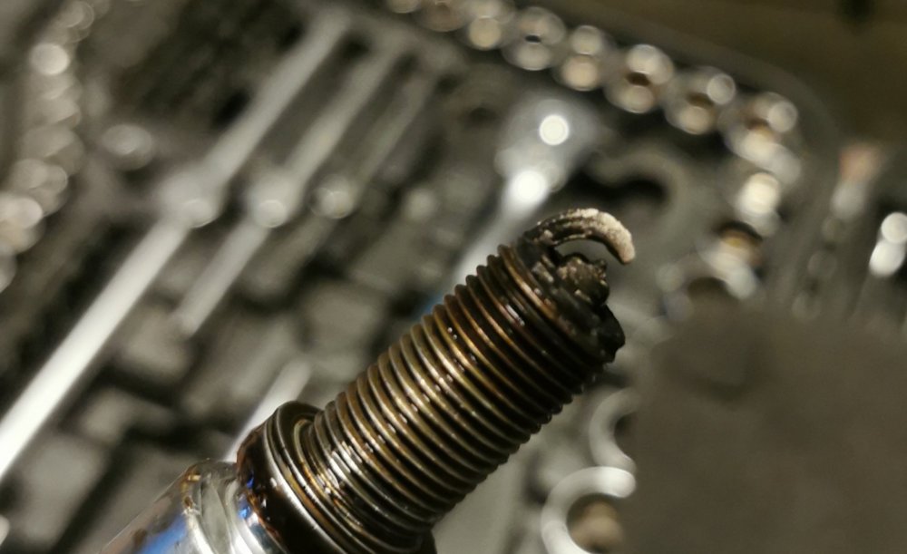

Compression test seems pretty even. Not sure what it should be but they all are pretty near equal. Your engine seems from the photos pretty clean. As your losing/using so much I would expect a leak that is causing the problem to be pretty noticeable. I was thinking that it might be valve stems seals if not the piston rings. The plug looks pretty oily and worn. You could try a leak down test. Have seen cheap ones online.
Alasdair
The plug shows that a lot of oil is burned. Most probably the oil rings are clogged and stuck.
