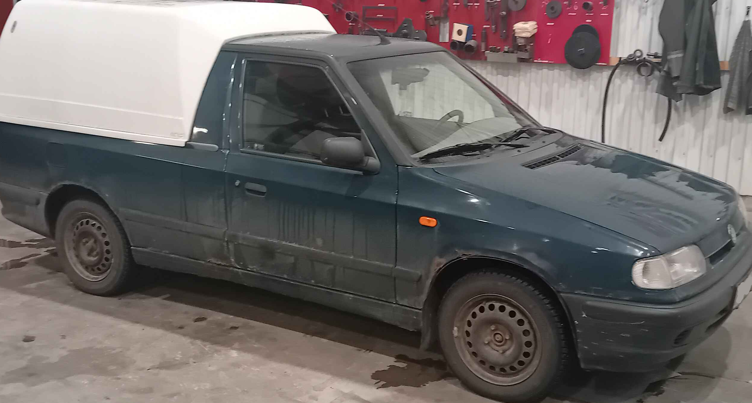

Hello! I recently bought a Skoda Pickup 1.3 MPi. Not the best condition but seems to be mechanically in quite good condition!
