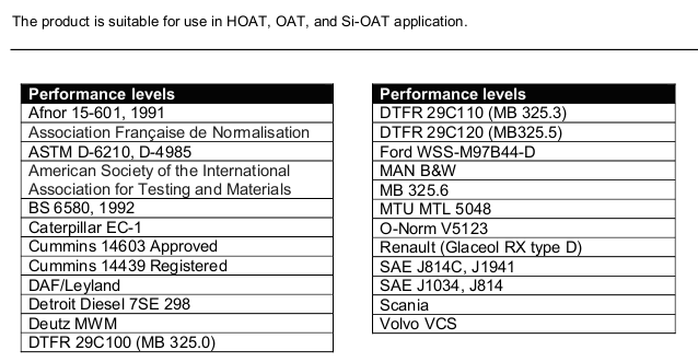

You have G11 or G12?
G-wotever, the Germans with their unnecessary additional specifications for coolants and engine oil (on top of the VW numbers), I think they might have changed the numbers and specifications sometimes to help with the engineering compromises and mistakes with their engines and gearboxes since the start of this century.
Only the other day I added a line to one of the VW coolant charts, check the notes at the bottom.  It's not great but it was a first attempt as I can't remember where I got this chart from.
