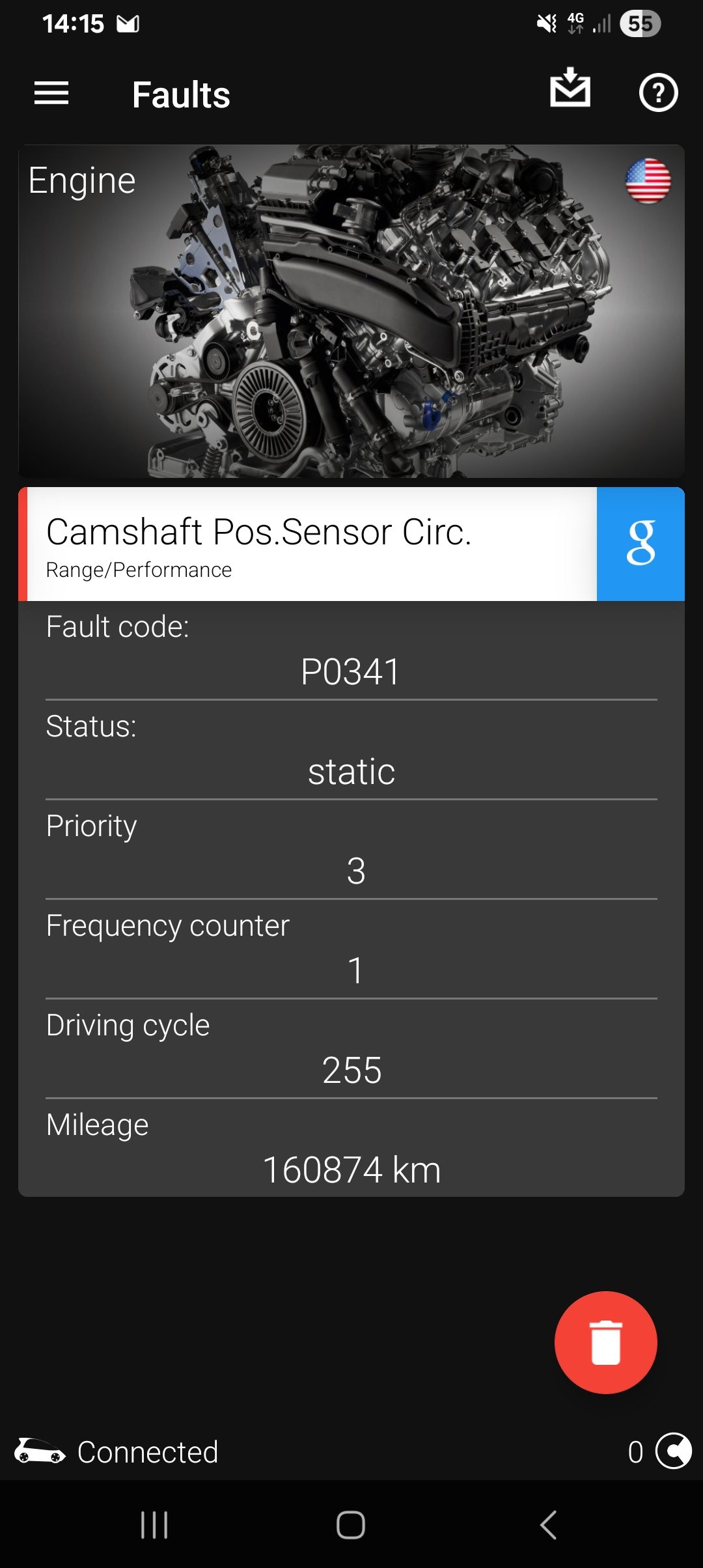

Recently had an issue with a flat spot under 2,400rpm feels like no turbo boost, a fault cam speed sensor replaced, the error code went away, then it came back with P0341 so it wasn't the sensor faulty. I have looked at the turbo, injections, MAF and vacuum pipes, all are fine. I had to look at the timing belt, because recently I changed the timing last December. Unfortunately I have found that the timing is moved one tooth back, not forward, the tension mark is a bit over the line. I read that it's quite common for weak tension on the BKD engine, mine is a 2.0 TDI 140bhp PD. Does anyone have this issue before? I bought another tension, I hope is better stock INA cambelt tensioner the previous cambelt kit was call Firstline.

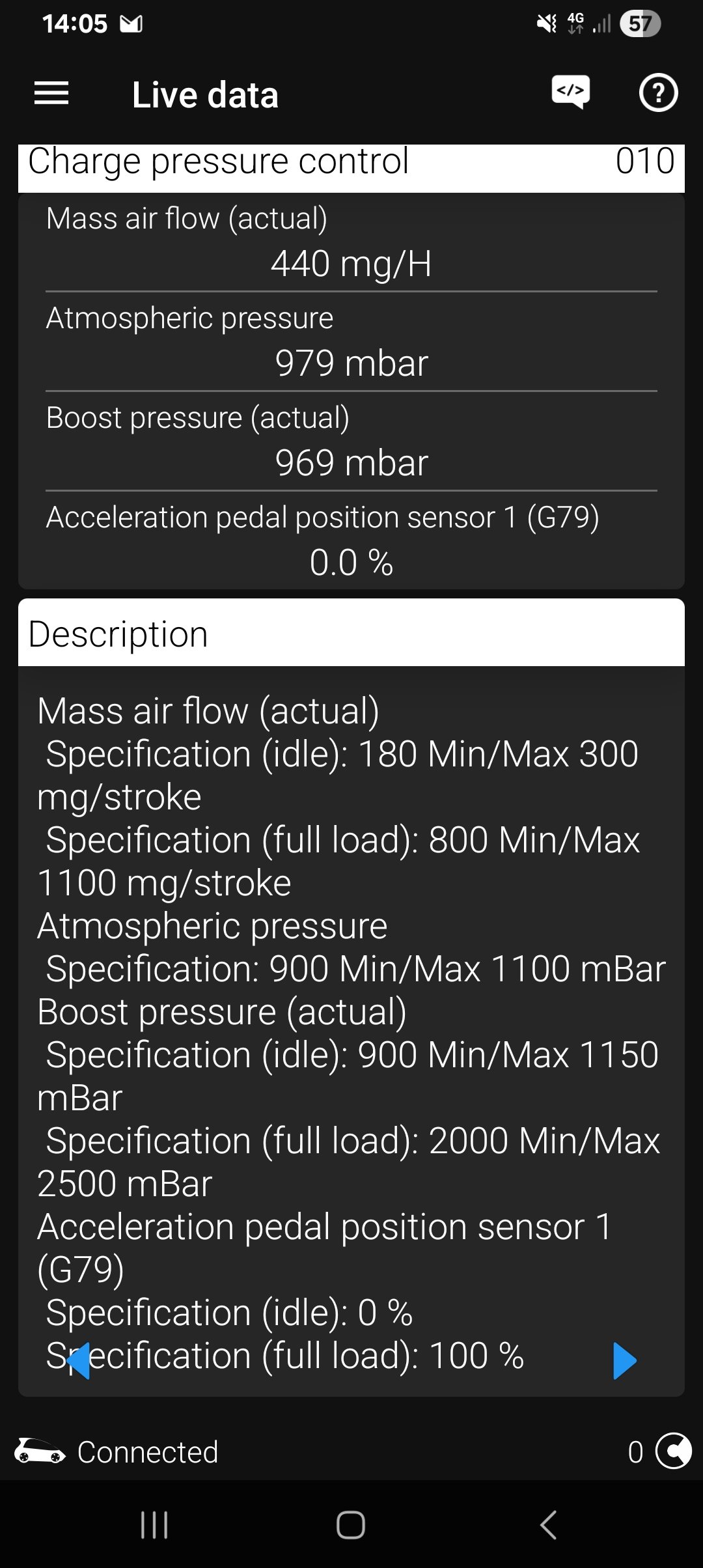

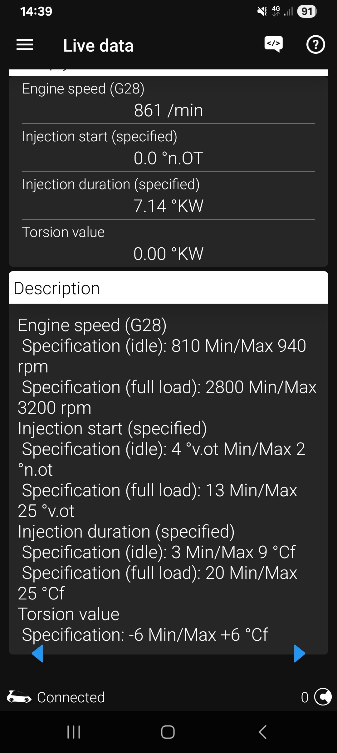

I have fitted the cam sensor, no error. I have adjust torsion value at zero if that's correct? But the air mass was 477 mg/stroke over the limit of 380. So I have bought OEM MAF rather than Chinese. Now it reads 556 mg/stroke. But the car runs lovely plenty of torque under 1,800 rpm. Anything to worry?

I have diagnostics again never had P0341 before on my first diagnostic, MAF is above the level. I have cleaned. Need new MAF and cambelt sensor.

I need a suggest what is wrong with my Octavia 2.0TDI PD140 2009. When I started the engine and drove off, it feels flat and sluggish below 1,800rpm, never felt that before, but after 10 minute it feels lot of torque what it should be. I have looked on list here: Turbo hoses no split or o-ring leaking all fine Turbo are new, the waste-gate is function no seized Vacuum pipes all fine No head gasket leaking through coolant, no oil in the water A bit of puff light grey smoke out of the exhaust in the first 5 second after start which it happens before, all glow plugs are fine. So no error codes. Would that be MAF? the plug are fine, no loose or dirty connectors, how can I test it with multimeter of ohms or voltage? Hayes manual doesn't mentioned what current should I look out for?

Done my timing belt, checked the torsion value was 1.79, so I set it back to zero, but it was impossible to match zero, but 0.49 is the best that I could do. The injection starts when it is cold at 5.0, and it reaches full warmth at 3.8, 5.0 which is over the estimated of max 2.0 recommended. Should I be worried?
