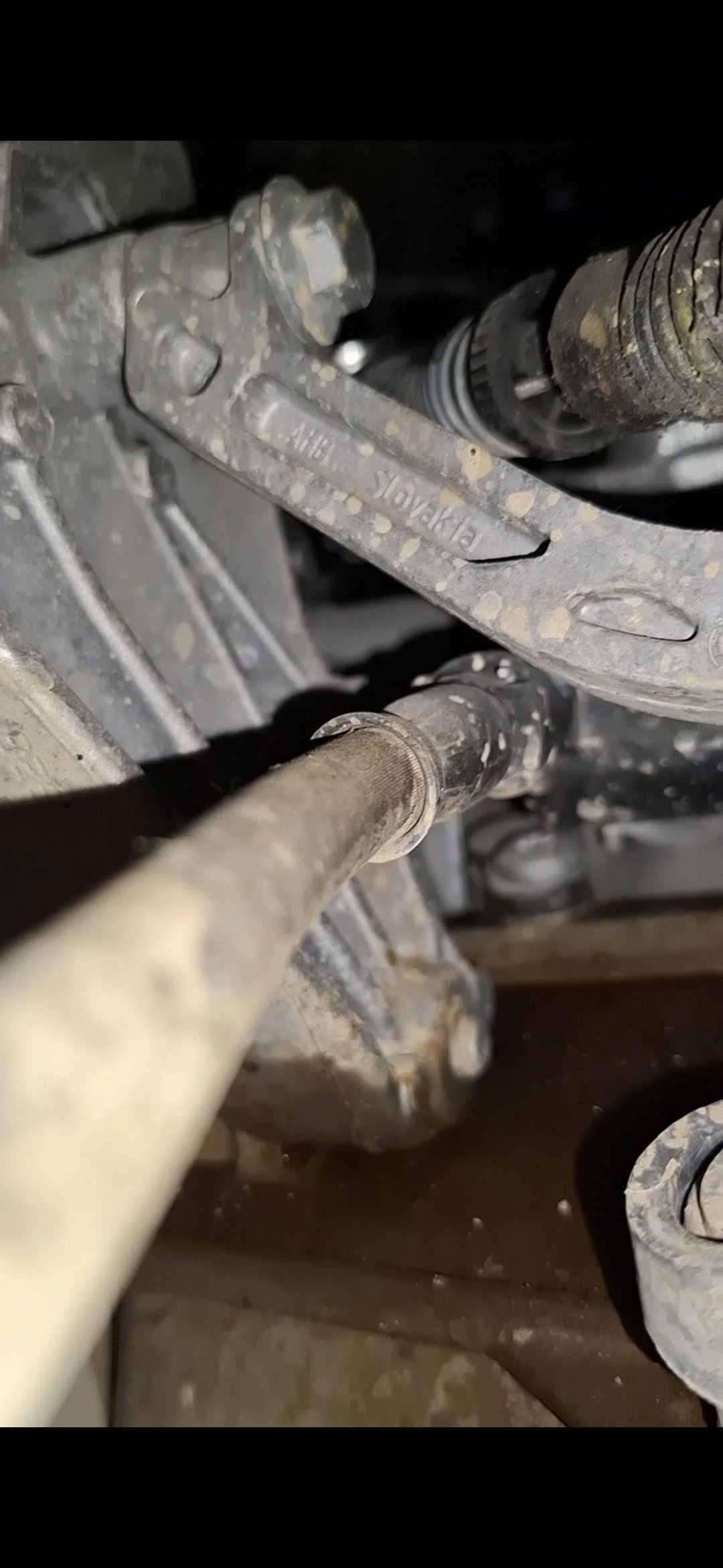

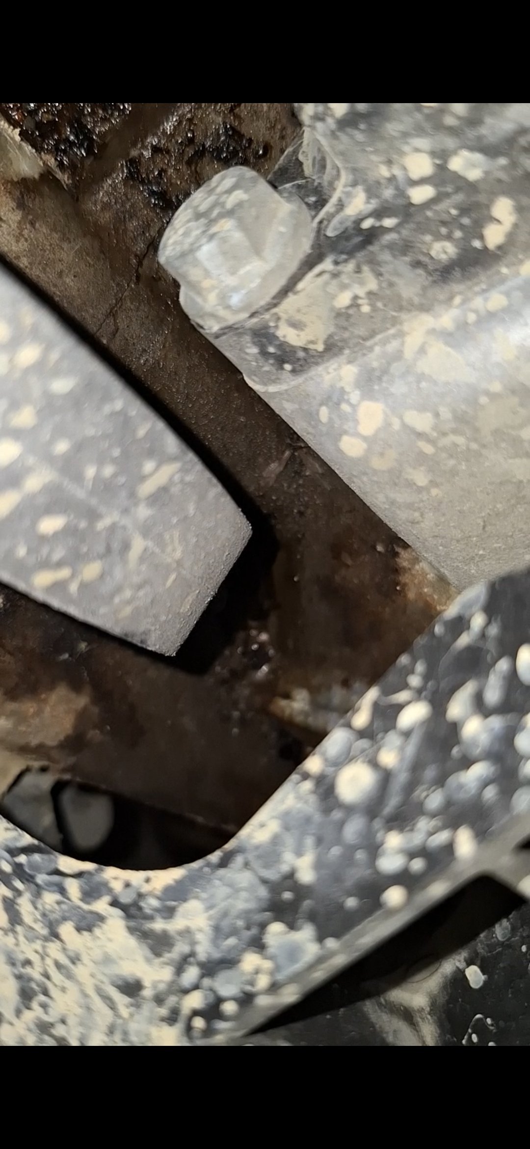

  1. I could barely clean it with break cleaner...imma keep track of everything for the next week to see wtf js going on
  2. I found this random leak of something very very thick and greasy with no particular smell there's a little smell maybe like oil but u can barely smell it. Can it be engine mount leak since octavia has hydraulic engine mounts or some previous oil??? or something serious. Oil 0.2 - 0.3 per 15k km which is normal So idk im out of ideas
