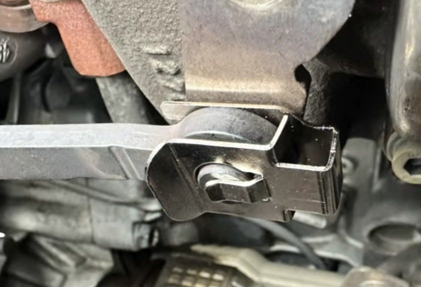

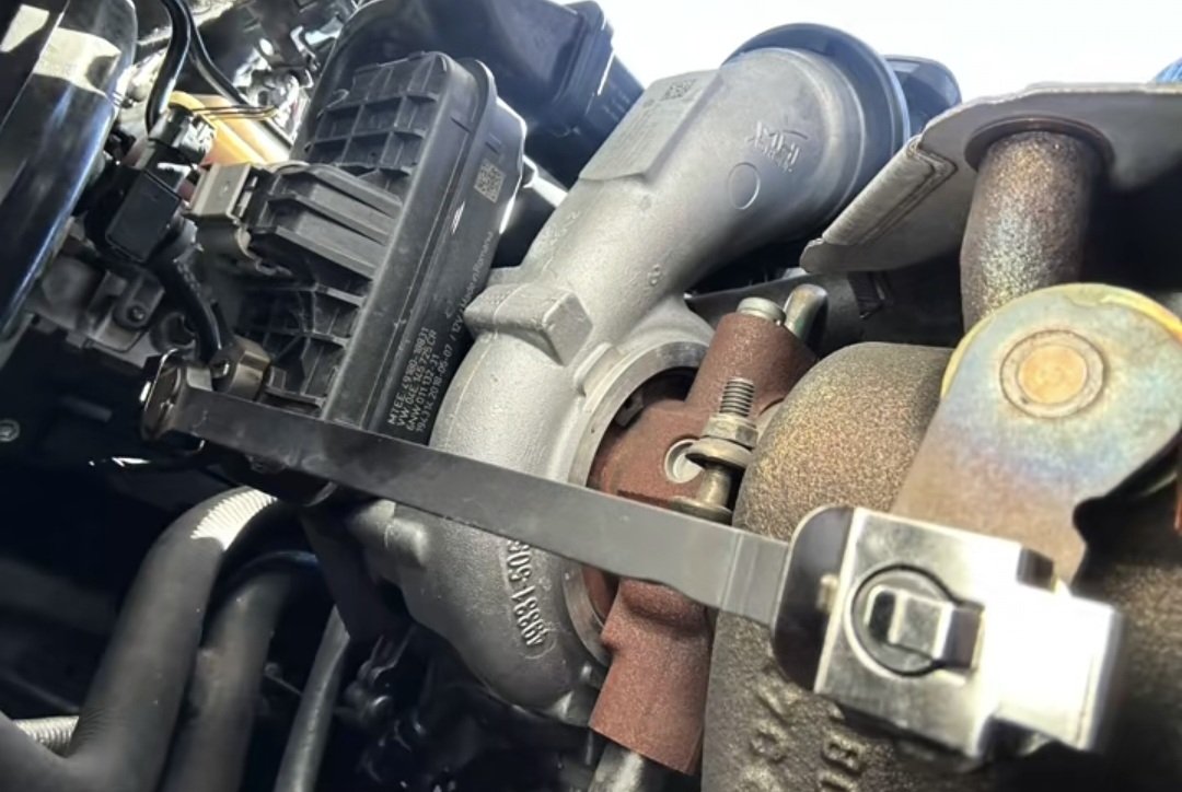

@OctaviaFFM yeah I have funnily enough i found out the solution randomly on TikTok
Idk what tf that part is but that little "bracket" at the end was loose and it made that sound on cold start because it vibrated a lot
Hi, thank you. And have you fixed it? Now you do not here this sound anymore? If you have fixed it with this I‘ll go and tell my dealer to do that.
Yup it was only that, I don't hear it anymore and it was a quite a cheap fix 15e glad it wasn't something worse also that was an common issue kn audi 1.4 tfsi engines (or 1.5 not sure)
Edited by MANi_727
Also if u wanna make sure its 100% that u can turn on your engine and hold that rod lightly that's how I figured it out
Thank you man! I‘ll try it
