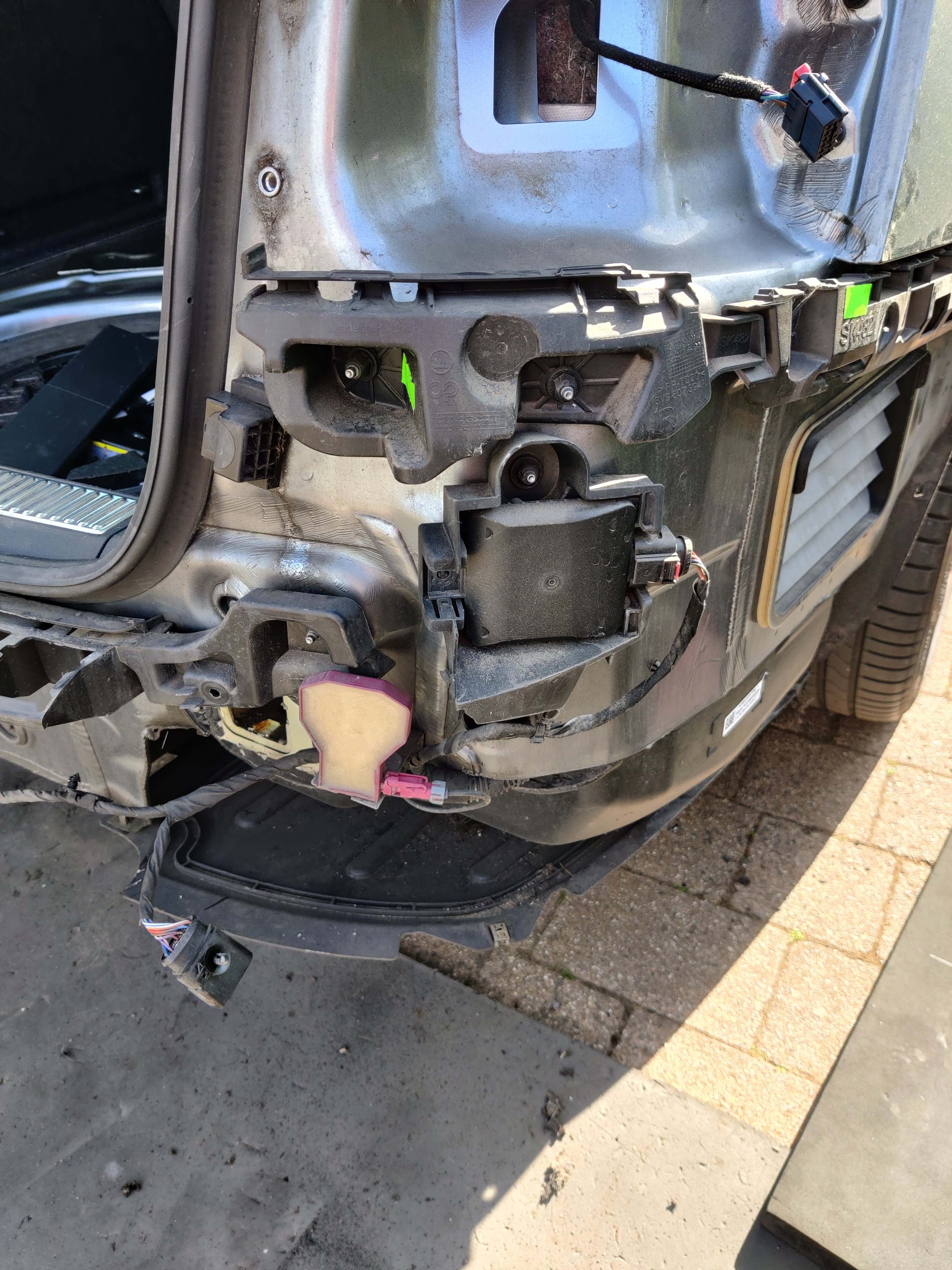

Random question - What's this?
Morning, I'm having a Towtrust towbar fitted this morning so the car is in pieces, I was having a look around whilst the bumper was off and wondered what the white sensor in the middle of this picture is? I can see the parking sensors in the bumper itself, is this something to do with the the side assist system? Thanks Robert
