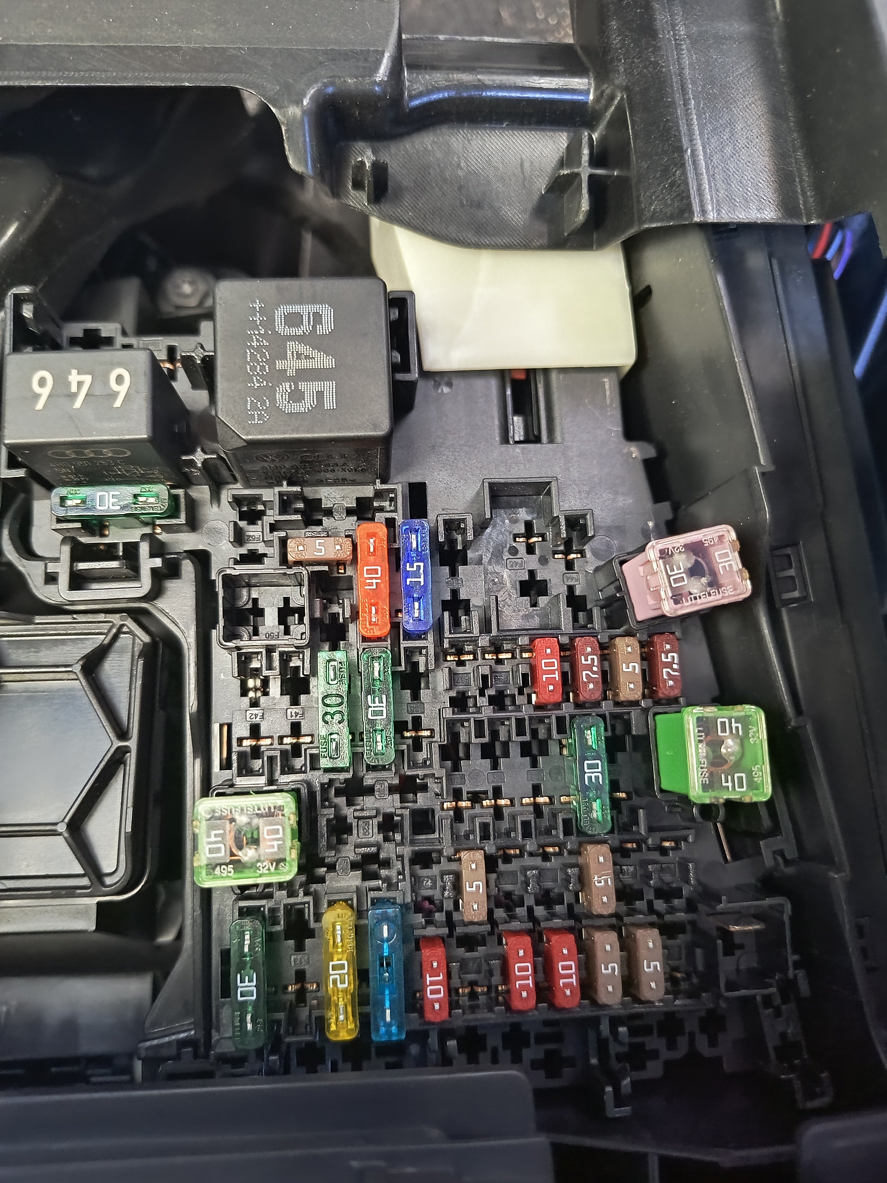

  1. Solved. Went to use the windscreen washers today & they didn't work. Checked the diagram: F42 "Control unit for central locking rear door - left, right, headlight cleaning system, windscreen wipers" Fuse was there but not in properly. Pushed it in & boot & washers now work. Must have pulled it & not put it back properly. What a prat 🤦
  2. Not a daft question. I'm likely the daft one for messing about with it. I don't have any spare. It's entirely possible I've pulled one related to the boot & not put it back in the right place. I found the diagram you linked before which is why I was wondering if position 22 was the boot one? But none from the replacement fuse pack I brought fit
  3. You could be right yes. Though if the manual is listing something should be there I'm concerned I've taken it out. It may be my picture is upside actually due to the way my phone posted it Could you link that post directly please so I can access the YouTube link. I couldnt find it via search
  4. Says 22 is luggage compartment door opening but I don't know what fuse fits 22
  5. Manual says 50 is unassigned. I don't have anything in there
  6. Thanks for your help. It's definitely the 2014 version as fuse 40 was blown & when I replaced it it brought the USB/12 volt back to life
  7. please ignore, posted in wrong version. it's a 2014
  8. Hi, Hoping someone can help. My USB/AUX/12 volt socket stopped working. Blown fuse which I've replaced & now fine. Issue I have is that boot will now not unlock. Central locking is fine. Obviously I must have done something stupid like pull a fuse when I was poking around. Looking in the manual there should be a fuse in position 22 but none of the fuses I have slot in. Probably missing the obvious but is there are certain type of fuse that will fit?
  9. Hi, Hoping someone can help. My USB/AUX/12 volt socket stopped working. Blown fuse which I've replaced & now fine. Issue I have is that boot will now not unlock. Central locking is fine. Obviously I must have done something stupid like pull a fuse when I was poking around. Looking in the manual there should be a fuse in position 22 but none of the fuses I have slot in. Probably missing the obvious but is there are certain type of fuse that will fit?
