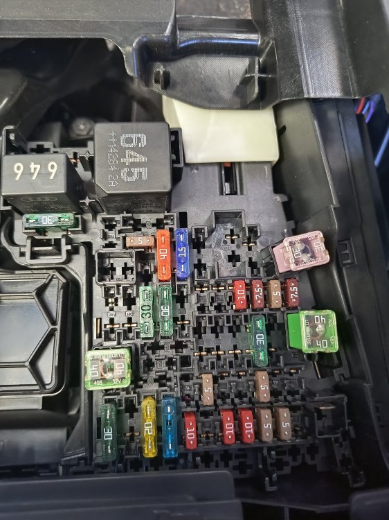

It's definitely the 2014 version as fuse 40 was blown & when I replaced it it brought the USB/12 volt back to life
Edited by tomp2400
Fuse 40 is the 12v socket in MY2015 too
In amy2014 fuse 50 is unassigned but you have one?
Edited by Stonekeeper
Manual says 50 is unassigned. I don't have anything in there1742139145746111322824163989948.jpg

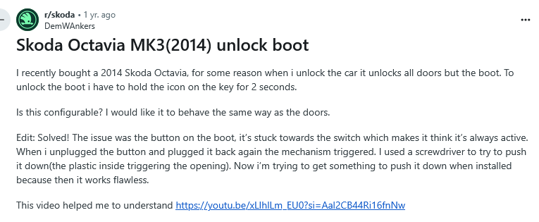

Could it be an unrelated central locking programming/remote problem, what happens if you press the unlock button twice or hold it down?
Screenshot 2025-03-16 at 15-55-37 Skoda Octavia MK3(2014) unlock boot r_skoda.png
You could be right yes. Though if the manual is listing something should be there I'm concerned I've taken it out.
It may be my picture is upside actually due to the way my phone posted it
Could you link that post directly please so I can access the YouTube link. I couldnt find it via search

Went to use the windscreen washers today & they didn't work. Checked the diagram:
F42
"Control unit for central locking rear door - left, right, headlight cleaning system, windscreen wipers"
Fuse was there but not in properly. Pushed it in & boot & washers now work. Must have pulled it & not put it back properly.
