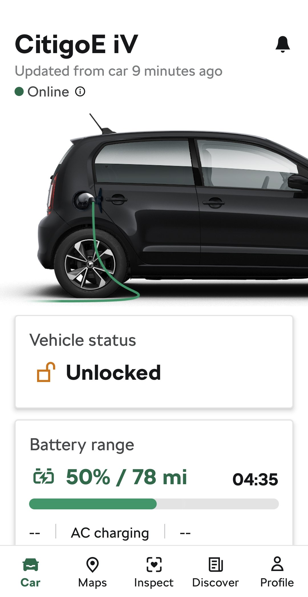

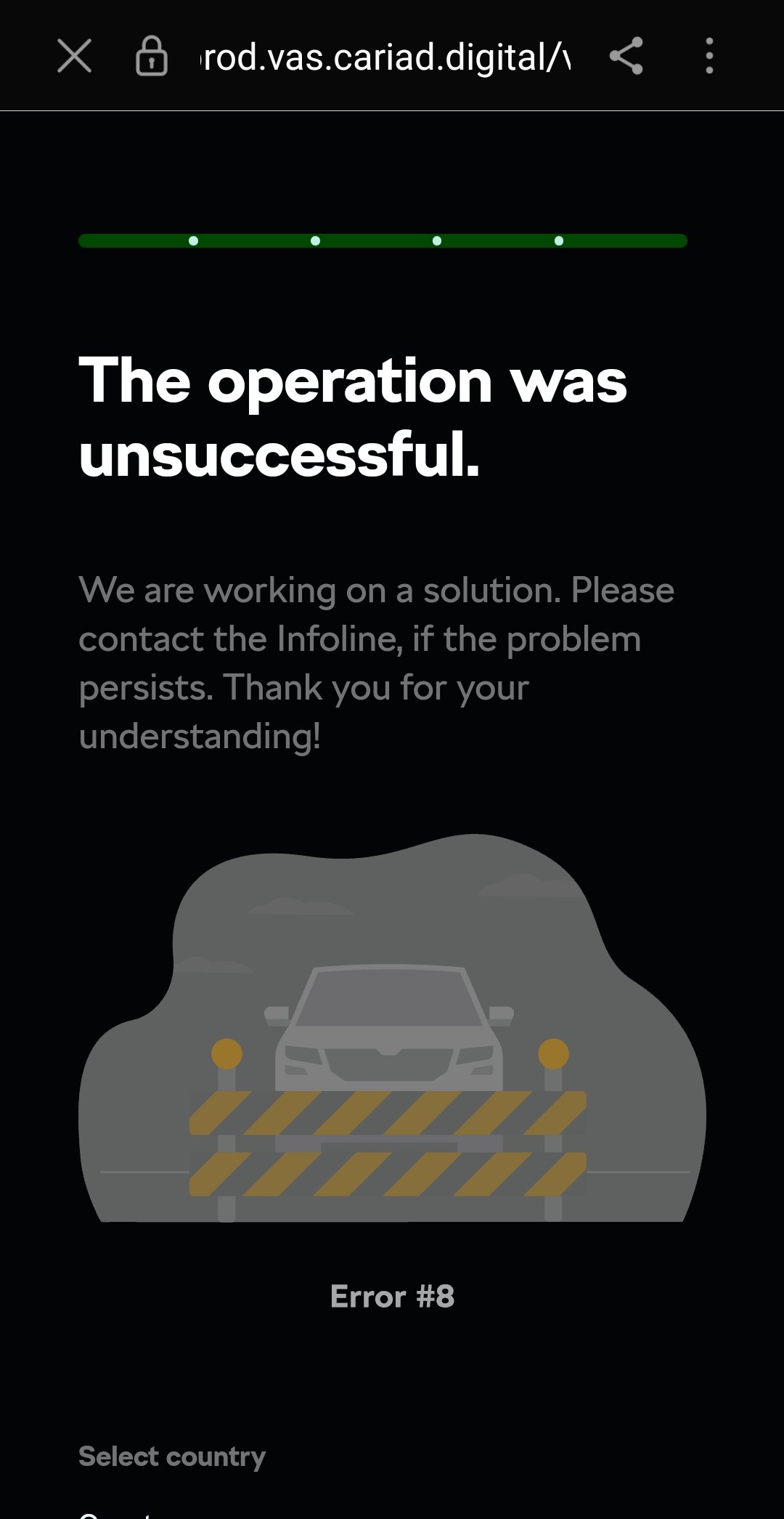

  2. SUCCESS! After nearly 2 months I have successfully activated and can now set the upper charging limit to 80% accurately rather than hopping out to look every half hour or so as we head towards the 3/4 mark on the dial. As advised by Skoda Support, the process was as follows: Set the units in MySkoda app to km not miles. Convert the mileage shown in the dashboard display to km using google (we did 4071 miles = 6551 km) Enter this figure and bingo! I tried entering the mileage as miles and got exactly the same error as above, then tried the conversion and all was fine. So we can now charge at 7p per kWh via Ovo Charge Anytime. Well, until they retire 2G and 3G network... It's only been an hour since I managed it but a cursory look at the app does not show any other benefits, such as setting a 7kW charging capability or the lights on/off when unlocking/locking, or the climate control default of 22 degrees. I hope that this works for others too! ATG

  4. Unfortunately there is no option in the setup menu in the car to change to km, so I have to convert the mileage to km manually. Although this still does not work... I also tried entering the mileage just above or below the displayed figure, as I noticed at the weekend when charging my Enyaq that there was one mile difference between what the app said and what the car said. But still no good... Why did they mess with the perfectly satisfactory Move & Fun and Connect apps? I hoped that "error #8" would lead the tech guys to the root of the problem quite easily. But I suppose it's been a few years since they sold the model and the collective memory must have gone.

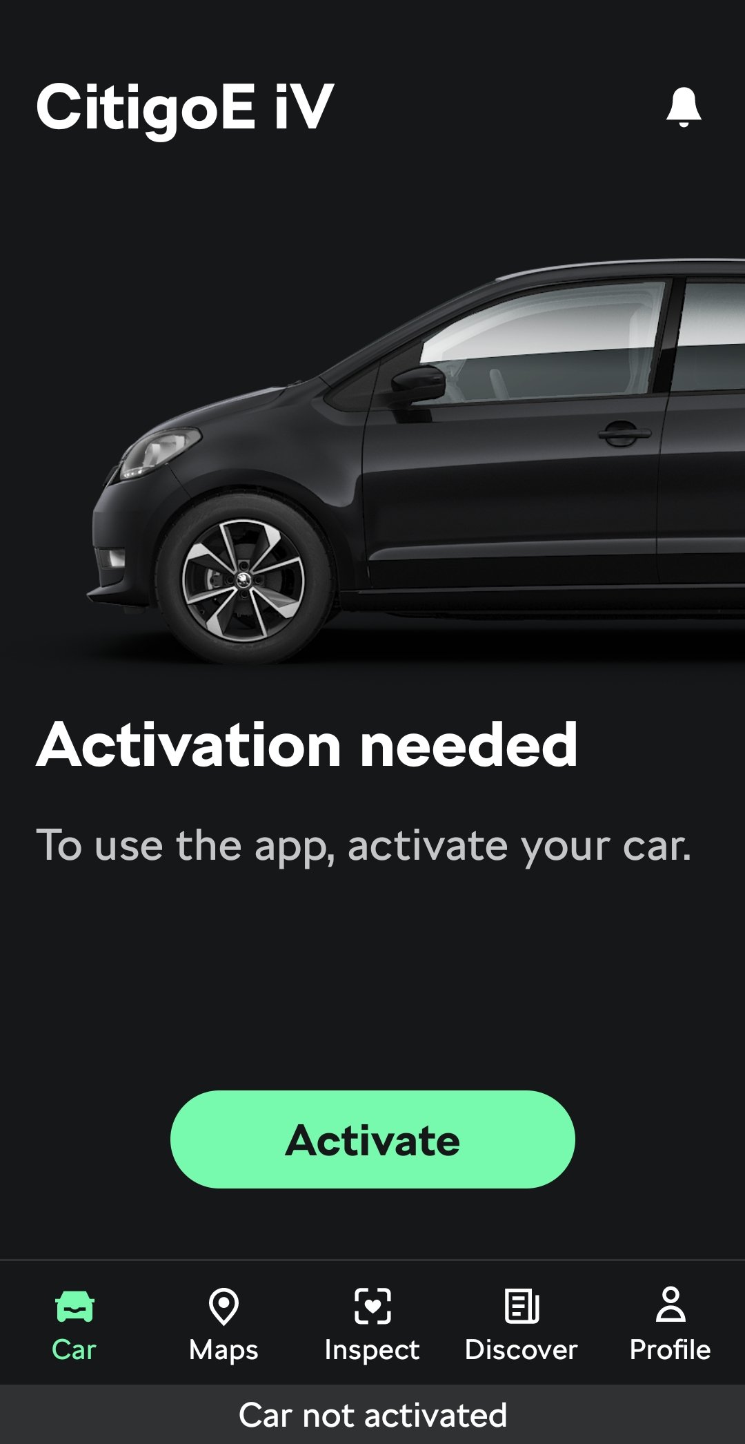

  5. Hi all, I recently bought a 2020 Citigoe iV which I am not able to activate/finish pairing in the MySkoda app. The VIN is recognised and the model and colour is correctly displayed. However, after entering the mileage I receive a message saying that it was unsuccessful, with error #8. I have been in touch with Support at Skoda-auto and they have twice asked me to send screenshots etc, which I have done. But no progress has been made. I have tried all permutations of: Bluetooth on/off, connected by USB (or not), leaving key in ignition/removal, leaving it 10 minutes for the esim to send the mileage to the mother ship, entering the mileage in the km equivalent (seems to work for the e-up), etc. Has anyone else been able to connect to the app? This is not just for fun, as without it I have to charge at my full electricity rate due to Ovo not recognising my charger. Also, it would be good to get the charging rate up to 7kW and disable the default 22 degrees in the heating system. I'm starting to suspect that the esim is in fact a 2G or 3G model which is no longer supported by Cubic. If it is, can it be replaced? Any suggestions would be well received, as in all other respects it is a cracking little car. My back stop is to change electricity provider to Octopus in August when the current contract expires. Regards, ATG
