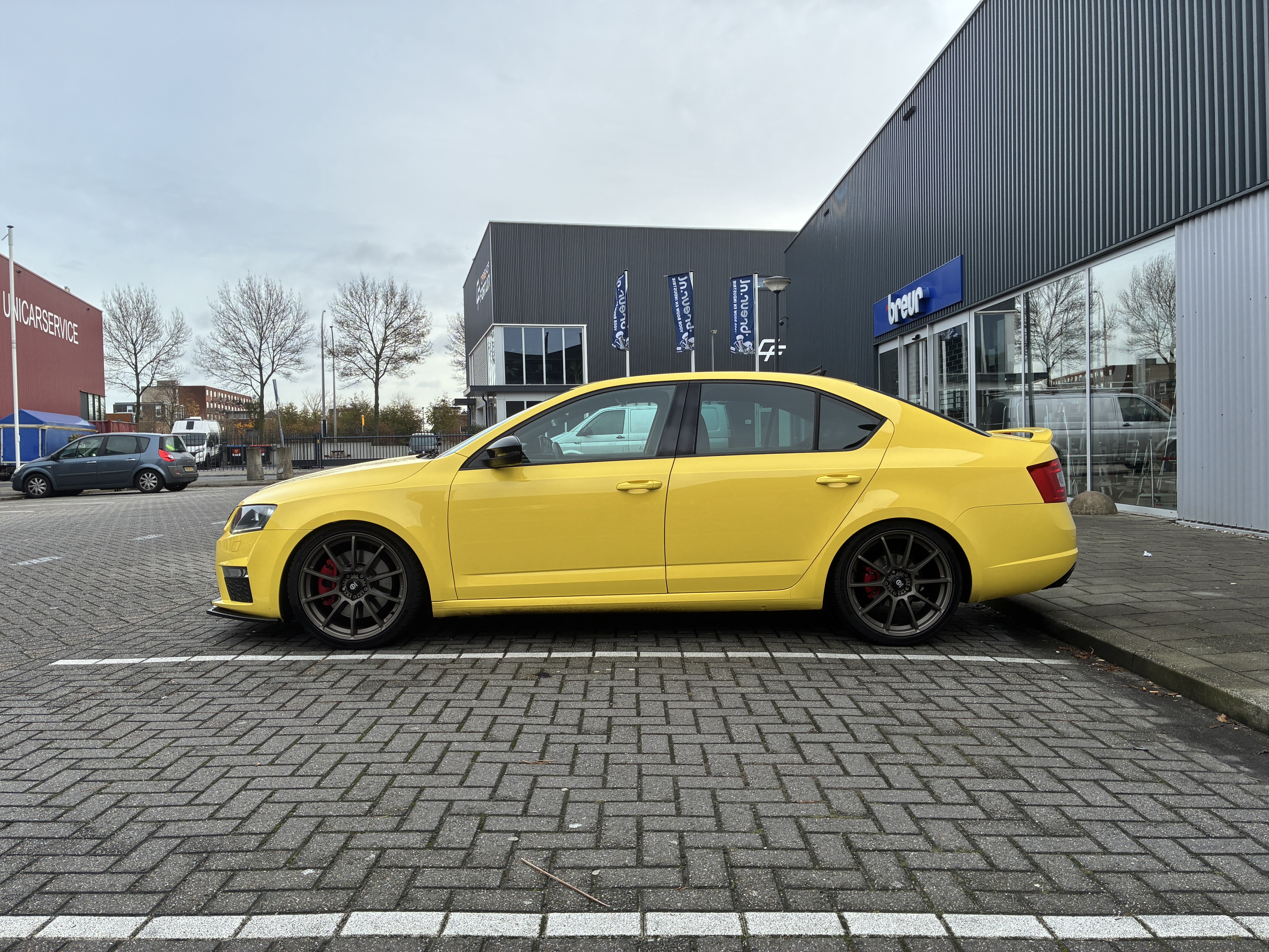

  9. Sorry I haven't seen your post hahaha. Done lots to it! Lowered on ST coilovers, new wheels, new front lip, Whiteline rear anti rollbar, looking for the best Exhaust solution right now though. But I love it the way it is right now.

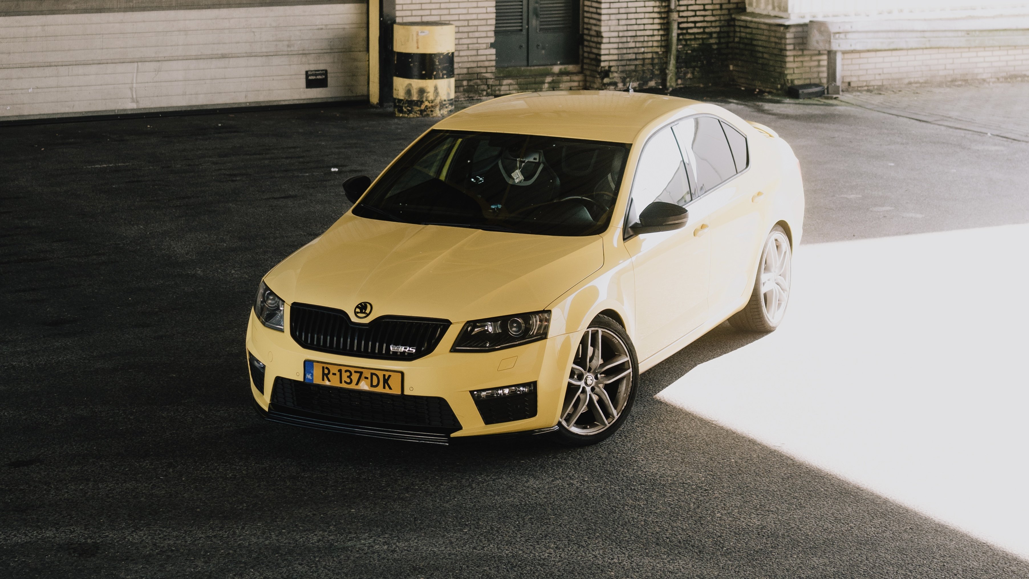

  11. Hello! Octavia VRS owner here. I’ve read some topics on this forum but i’ve recently decided to also create an account on here. Love the car, it’s on a Stage 1 ecu + dsg tune right now, lowered on Eibach Sportlines, done the poor mans r600, BBS 19 inch wheels, backbox delete and rieger front lip & diffuser.
