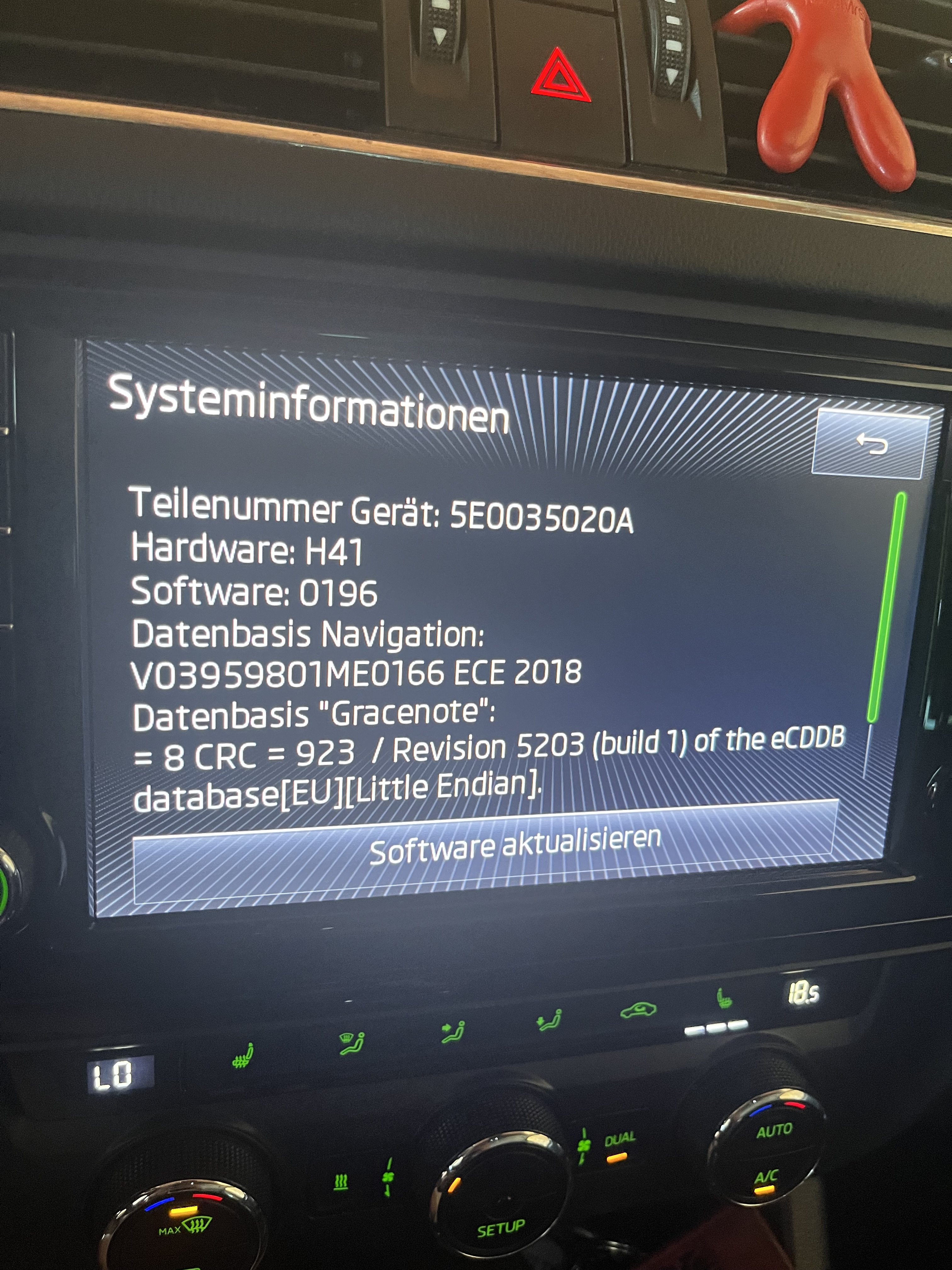

Last Sunday, I updated my Škoda's MHIG Harman from MHIG_EU_SK_P0346 to MHIG_EU_SK_K1552. The process went smoothly with no errors but after the final restart I encountered an issue. Although I could connect to Bluetooth, I couldn't play anything. It worked fine before the update. Now, only Bluetooth hands-free calls work; the multimedia/CD reader is unresponsive, and a CD is still stuck inside and won't eject.
Everything in Media sources is grayed out.
I've tried several solutions from installing More-Incredible-Bash to applying a random patch found on the MiB Telegram group, but nothing worked. I haven't found much online from others who experienced the same issue.
On a Russian forum (translated via Google Translate), I read that you need to download a Bluetooth update from Škoda's update service but I can't find any information about that update online. The only thing I get from the Škoda update service website is the maps 2024.
I even tried FEC codes for Bluetooth/multimedia with Pre-V3.7.1 - MHIG Edition, but that didn't help either. Later, I realized that MHIG devices don't support FEC codes for navigation or multimedia.
