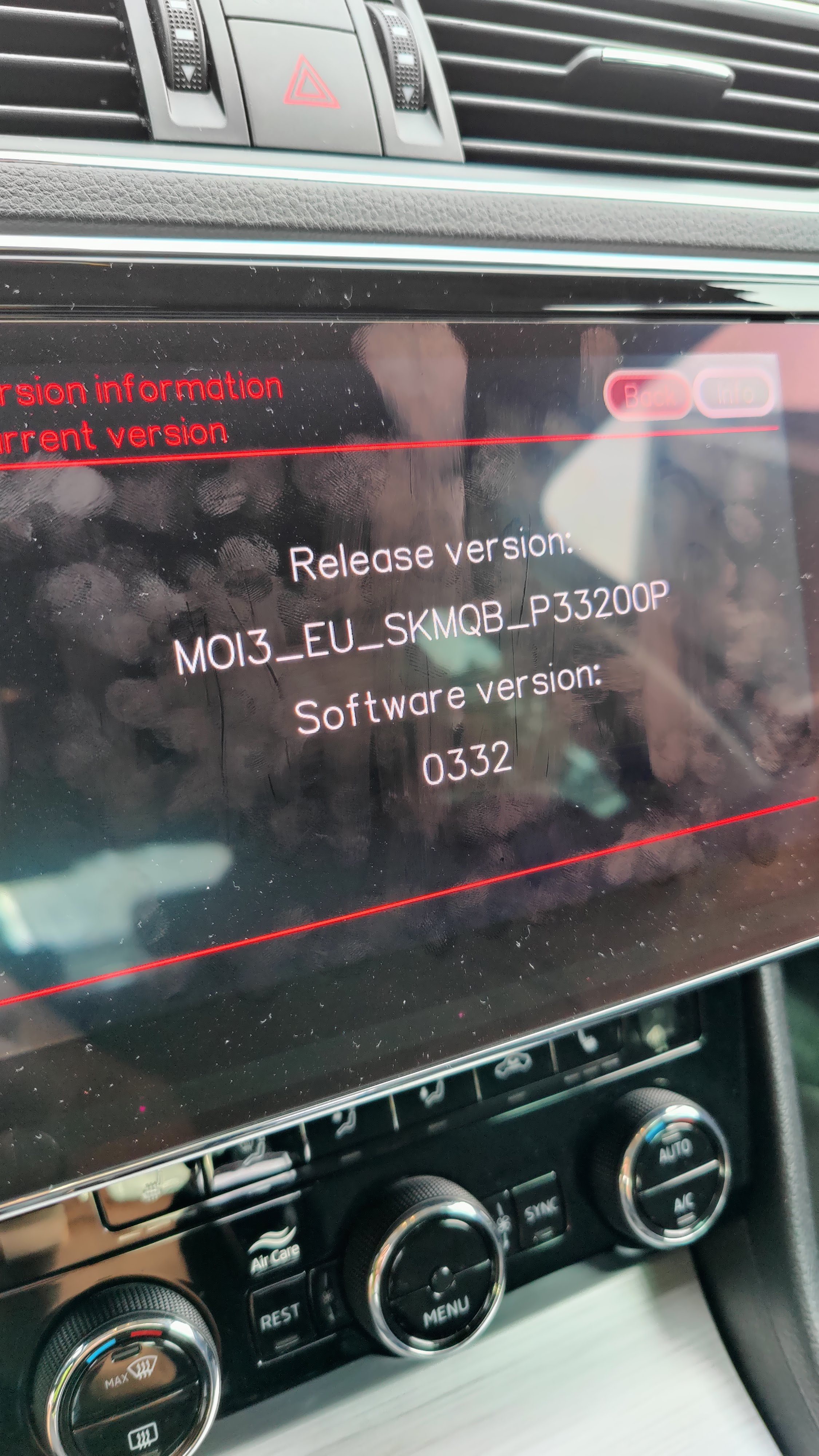

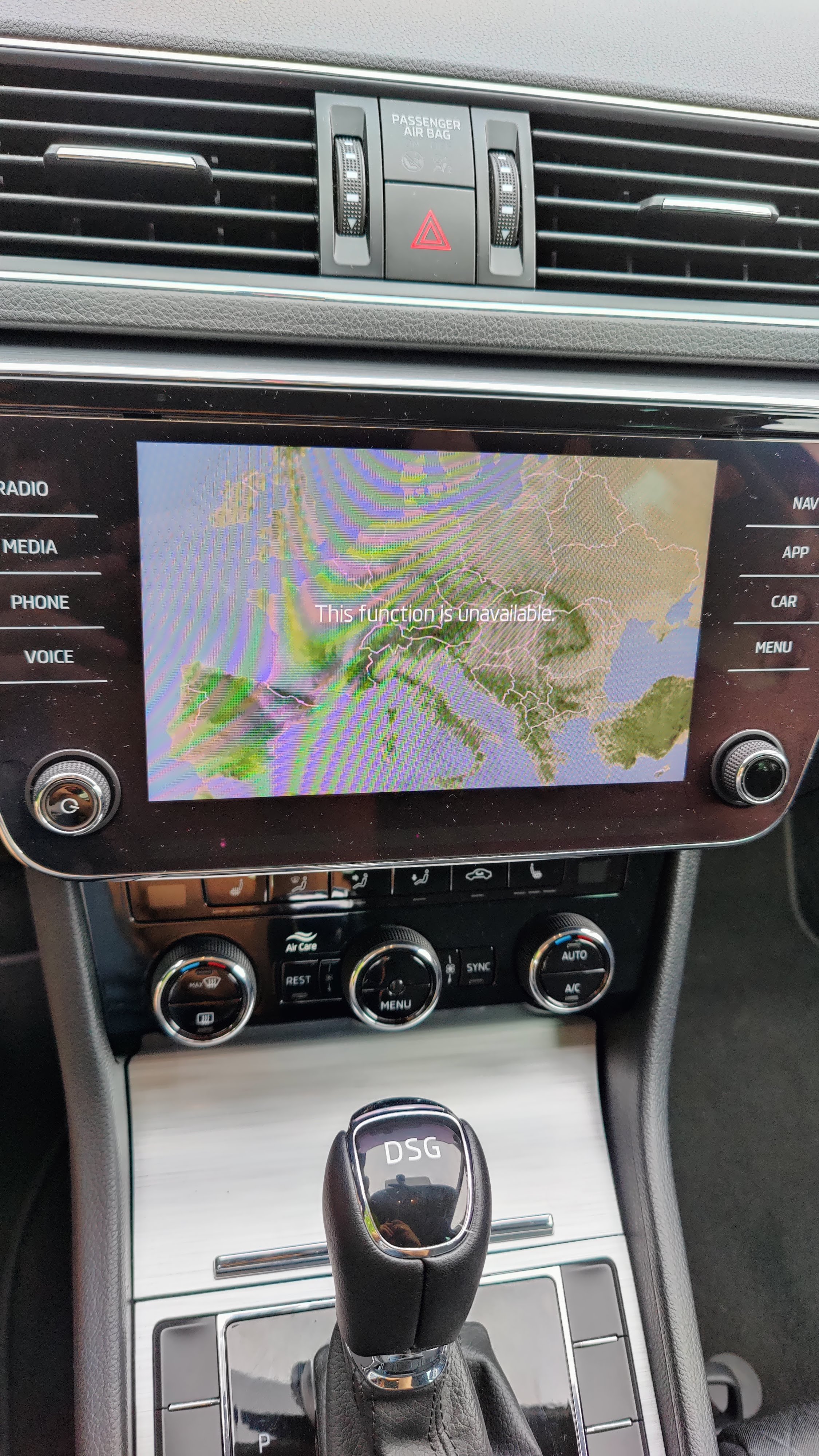

  4. The updates install without any problems, thank you. The situation with navigation is "This function is unavailable." as far as I know, it needs to be decoded, but I haven't found the information yet. Maybe you have information?
  5. Thanks for the link! A few questions: As I understand it, first I need to update to 308 and then I can go directly to version 332? Will there be any errors after the updates that will need to be fixed? I seem to remember reading in older notes that this was the case. Navigation is not working now — after the updates, will it be possible to activate it more easily?

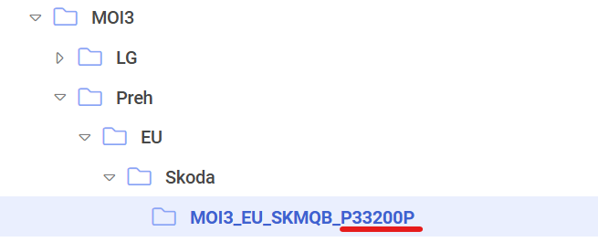

  6. Have same question but EU. Å koda superb 2022, now have MOI_EU_SKMQB_P30400P version. In mibsolution EU version i see just P33200P: Can I upgrade to this version right away or do I need to do any updates first? @Cairus I see you wrote something about the EU version, maybe you can help me.
