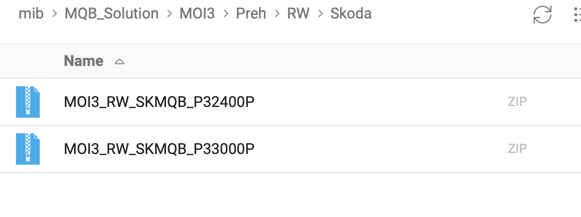

The only thing I found was here mib › MQB_Solution › MOI3 › Preh› RW › Skoda. and the File = MOI3_RW_SKMQB_P33000P

@travs The folder contains only 330 and 324, a link to 308 would be highly appreciated unless I can go directly to 324 and then 330?
