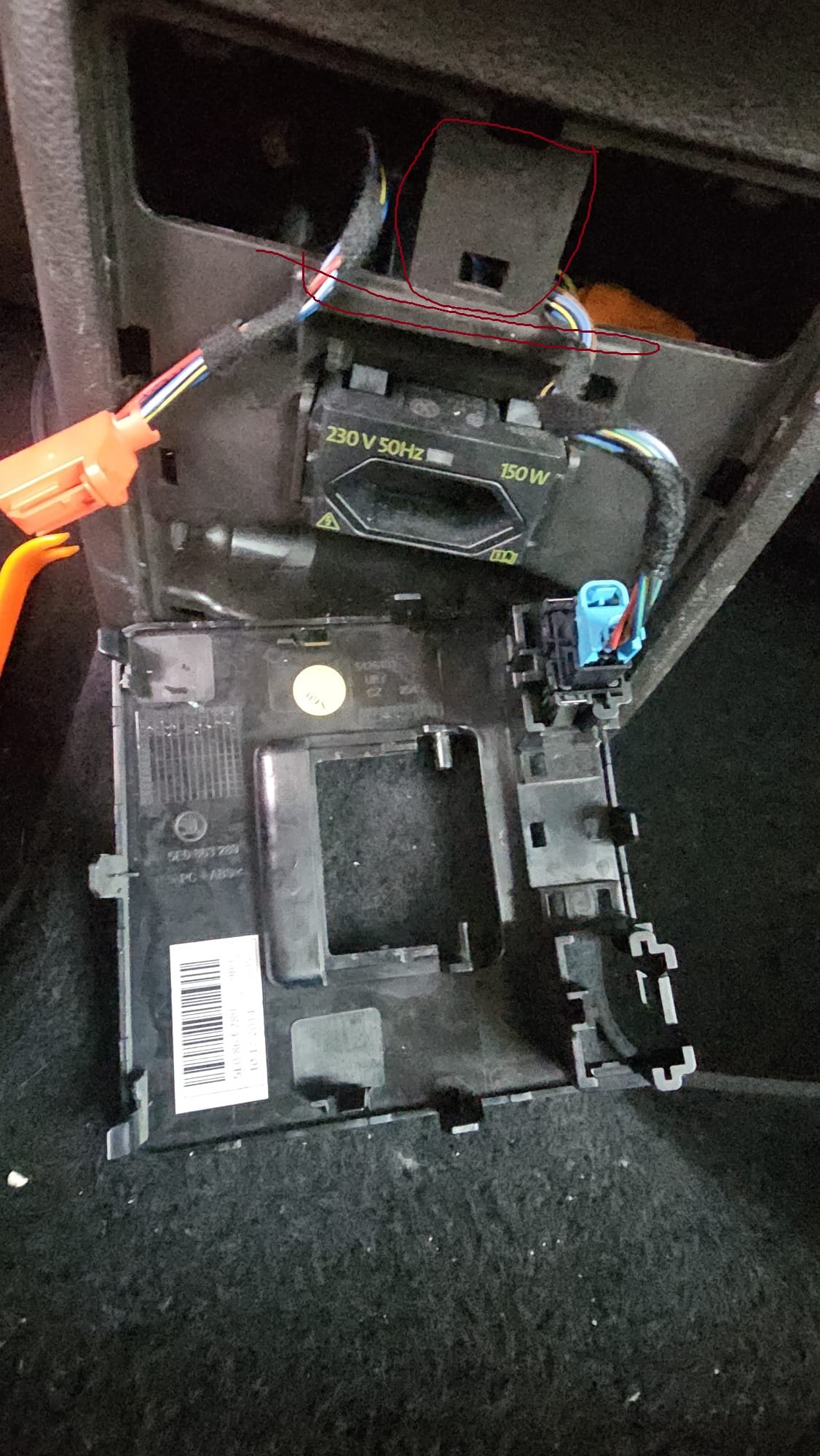

hey Marco, I know it was some time ago, but I have a prelift 2015 mk3 and wanted to do this upgrade, I ordered this part https://www.skoda-parts.com/spare-part/5e0863289a9b9-cover-skoda-43174.html 5E0 863 289 A and it seems to go to high when I try to put it on, did you have to cut plastic to fit the cover? Also for everyone to know, the buttons for heated rear seats don't fit from prelift, they changed them slightly, reshaped, let's say ðĪŠ So i'm also wondering if connectors will fit, but I guess there was no option to have USB in the back in pre lift?

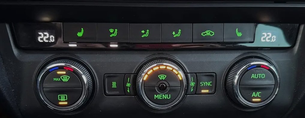

Hey guys, I'm planning at some point to add heated windshield to my mk3 Octavia 2015, but I already have webasto or parking heater, I know it's exaggeration to have both :) I have a hard time to find the right panel, with both buttons like on a photo, anyone know part number, or know where to buy it? Also, does anyone know, if I would be able to find correct panel, can I install it already without yet having windshield or would I need to again disassemble the panel when installing heated windshield? Thanks
