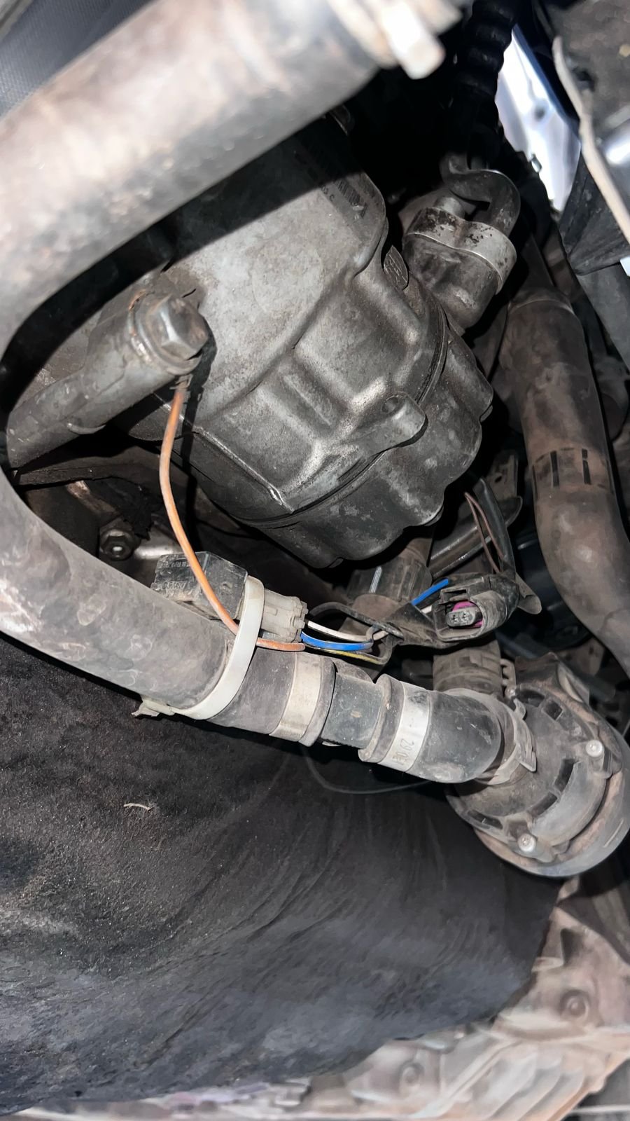

Heater support pump Wiring Diagram
Hello all, I have an heater support pump issue on the Octavia mk3 2.0 TDI DSG. The wiring seems to be bypassed from the connector side and the engine takes a lot of time to warm up. This heater support pump is one responsible for the heating of the engine, as per the circuit of the vehicle. Yet to do a VCDS output test. Does anyone have verified wiring diagram for the support pump? Would be of great help, need to sort out the wiring first. A picture of the same is attached. Happy Motoring!

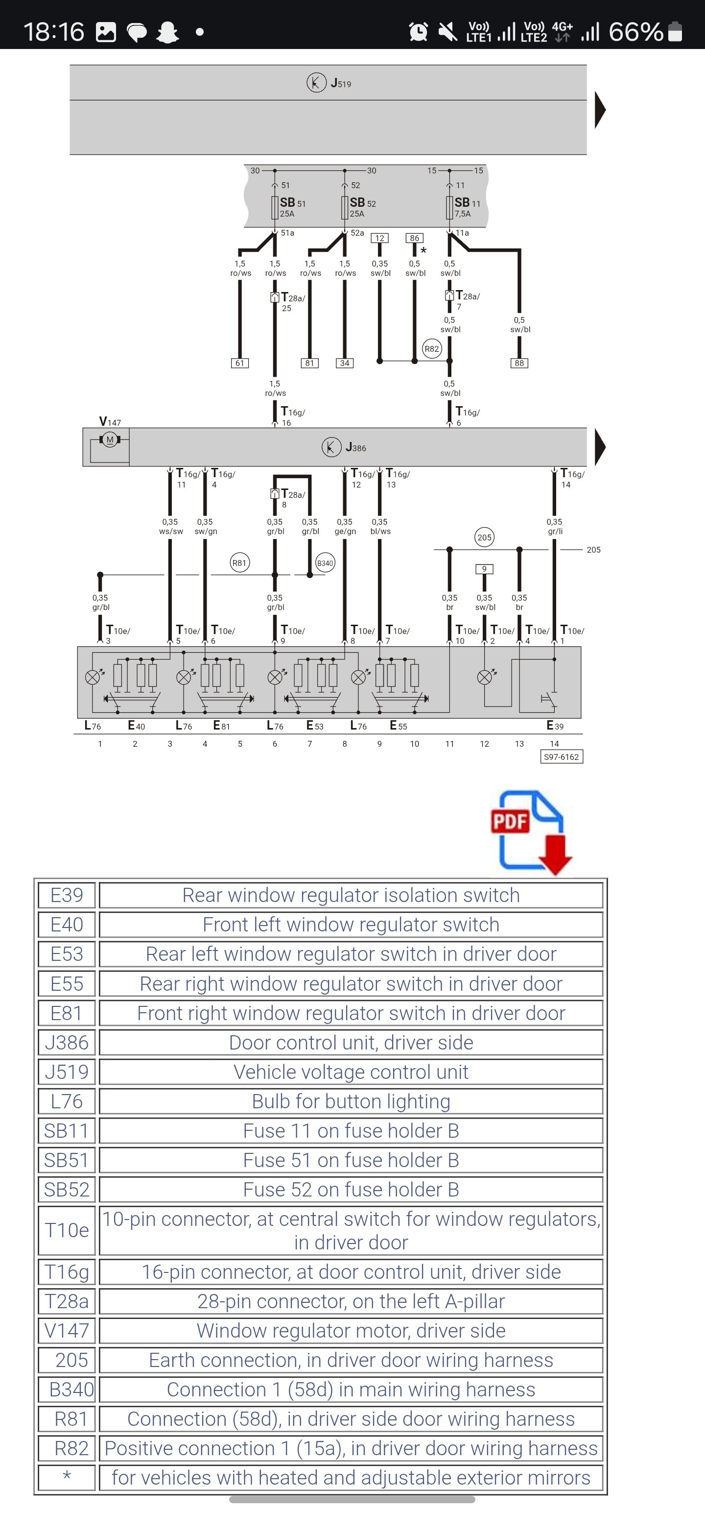

Wiring diagram for the windows in a Mk2 1.4TDI Fabia

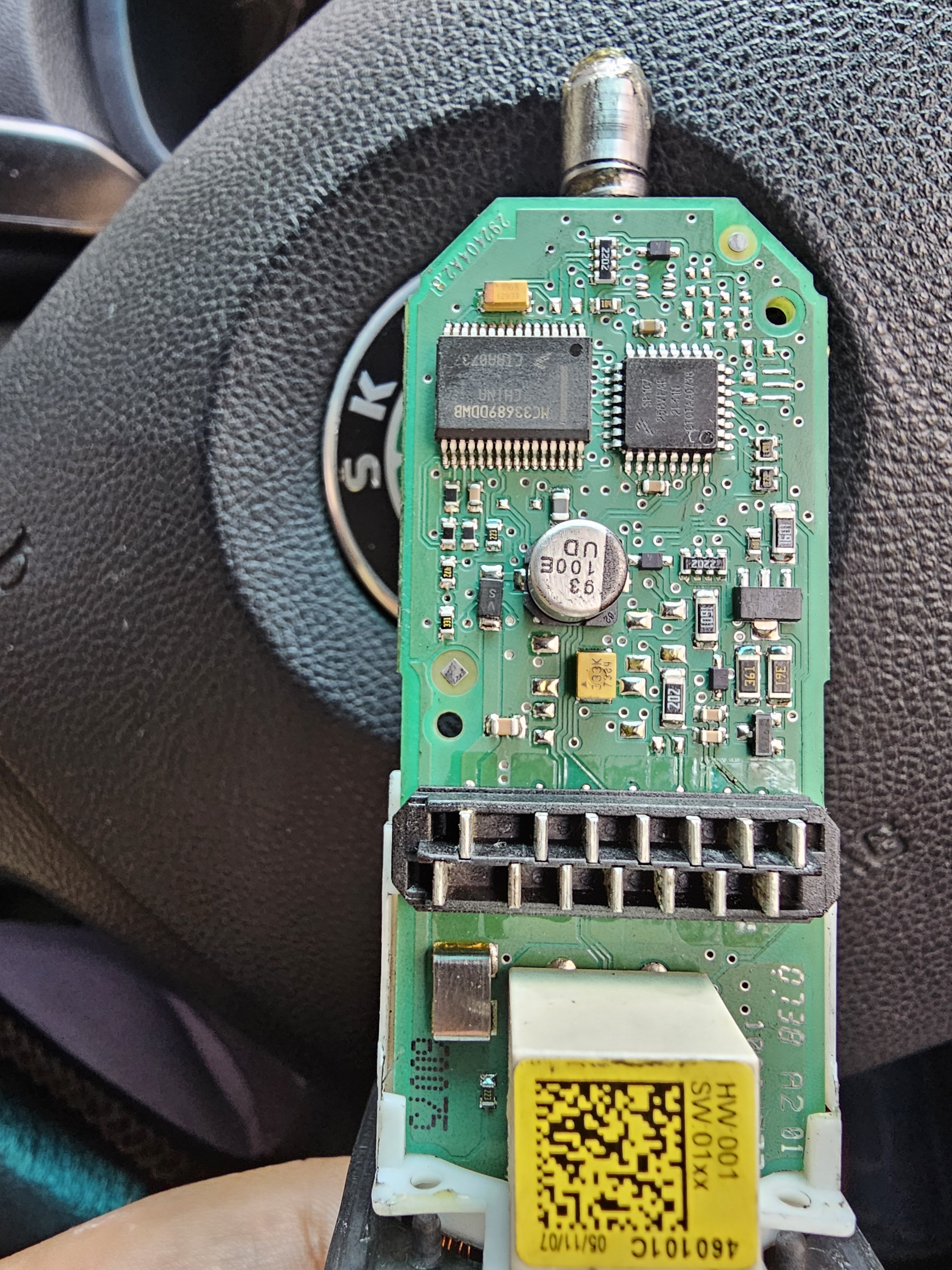

Just removed the motor to check, the PCB came apart with the motor housing. A picture for understanding. Couldn't see anything bad with the PCB.

I swapped the rear left motor to the front passenger( front left) and the same issue persists. The main switch is unable to communicate with the passenger side. I even tried to jump the terminal 5 and terminal 10 on the connector of the main switch, which should essentially power the passenger, as per the above diagram, that too doesn't work, this again proves that the main switch is fine, if jumping is not working either.

Okay, got it now. All 4 doors connected via a common LIN BUS for the window motors which is grey/white. Thanks a bunch. I'll check continuity of this one at all doors and report here. My VIN: TMBAEM5J87A500877 MY 2007 ( through the window print ). Also which is the wire which controls the windows via the lock cylinder. Mine is a NO button key. The rear windows open and close with the key held in lock/unlock position, but not the front. The wire which may command the window motor to roll up/down from the lock module might be bad at the front doors. Could you also point out this wire? Thanks a lot, will report findings here in a short while. Happy Motoring!

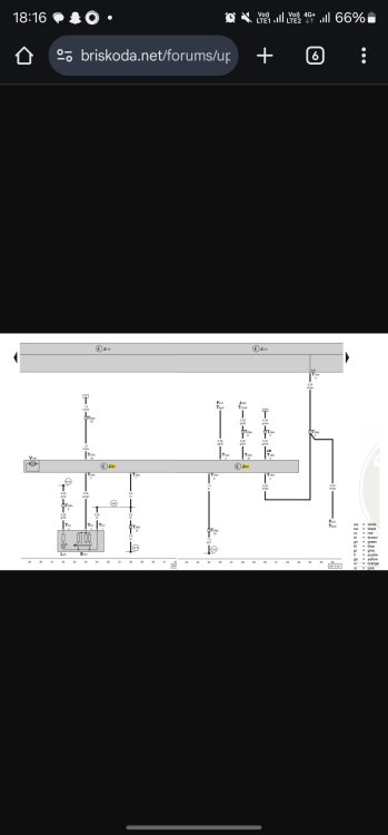

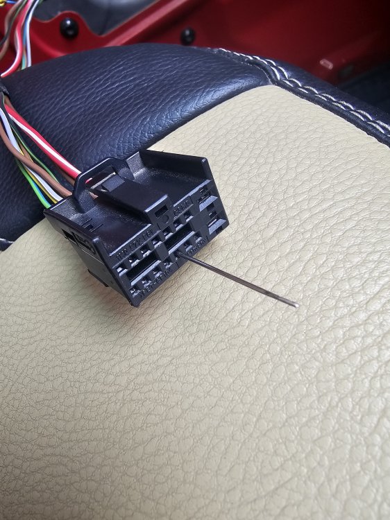

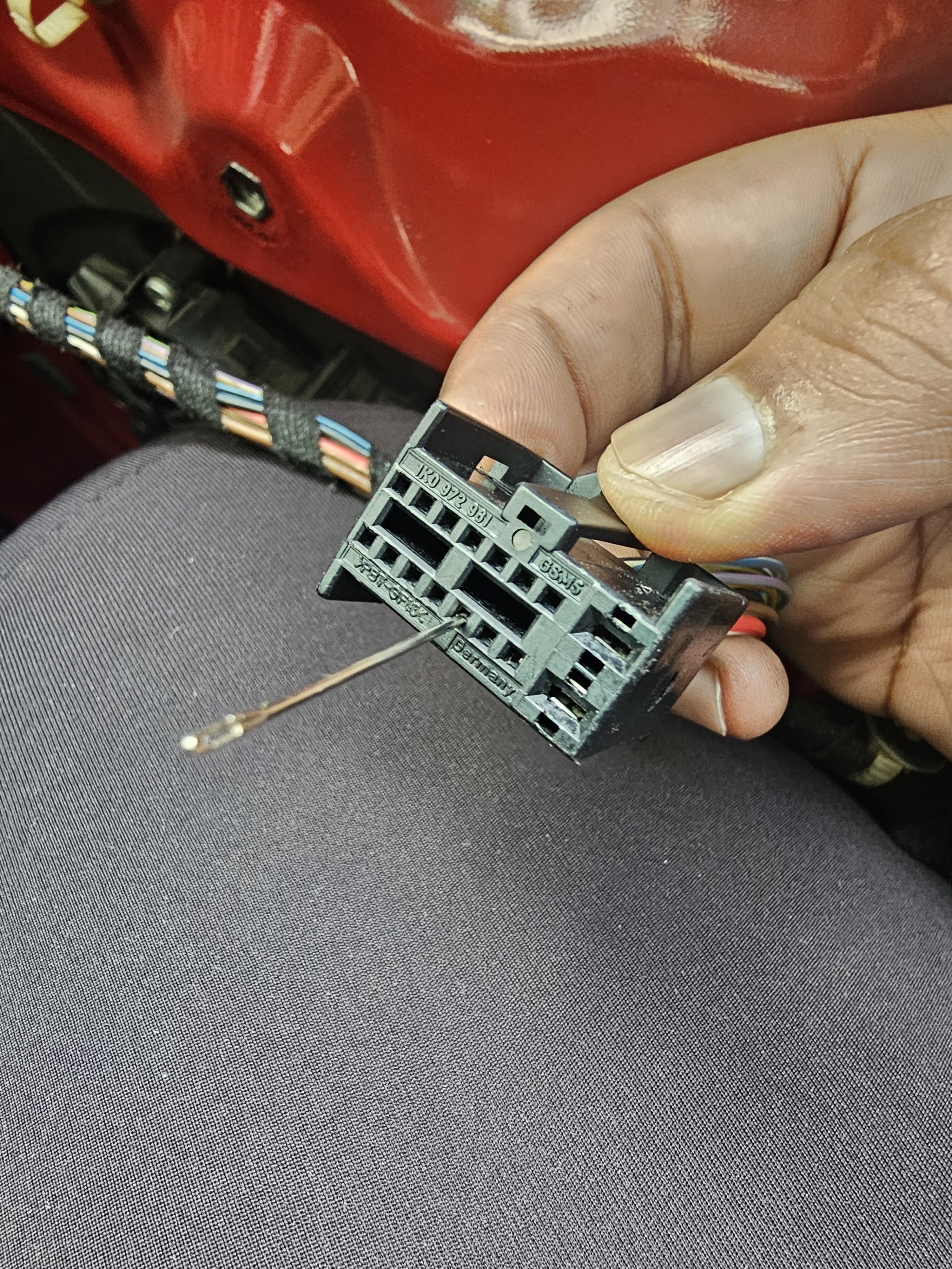

Hello there, my first post on the forum. Hope you all are well. I have been trying to fix the window motors problem on my 2008 Fabia. I've found 2 wiring diagrams for the front windows, but they are not accurate on where the ends meet and the wiring in between. Say that the wiring of the driver door ends in a module, from there where is the next connection and the data line for the the other doors like passenger, rear doors. Would like to have inputs and the wiring diagram for all the 4 doors, if someone could upload it, it would be helpful. The motor connections are 16 pins for me. Will share a picture as a guiding for someone to upload. The pictures match the wiring for my car, and are for the front doors. Any suggestions regarding the data lines is highly appreciated.
