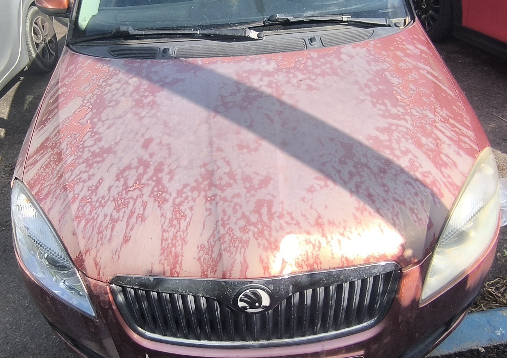

2009 Fabia mk2 5j - orange paint peeling.
ill send you today my car pictures. be sure my hood is WAY worse then that

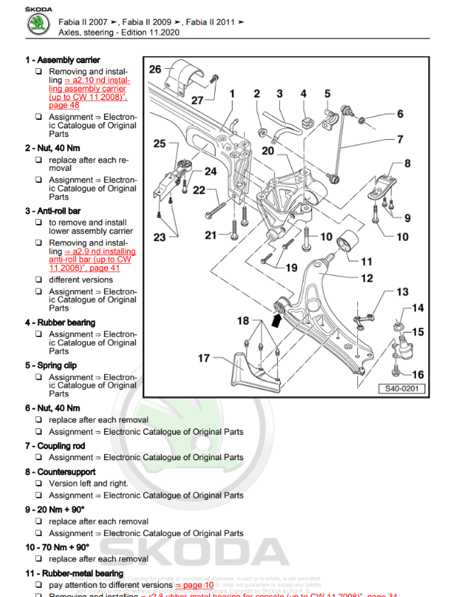

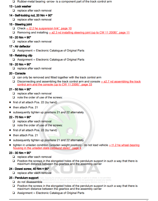

should the coupling rod moving wheel hub to one side?
thanks everyone. it would make sense that the problem had been cause by one wheel touching the ground. when i finished working the the driver side i put the wheel on and lowered the car so that's probably why i have a bruise on my face now (got the wheel hub to hit my face when i tried to mount it into steering joint lol)
when i say coupling rod i mean part number 7 on the diagram that i linked. also i did not change the cv joint it self. i replaced the protactive dust boot, that way i would reserve the cv joint for longer
hi, today i change the cv axle boot because they had tears. when i removed the tie rod and steering joint (by the 3 bolts) i noticed that the passenger side wheel hub tend to pull to one side (wither left or right). when i inspected that the behavior is cause by the coupling rod i wondered if it is normal. at the driver side the coupling rod did not cause this problem and i could move the struts with wheel hub without any resistance. it seems that the coupling rod have tension or something and that is the reason why it happened. is this behivior normal? if yes/not then why only the passenger side is like this and not both? linked below the diagrams. best regards.
