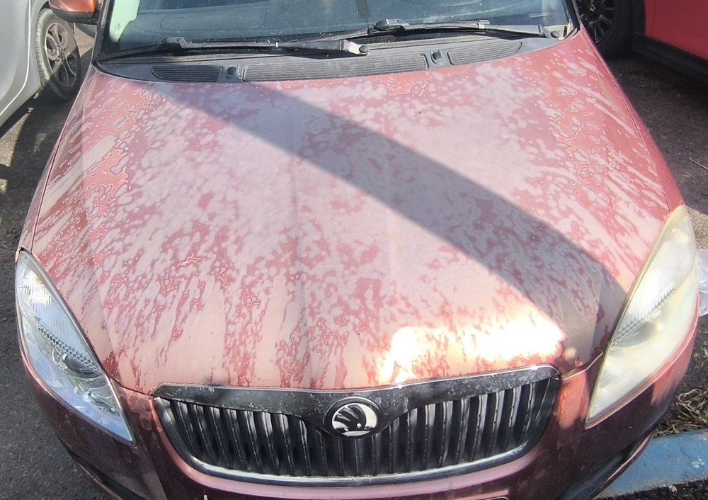

Current state. Somewhat embarrassing!
@mlteenie Holy camoly. I have never seen anything as bad. I have seen peeling, even on Mk3 Fabia.
& back to Escorts & Cortinas.
So when did the start to show, and did you follow some type of road maintenance vehicle, tractor trailer, tanker or the likes?
Or, did you use some drive in car washing type place, hand washing or drive through?
Edited by Ootohere
See! 😩😳🤣
I noticed it starting about 7 years ago and every time the motorway speeds get to it, more top coat flakes off. It may be down to living in the SE (hot) and not washing it enough. I don't know but whenever I see another orange Fab, I check their paint. Similar story.

You could try a polish/compound called frecklar it's a cutting compound normally used in the trade for bringing paitwork back from cars/vans that have had transferes on them, it might be worth investing in a polishing buffer tool to help you out, if it does not work you could like I did with my old MK5 Corinta is flat it down untill it's a matt finiish then clean and tack cloth it and use a simular pait colour and you could hand paint it or get it sprayed, mostly the prep costs the most so doing ths your self could save you quite a bit, I re sprayed mine myself I hired a commpressor and gun bought under coat and finish colours paint and thinners and did it in a mates garage turned out ok you soon get the hang of spraying, I have also seen some one use rattle cans but that can work out expensive depending on how many panels you want to spray, years ago i hand painted a car with a paint called re-paint and did the big panels with a gloss roller and hand painted thesmaller parts from a few yards away you would not know the difference but that's your choice

If its just the laquer it might be worth rubbing down to a matt finish and respraying with new laquer. Have the same prob on a MK1 MX5(miata) project. Paint underneath seems solid but laquer is past it. Most paint shops won't touch it as the prep work would cost probably more than the cars worth plus they seem to be making a fortune with insurance jobs.
Alasdair
Up here in Inverness theres a good few cars with matt black bonnets and roofs. Suppose its to look like carbon fibre panels?? If you want to go down the boy racer look it might be an option.
From your pictures its pretty bad. If the car was younger I would be getting in touch with Skoda for an explanation.
Alasdair

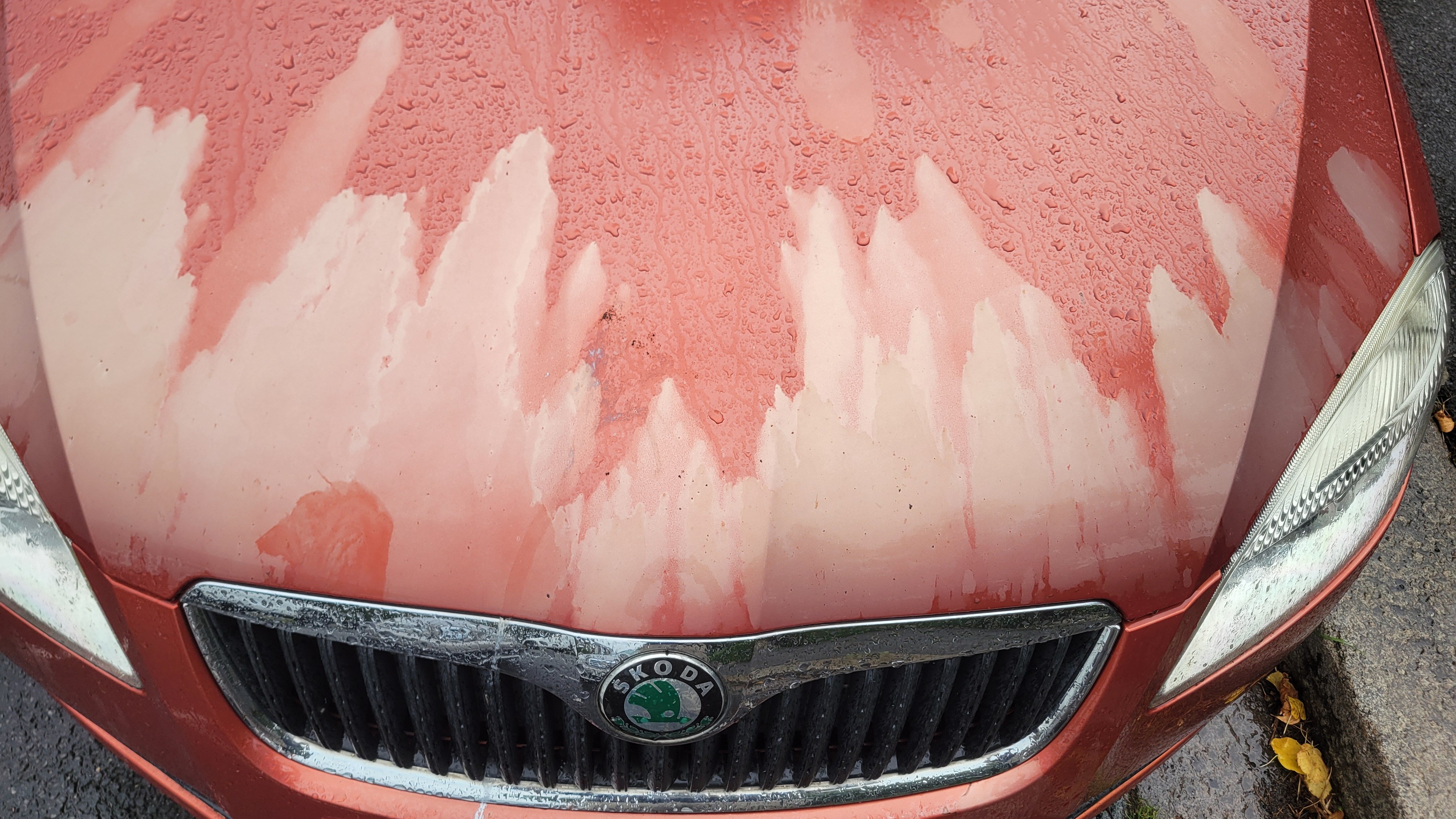

ill send you today my car pictures. be sure my hood is WAY worse then that
Ok!! 🤣🤣
I must ask what the hell happened at the Skoda factory then? All the orange cars from around that period are the same, it seems.🤷‍♂️🤷‍♂️
look at that monstrosity!!! I AM THE KING OF ORANGE PEEL!!!
If you lose any more I reckon you could just apply a clear top coat. Never seen one that bad.
