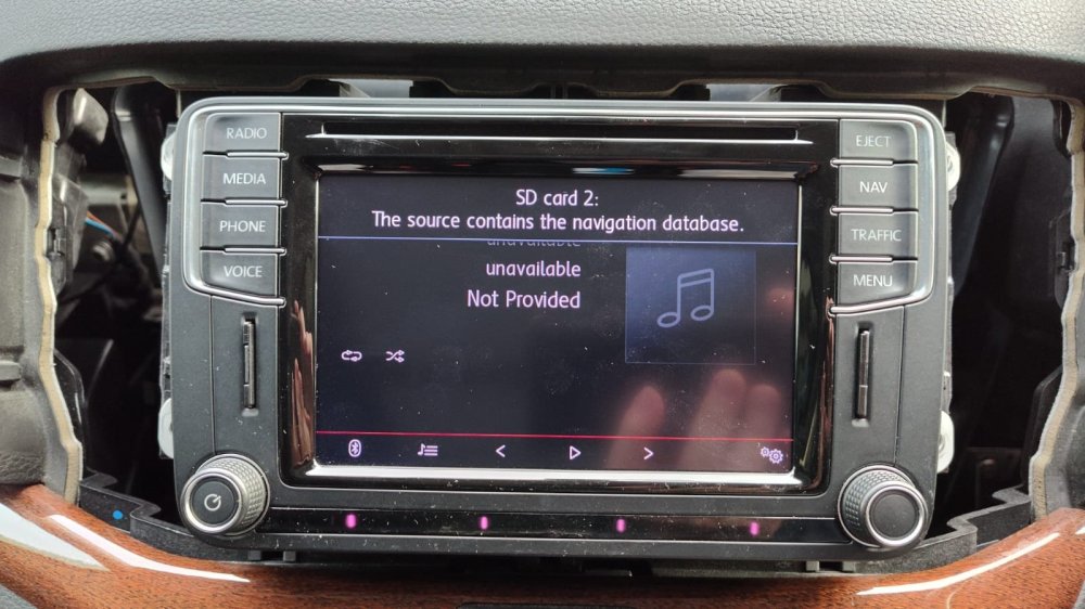

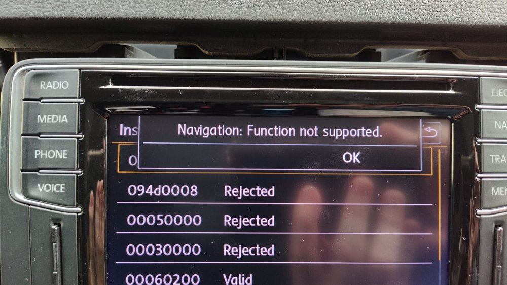

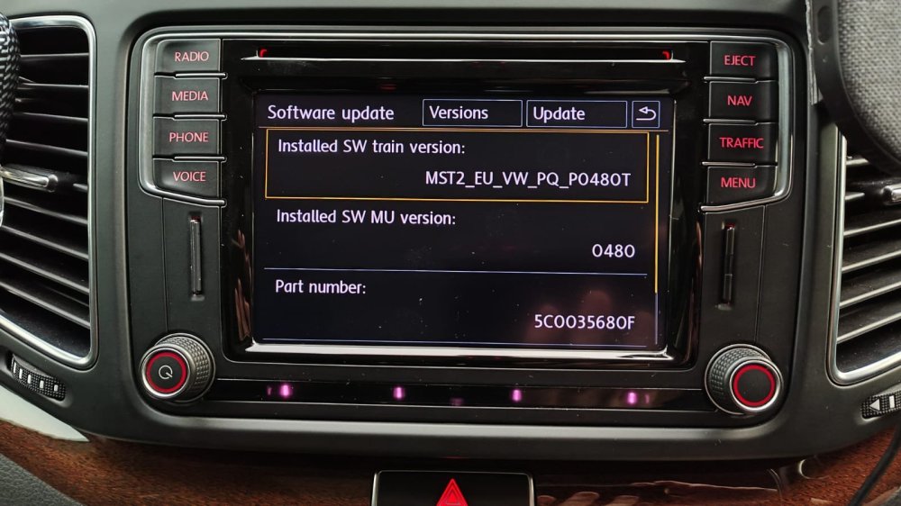

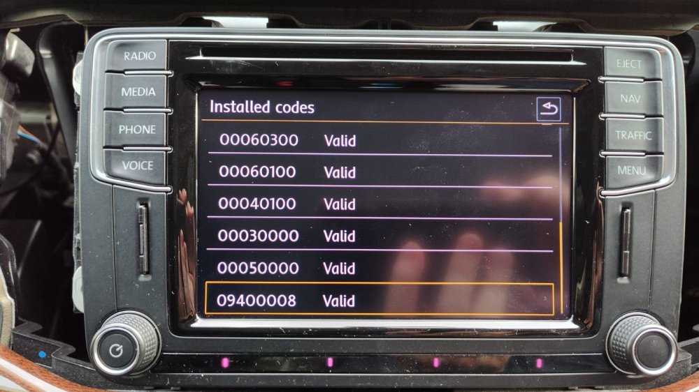

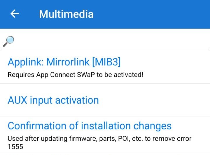

  2. I need help with FEC code for 094d0008. I made a mistake while activating FEC/SWaP code on my 5C0035680F, MST_EU_VW_PQ_P0480T using Car Scanner Pro. I mistakenly clicked on "Confirmation of installation changes" & after restarting the head unit (HU), I encountered an error: Navigation: Function not supported. I also notice the 4 FEC codes changed from Valid to Rejected. When I insert the navigation SD card, the HU recognizes it and confirms with a pop-up message: SD card 2: The source contains the navigation database. Thinking that the Rejected/Invalid codes are causing problems, I removed all Invalid & Rejected FECs but the problem persists. The only thing I'm unsure about is the Navigation FEC. My unit was preloaded with 094d0008 but I cannot find the respective decoded FEC in activate so I activated 09400008 instead. Can someone help me generate the FEC/SWaP code for 094d0008? According to https://mib-helper.com/fec-decoder/?fec=094d0008, it's for RoW. Thanks in advanced!
  3. Does anyone have a link to the MST2_EU_VW_PQ_R0604T firmware? I'm trying to update my MID STD2 with Nav (680B) currently running 0480T.
