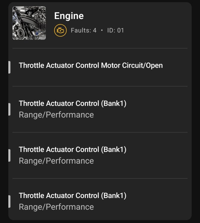

  1. Just for info, I have DNFE 2021 with 77k km, My throttle body just died. I found on the internet 3 cases the same modification of the engine EA888 gen4 with same problem. The car is in limp mode 1500rpm max. Errors are P2101 , P2100 and P0638. I`m waiting new throttle body to be delivered from the local VAG store is 568 euro, 20 euro gasket and four new bolts 1.5 Euro per bolt.
