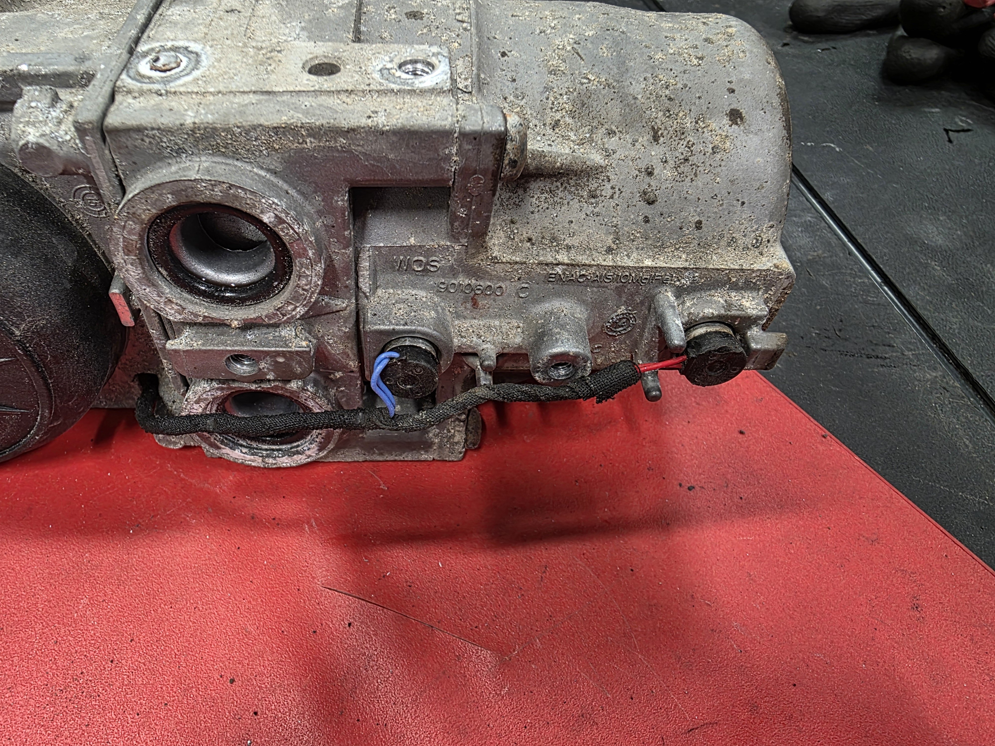

Hi, I had the same fault code and, after some diagnostics, found that I had a faulty overheat sensor.
The one with red wires.

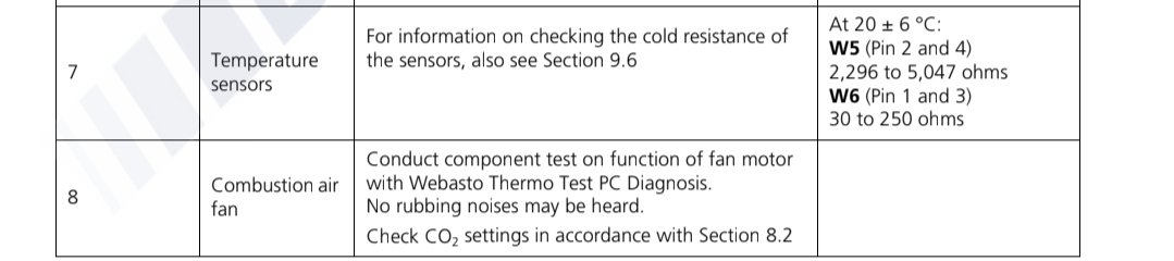

Check overheat sensor reistance

Can you point to me where can I find the whole document?
My octavia have the same fault code, and after looking at the data it shows "overtemp" on outside temperature.
@Mevlan @PronixZero
Sorry for replying that late. I had exactly the same problem as @Stuom . I replaced the temperature sensor (5Q0898047 part number for mine) and now the Webasto works perfectly again. So yes, thanks Mevlan — the temperature sensor was indeed the issue.
I replaced mine as well and it solved the issue.

After this procedure, is it necessary to bleed the system?
I didn’t bleed it properly afterward. I clamped/blocked the hoses, so coolant loss was nearly zero. After the replacement, I topped up the coolant with less than 0.5 L. What I did was run the pump manually via OBD, so the air bubbles were gone when I initially started the system.
