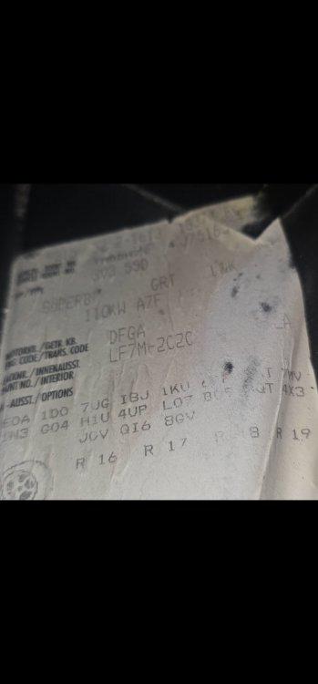

  1. Hi im trying to update my skoda superb 2018 mib unit its got a really old software on it and it starts to glitch and freeze im trying to find a update file if anyone can help mib solutions says mhi2_er_skg13_p526 is latest one
  2. We've tried changing the g to an H however same problem
  3. Probably got the worst luck ever the data stick that has the cars specs engine code etc found it everything is readable apart from you guessed it the 3 letter gearbox code Any suggestions on how or where i can find this gearbox box code the original gearbox seems to have been replaced

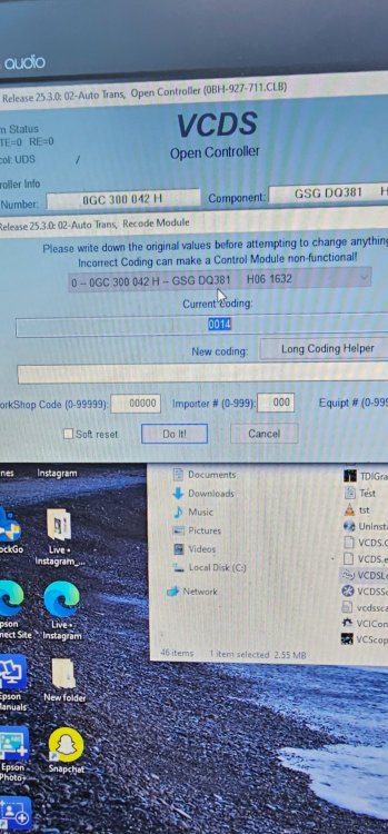

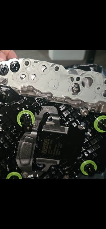

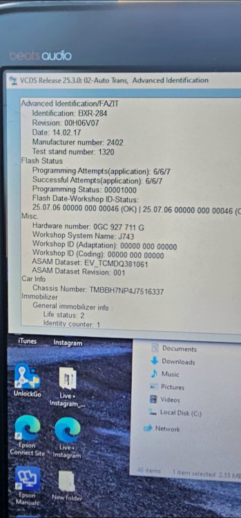

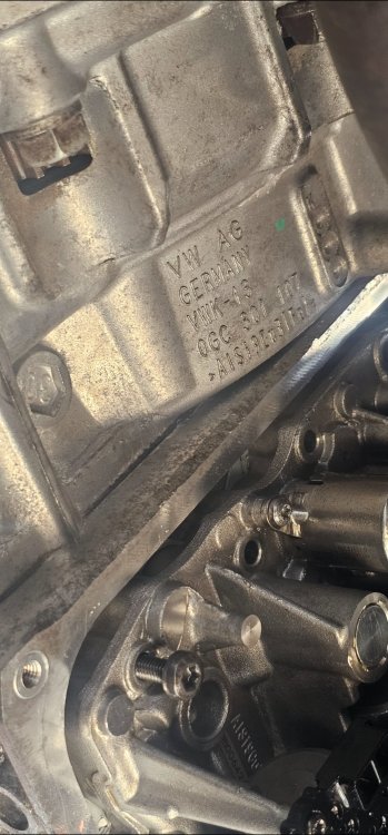

  4. Just a quick update Dsg mechtronic number is 0gc927711h from what I can see this doesn't have a pressue control solenoid D/4 however the 0gc927711g does have it From vcds the hardware number for the mech is 0gc927711g however the one that was in the car was 0gc927711h So I'm thinking the person before either put the wrong one in or the mechtronic is faulty as I've had the mech coded to the car updated flashed etc the software that was currently on it was for the 0gc927711g but the mechtronic was 0gc927711h so I even tried the software for both with no luck As for mechtronic no one really offers warranty/returns if the mechtronic is faulty or for whatever reason it needs to returned Now I'm at point that im either going to have to buy a full gearbox or see if i can source a mechtronic from a trusted place that accepts returns
  5. It's a dq381 2018 skoda superb not too sure if it has wet clutch

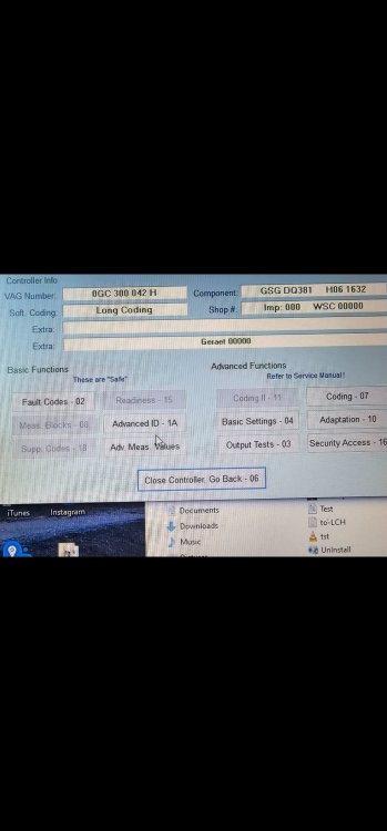

  6. https://youtu.be/DBdbBGhxrtU?si=Zi-GQOaYxpQXfjeI I followed this video to fill the gearbox oil after receiving the mechtronic back Like I said it was done all following the video it's not the first time me doing a dsg oil change Quick recap it was coming up with p271700 pressure control solenoid d intermittent it would stall when put into d/r stay started in p/n I removed mechtronic to send it off to be tested They said it was fully working I asked for unit back they ignored me for 2 days and then rang saying it maybe a software issue After asking around everyone told me to not to go forward with the repair for £502 as it didn't make sense Recived mechtronic back with 4 loose screws and bit of dirt on it Cleaned up mechtronic tightened all the screws and installed back into car Started car to see if I fitted it right the wheels started moving and codes gone then after filling oil codes came back and car started to stall like before me doing touching anything Took oil back out it doesn't stall and p0c2900 code coming up but comes and goes That's where I'm at now oil been drained the car starts and doesn't stall and tyres move Like I said before it was only started 5 to 10 seconds maybe even less
