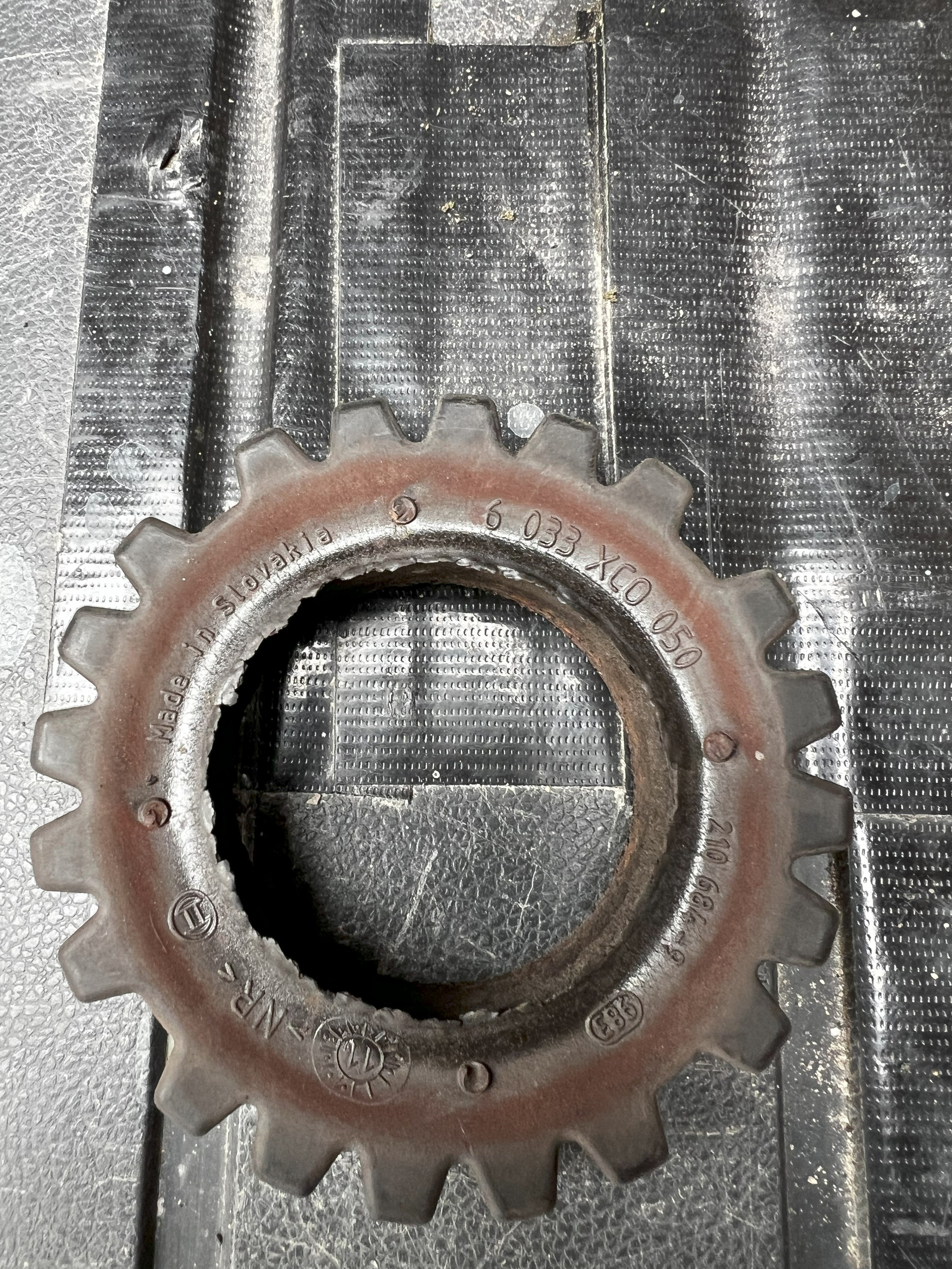

Update on the problem which still hasn't been resolved. Took the wheel arch liner off to check for any obvious damage and found this wierd gear type thing on the undertray beneath the sump. It's made of rubber and seems like it has come out of the A/C compressor pully. No other damage found. Any idea where I can get a new pulley/clutch? Car still not starting for any length of time but also need to sort this now.
