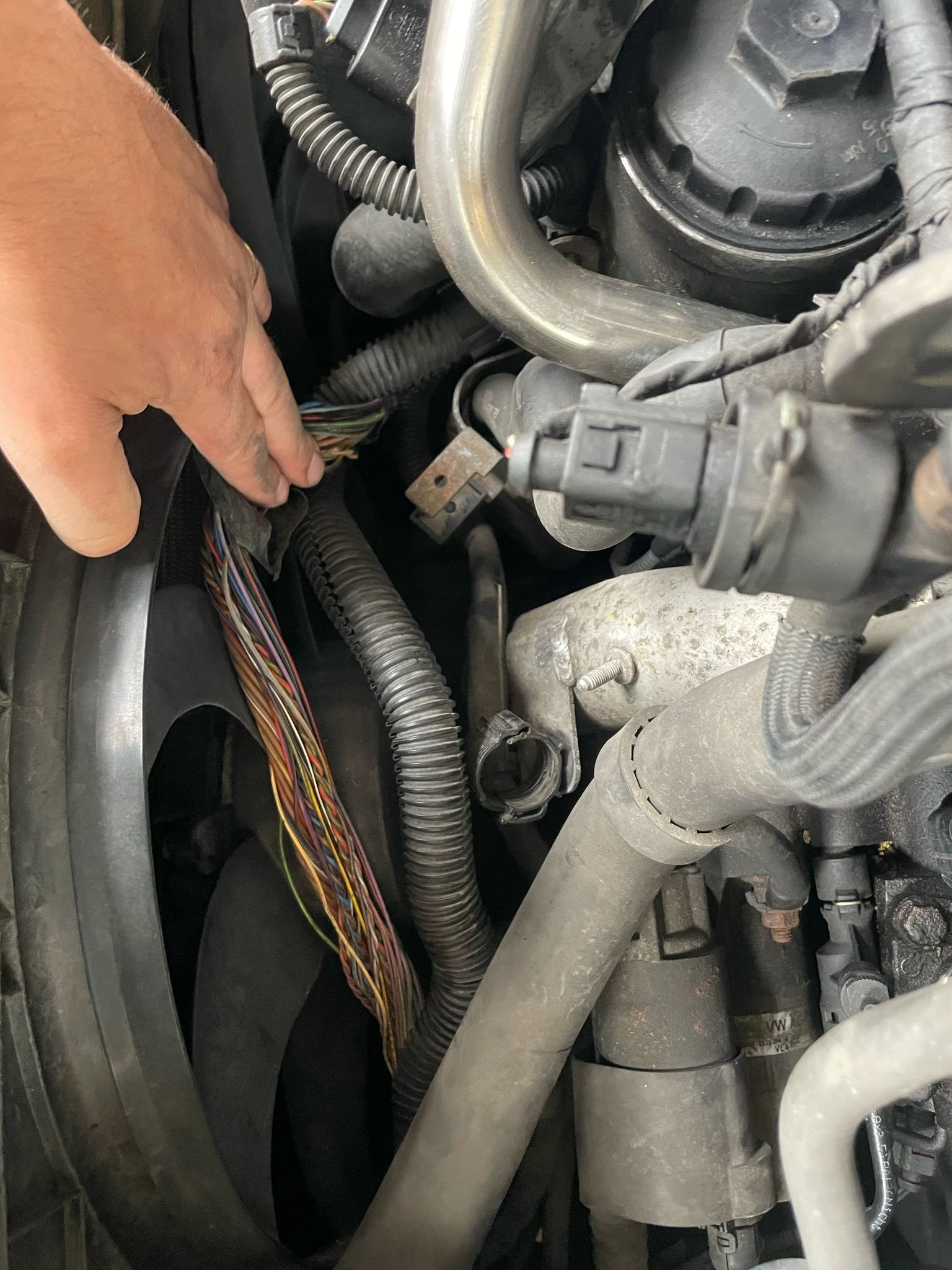

  1. Problem solved! Thank you all for your help!

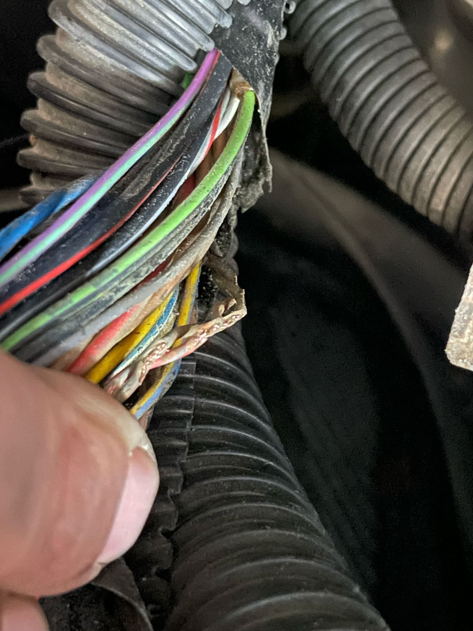

  2. Error seems to be found. Damaged wiring. Colors of wiring fit to sensor wiring. Seems to happen quite often exactly in this spot. I'm going to repair it and will give feedback
  3. Thanks a lot Pete!! Yes, I noticed that the loom plug was a little bit wet. But maybe it got wet while disassembling, because I dismounted the sensor from the pipe with the plug still mounted on the sensor.....
