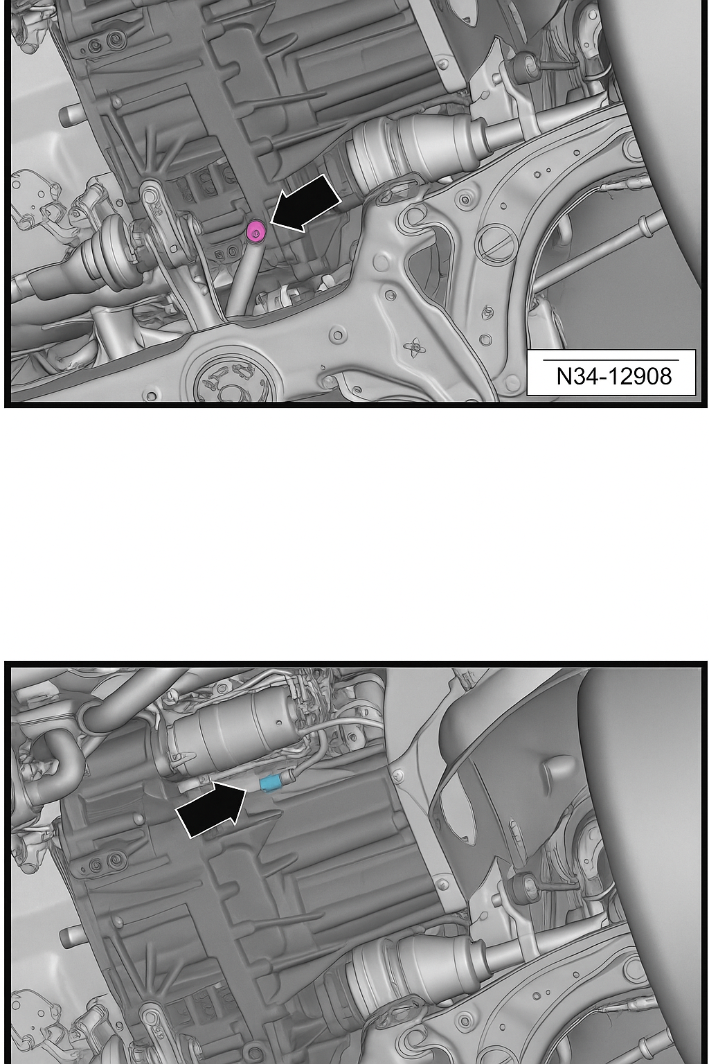

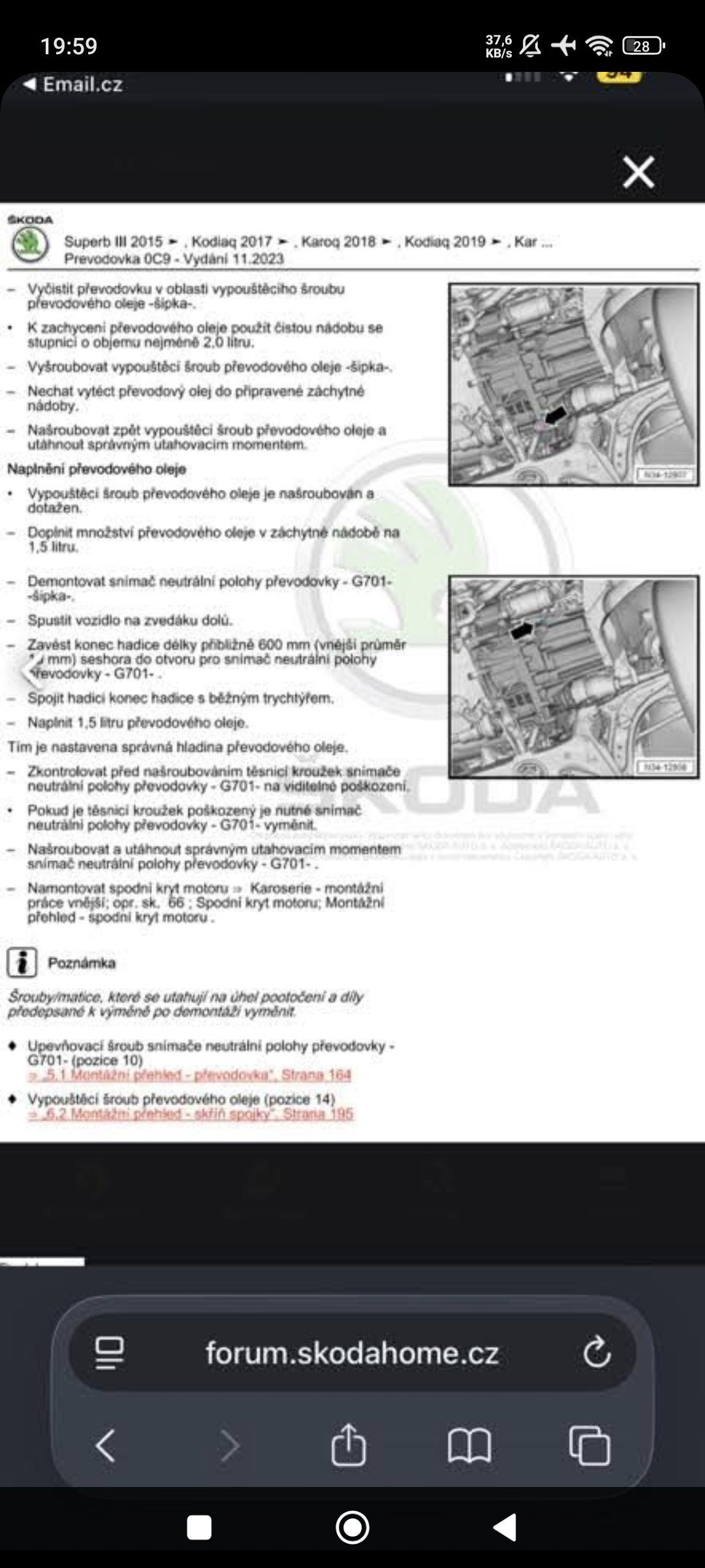

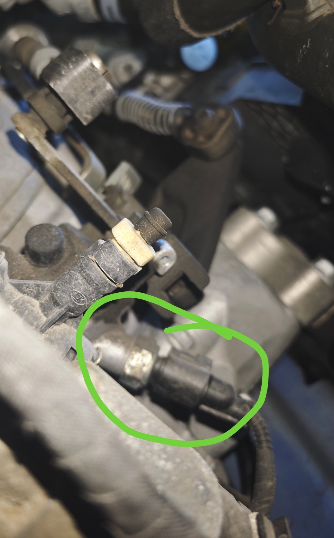

  4. Here is photo from gearbox fill switch
  5. If you have this gearbox you fill oil with hole from this switch
  6. Hi i need change oil on mi 1.5tsi 110kw 6speed manual gearbox but is true that fill in place is hole from reverse light switch?
