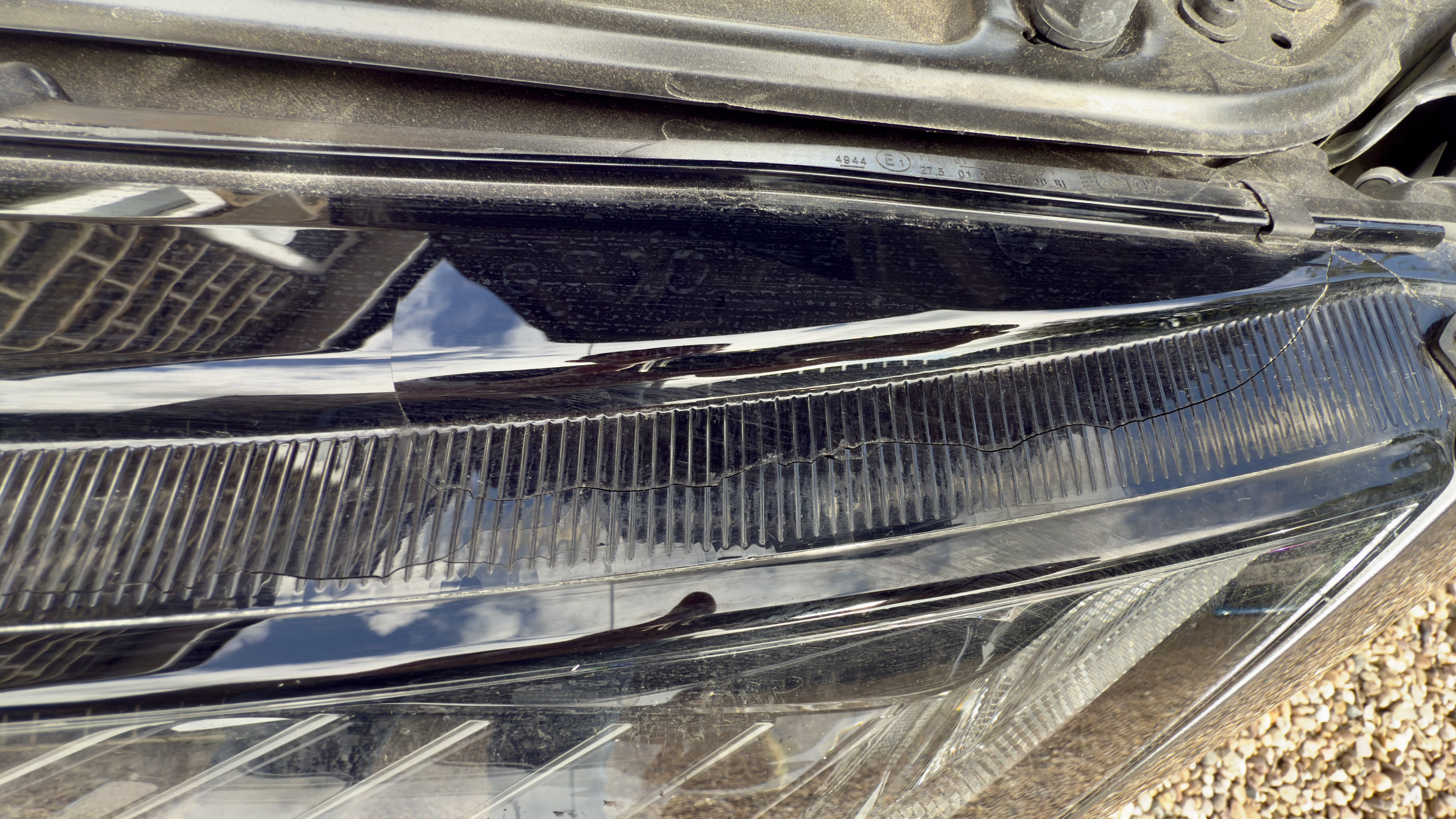

Driver’s side headlight. The crack runs mostly along the ‘corrugated’ section.

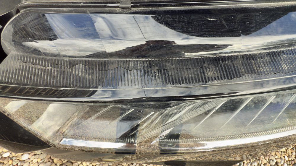

Passenger side.

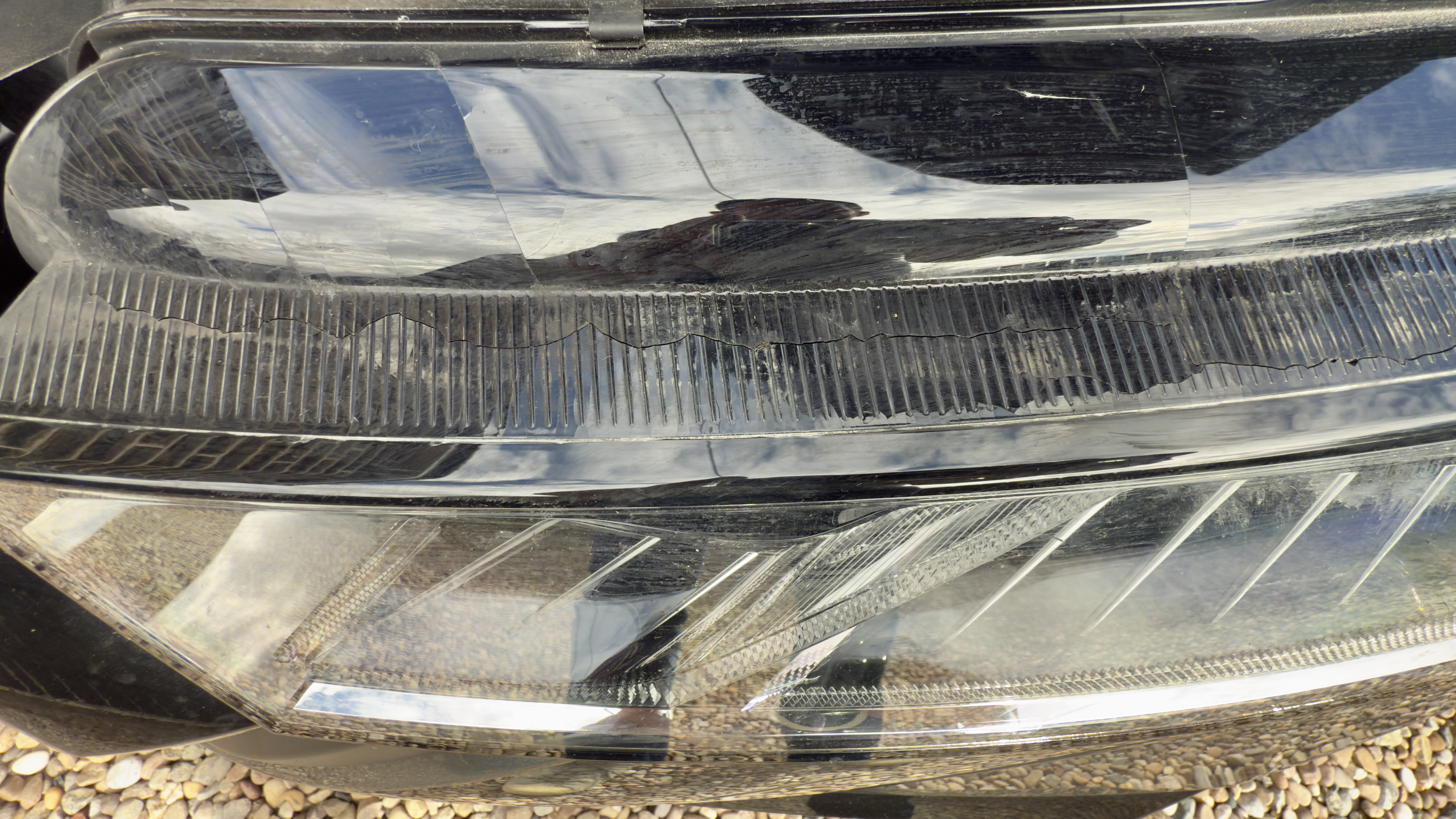

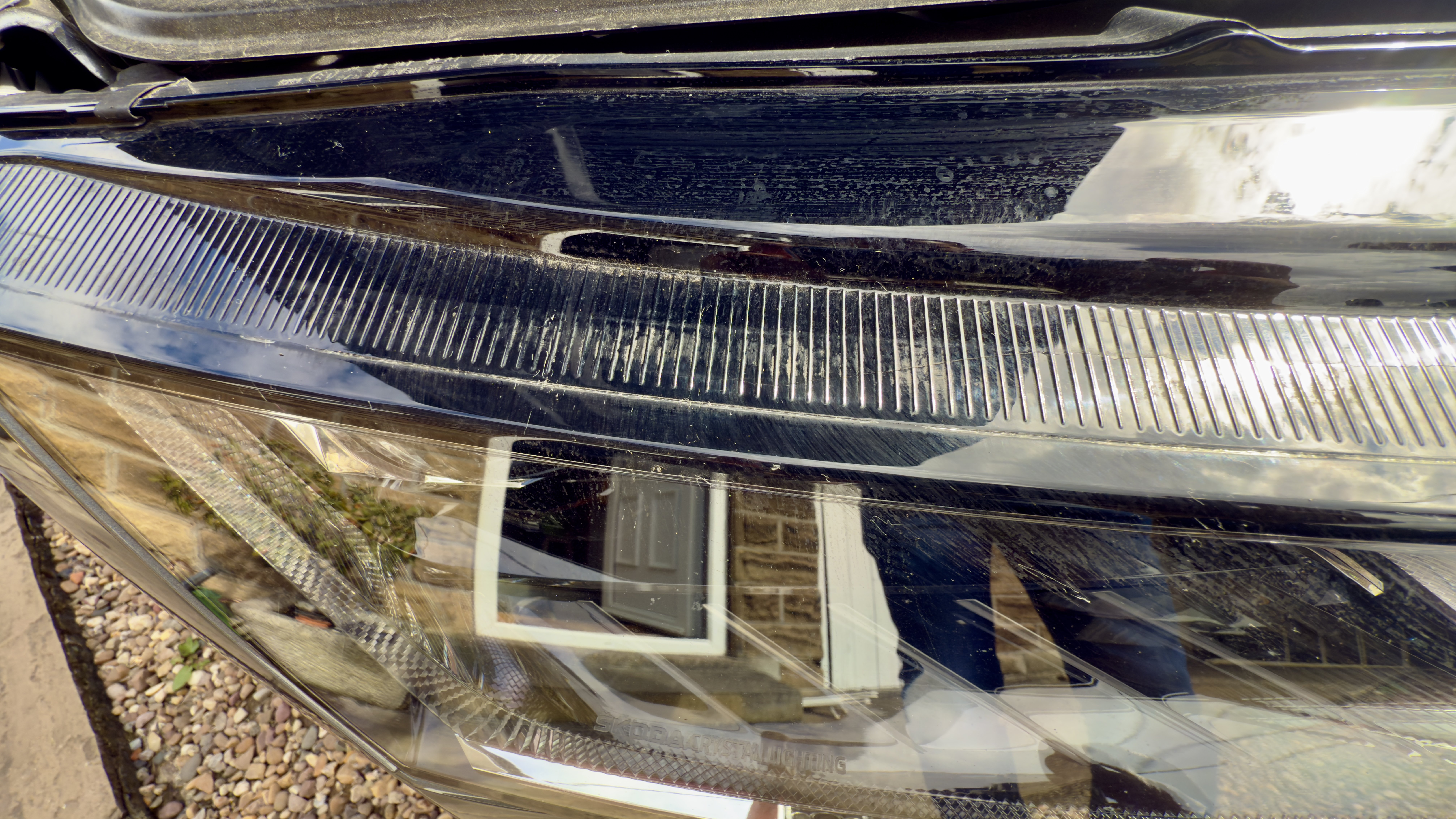

Any more luck with this?? I’m experiencing the same issue with my Mk IV Octavia VRS, looks like an identical fault, but the local dealer is saying that it’s damaged and therefore not covered under Warranty! Although they even admitted in the workshop that they couldn’t find any signs of damage anywhere else and therefore couldn’t explain the cracks in the casings!! They even used a paint thickness gauge in-front of me which obviously showed no anomalies as if they were expecting to find that it had been damaged and resprayed!
Waiting for them to get back to me and attached images for reference below.
