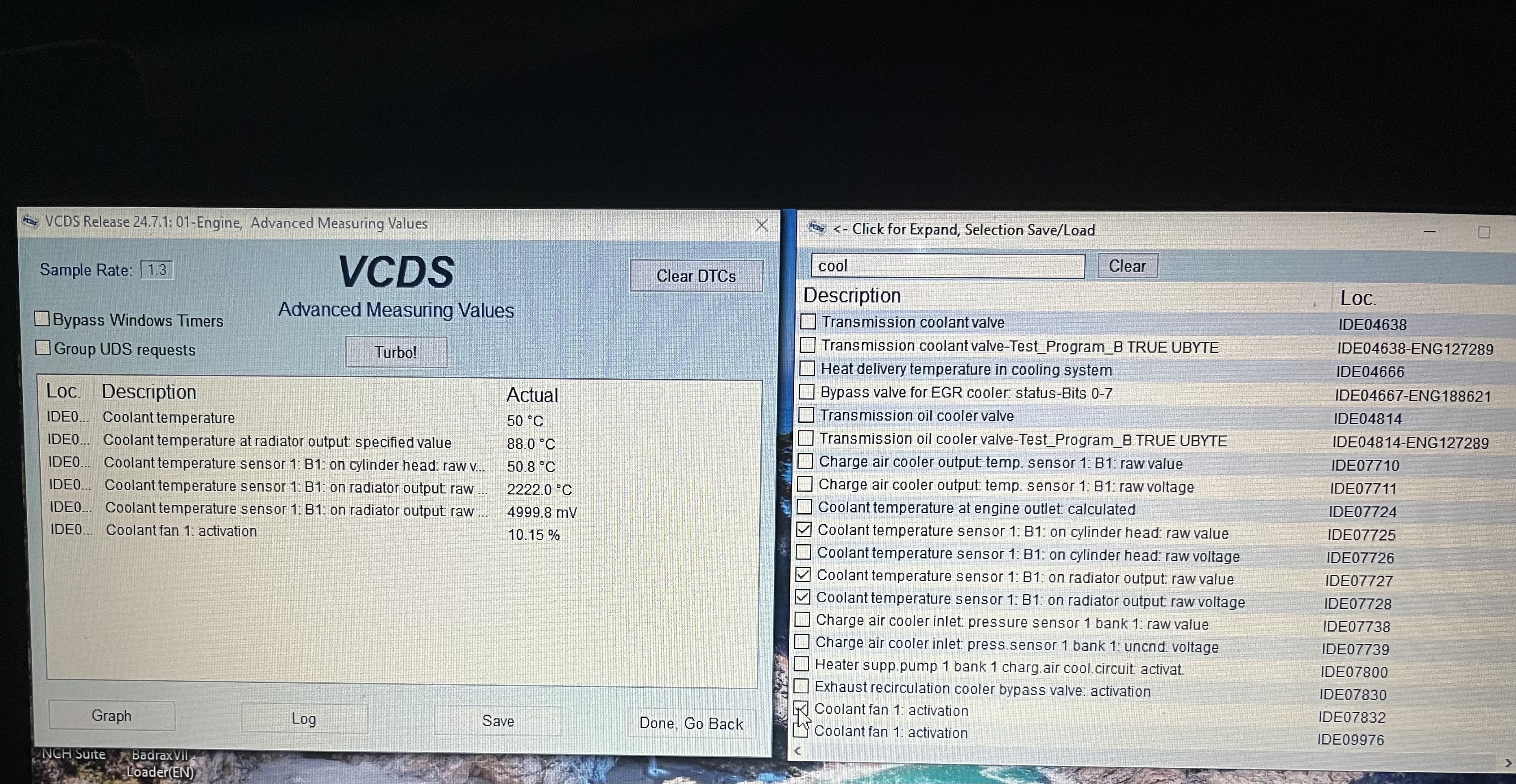

  7. But should the ECU use both temperature sensors to control the radiator fan, or only the G62? In the attachment you’ll find a CSV file with the measurements I took. In the table you can see that when the coolant temperature reaches about 110 °C, the cooling fan only runs at around 10–15%. At 110 °C the coolant gauge on the dashboard already shows a value above 90 °C. LOG-01-IDE00025_&7.CSV
  8. But in my case, if the sensor were not physically installed, then the value for G83 should change and not always stay fixed at 88°C, assuming the ECU is just calculating this value. That means there must actually be a physical G83 sensor 😅
  9. The pump cannot be stuck, because I installed a non-electric pump. These non-electric pumps were used in older cars, such as 2010 VW models. Even before I replaced the pump, the car already had the same temperature problem. This means that changing the pump did not change the behavior 😐
  10. My first idea was to replace the sensor myself, but I couldn’t find its exact location. In the end, I will have to go to a repair shop and let them replace the sensor. I hope this will solve the issue. If not, I would consider replacing the thermostat, since it might be faulty and not opening correctly.
  11. In the picture below, I can select the sensor “Coolant temperature sensor at radiator output”. That should be the G83 sensor. What do you mean by replacing the G62 sensor with a genuine sensor?

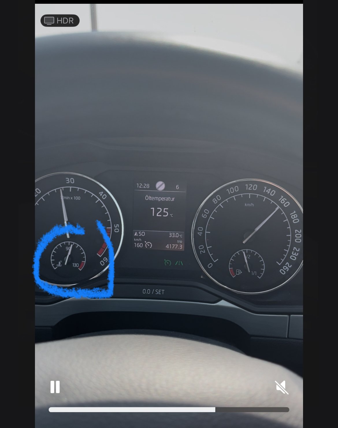

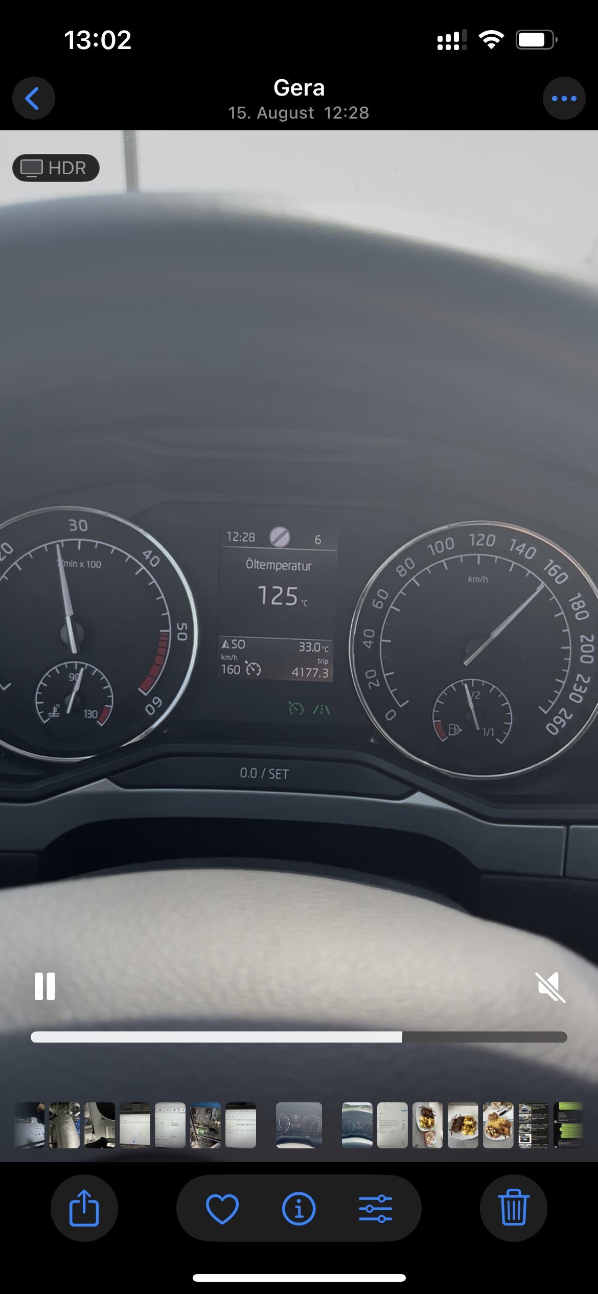

  13. Hi, the oil temperature is 125 degrees. You see in the below picture in blue circle that the cooling temperature has pass 90 degrees. It goes further if i press the gas pedal
