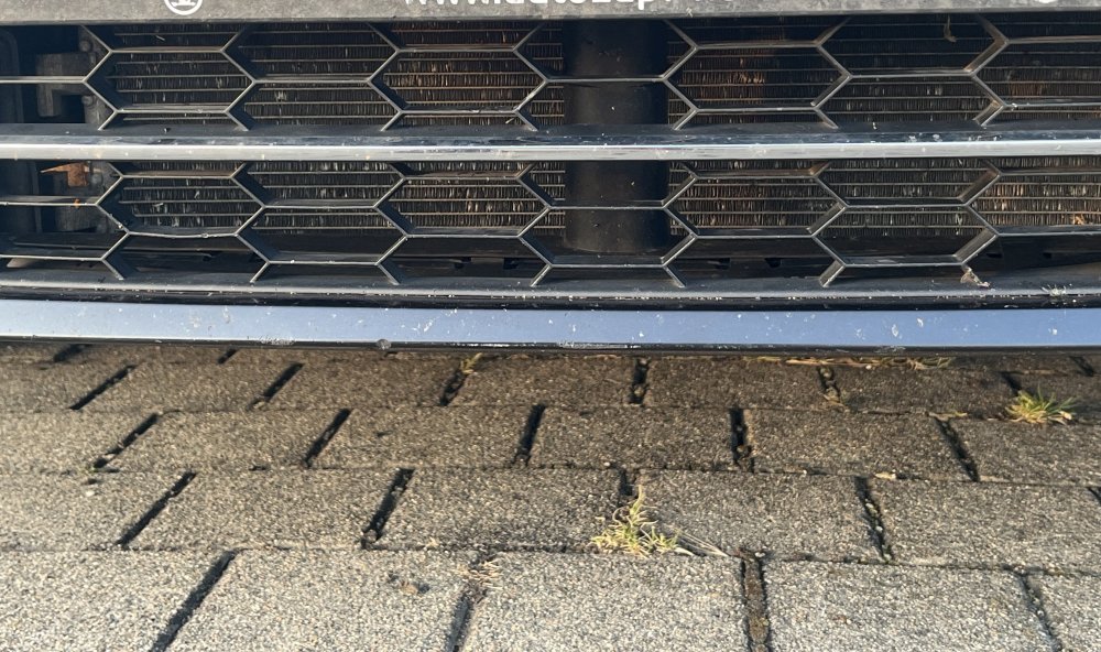

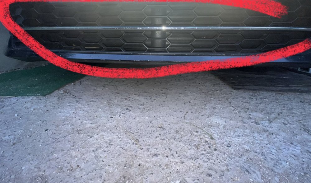

Brothers from the Skoda Superb Facebook group in Turkey solved my problem.
The problem was the lower bumper grille shutters. They were stuck.
I removed the shutters, and now the coolant temperature no longer rises above 90°C under normal driving conditions. It reaches a maximum of 100°C when I drive at 230 km/h with an outside temperature of 26°C.
The oil temperature is still quite high, but I think this is either a different issue or simply normal for these cars.
Best regards
