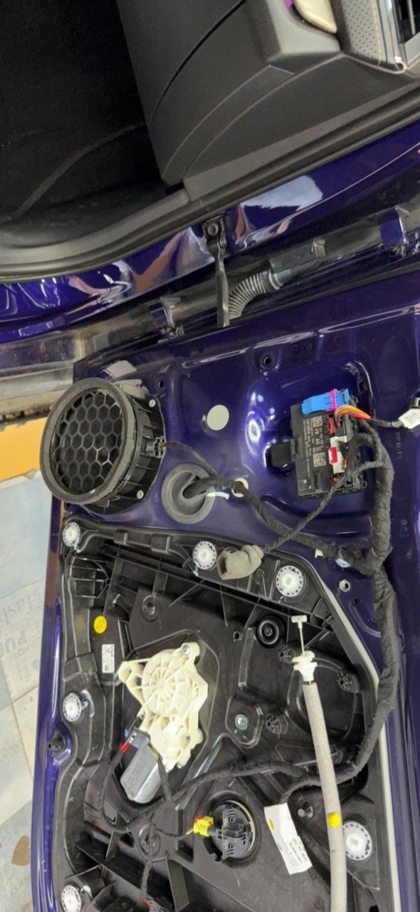

I checked my car door. I think the terminal wires must be connected to this large black module, but there are four small plugs on it. I'm not sure. From left to right, there are two thicker white wires connected to a black plug, but it looks like a power cord to me. It can't be this. The second one is a large white plug with a red cap, which is obviously not it. Then there is a small black plug with a small red cap. Is this it? Finally, there is this large blue plug.

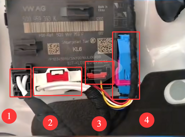

Thank you for the clarification about the black connector. I'm sorry, but I'm still not 100% sure which specific black connector you are referring to on the control unit. To make it easier, I have uploaded a picture of my door control unit with the possible connectors numbered. [Please imagine the attached picture here with numbers on the connectors] Could you please take a look at the picture and tell me which number corresponds to the correct black connector I should use? For example, is it connector #1, #2, etc.? This would help me tremendously and prevent me from connecting to the wrong one. Thank you so much for your patience and help!

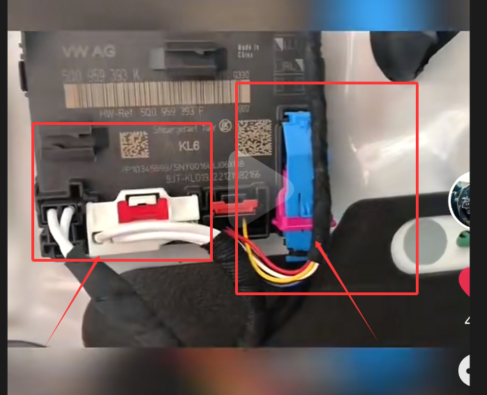

Thank you for the information! However, I'm having a little trouble understanding the specifics. Could you please help clarify? You mentioned "Unit 42, Connector T16C, Pin 1". My main questions are: 1. Does this mean I need to connect the positive or the negative wire from my new puddle light to this pin? 2. I only see two main connectors on my door control unit: one with a blue housing and another smaller one with red/white housing. Is T16C one of these? If so, which one? Could it be the blue one or the red/white one? I apologize for the basic questions; I am not very familiar with the professional terminology. Thank you again for your patience and help!

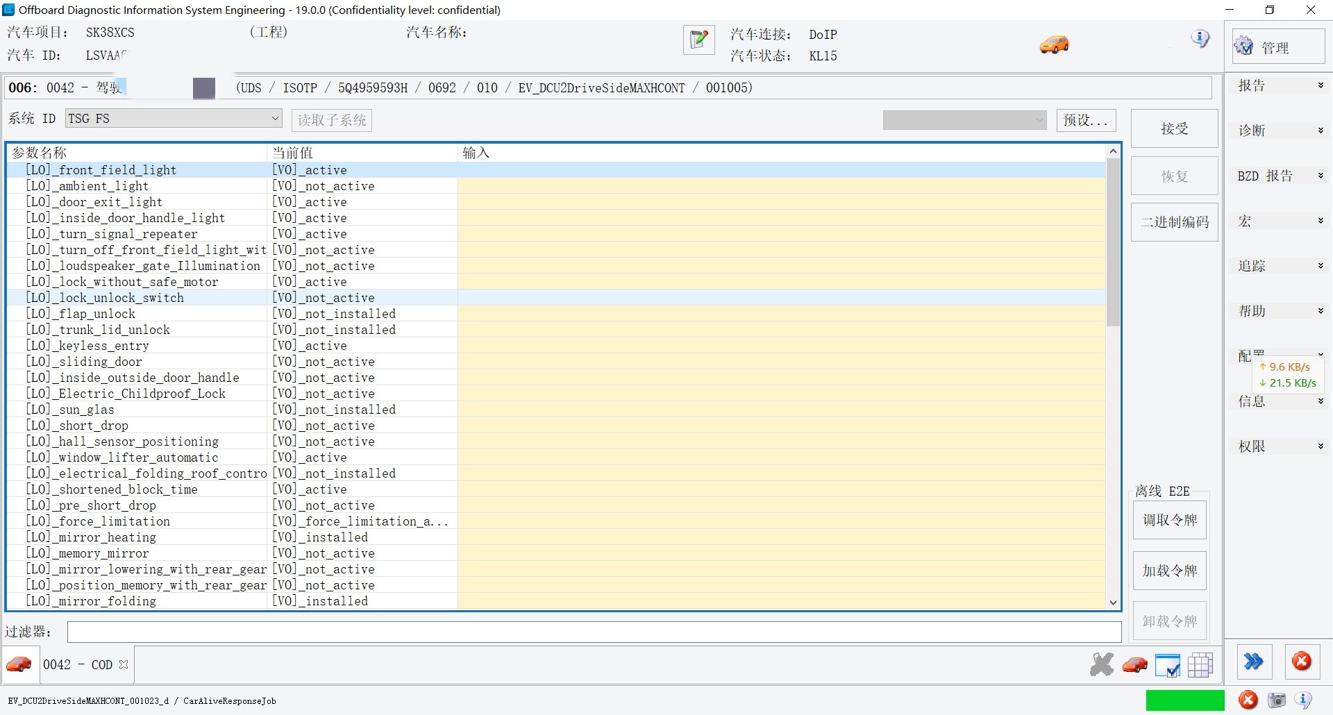

斯柯达明锐Pro照地灯改装问题求助 Help Request for Skoda Octavia Pro Puddle Light Retrofit Issue 我来自中国,在我的斯柯达明锐Pro(MQB Evo平台)(也就是MK4)上改装照地灯时遇到了问题,急需各位专家的帮助。 I am from China and I am encountering an issue while retrofitting puddle lights on my Skoda Octavia Pro (MQB Evo platform, also known as MK4). I urgently need help from experts. 问题现象: Problem Description: 改装的LED投影照地灯仅在车辆通电时或刚熄火时工作正常。当车辆锁车进入休眠状态后,无论是解锁还是直接开门,灯均不亮。 The retrofitted LED projection puddle lights only work normally when the vehicle's ignition is on or immediately after turning it off. After the vehicle is locked and enters sleep mode, the lights do not illuminate upon unlocking or opening the doors. 我已进行的操作和当前接线(关键信息): Actions Taken and Current Wiring (Key Information): 1. 编码:我已成功在驾驶员车门控制单元(地址码42)中激活了door_exit_light(车门照地灯)选项。启用/禁用该选项可以控制灯(仅在通电时亮),证明编码有效。 1. Coding: I have successfully activated the door_exit_light option in the Driver's Door Control Unit (Address 42). Enabling/disabling this option controls the lights (they only light up when the ignition is on), confirming that the coding is effective. 2. 物理接线:这是我目前的接线方式,也是问题的核心: 2. Physical Wiring: This is my current wiring setup, which is the core of the problem: · 正极(+):接在大的蓝色插头的16号针脚(见附图参考)。 Positive (+): Connected to Pin 16 of the larger blue connector (see attached image for reference). · 负极(-)/控制线:接在蓝色插头旁边较小的红白色插头的7号针脚(见附图)。没有按照官方文档接白色插头的5号针脚,是因为本地论坛有人建议接这里,可以避免破线。 Negative (-) / Control Wire: Connected to Pin 7 of the smaller red/white connector next to the blue connector (see attached image). The reason for not following the official documentation to connect to Pin 5 of the white connector was advice from a local forum suggesting this alternative to avoid damaging the wiring. 我的分析和疑问: Analysis and Questions: 1. 我不确定出现车辆休眠后门灯无法激活的现象是否是负极没有接在5号针脚。 1. I am unsure whether the issue of the puddle lights not activating after the vehicle enters sleep mode is due to the negative wire not being connected to Pin 5. 2. 如果确认接线存在问题,硬件上重新接线是否是唯一的解决办法?我是否必须把负极线改接到白色插头的5号针脚,亦或者正确的接线方式应该是如何? 2. If the wiring is confirmed to be the problem, is rewiring the only solution? Must I reconnect the negative wire to Pin 5 of the white connector, or what is the correct wiring method? 3. 如果必须重新接线,能否在不退掉白色插头5号针脚上原厂线的情况下并联接入?或者是否有其他替代方案? 3. If rewiring is necessary, is it possible to connect the wire in parallel without removing the original factory wire from Pin 5 of the white connector? Are there any alternative solutions? 4. 如果有可能,我非常想避免再次拆装车门,是否能有不重新接线的情况下,直接编程让车辆在解锁状态下恢复模块供电的方案? 4. If possible, I would very much like to avoid disassembling the door again. Is there a way to reprogram the vehicle to restore power to the module upon unlocking without rewiring? 任何确切的电路图或相关的改装经验都将是我的救命稻草!非常感谢! Any precise circuit diagrams or related experiences would be greatly appreciated! Thank you very much!
