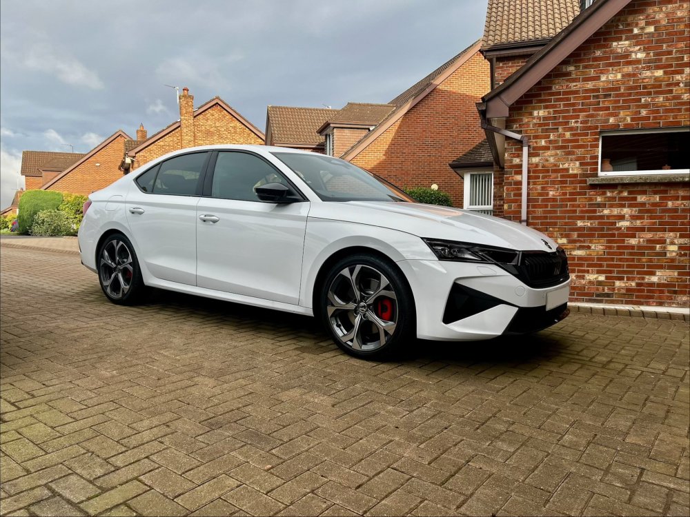

  13. Thought I might chime in here for a first post. Just took delivery of a Moon White mk 4.5 vRS hatch today. For context my 2 previous cars were a mk 3 Octavia vRS hatch and until today a mk 3.5 Superb L&K hatch. Extremely raw initial thoughts... I love the look of the new car. The Superb was probably the best care I ever owned but the styling, whilst I liked it for what it was, was a bit too sensible middle aged man for my liking -- I'm not quite there yet. So nice to be back in something that's a bit more exciting if still a sensible. I've ordered bolt covers and center caps for the wheels. The aero covers are out of here ASAP. New car excitement notwithstanding, I have to say the Octavia feels like a surprisingly big step down from the Superb, but that could be more to do with my spec than anything else. And I should note that I expect it to be a step down as it is the little brother after all. Guess I'm just surprised how much it feels like a step down in some regards. Some immediate downsides. Road noise is kind of wild. To be somewhat expected but I was surprised to see both cars were on the same profile of tyre. So it's all coming from a lack of insulation I guess. Lack of space. That roughly 15cm difference in length makes way more of a difference in the interior than it looks from the exterior. The Octavia is often talked about being a spacious car for the segment, and no doubt it is, but it appears I didn't appreciate how cavernous the Superb was. Fit and finish. A few cheap outs like no LED lighting in the rear and cheaper plastics here and there. The fabric for the seats is honestly kind of tragic -- I do believe in other markets there is half leather option for the vRS which for some reason I couldn't spec in the UK? Anyway, big step down from the all leather in the Superb. Comfort and ride. Not even in the same league honestly but this is the vRS so I can forgive it. I imagine the DCC would make a huge difference. My L&K did have DCC but I honestly stopped using anything other than the normal mode after like the first month. Virtual cockpit. Unless I'm missing something the customisation of this seems way more limited than the old software. It's kind of silly honestly. The Canton sound system in the Superb was much better than than the standard one here. Was instantly noticeable. I was sort of hoping I'd hardly be able to tell TBH -- interestingly though the likes of the reverse sensor chimes etc feel a lot clearer / pronounced in the new car. Lack of electrically adjustable seats. Again, maybe I'm wrong, but these don't seem to be available in the UK on vRS yet are elsewhere? Lack of ventilated seats. I just loved these. used them more than the heating despite living in the UK. Functionality buried in the infotainment. Absolute head scratcher but a wider industry issue, I know. I see the new Superb and Kodiak have brought back some dials so hopefully that is being corrected more broadly. Lack of integrated sun blinds. Some immediate upsides. These are mostly king of moot since they exist by virtue of the car just being newer but still upsides to me all the same. Proximity on top of the standard keyless entry. Just another great little QOL feature. ACC. This might be a spec thing but my Superb just had standard ACC where you set the speed and it will adapt to the vehicle in front. This newer version adapting for speed limits etc is great. Just set and forget. No more manual adjustments. Despite the fact, as noted, so much is now unnecessarily buried in the infotainment screen, the new screen is miles better. Wireless charging. This is purely a spec issue. I ordered my Superb right at the factory tooling switchover time. Which weirdly meant in the dealership when I specced the car I had to do so as a pre facelift despite knowing the car I would get would be the mk 3.5. So I couldn't option this feature but I love having it now. Performance. The Superb was perfectly performant for what it was -- 190ps I think -- but this vRS is definitely keen to go. Styling. I just love it honestly. I see all the love GTIs etc get but I've just always loved the Octavia vRS. Still love the mk 3 when I see them. I'm probably being a bit harsh. Like I said, I'm not really comparing apples to apples. But yeah, slightly disappointed that the Octavia isn't closer in quality. Particularly given the price! For context, in 2020 my L&K was just shy of 40K and came fully loaded. Today the vRS is the same price. Ultimately I opted for the vRS because I do really love how it looks and I wasn't prepared to pay the even more ludicrous monthly payment for the new Superb -- which looks like a great car honestly. Some obvious notes for fairness. The Octavia could have faired better in comparison. DCC is an option and would probably improve the ride considerably. Likewise I miss my Canton sound system and heated steering wheel, but again, the options are there. Some notes of bafflement -- correct me if I'm wrong. Not that I could justify any additional options on top of the base price but... No UK options for half leather and or electric sports seats? Surely these were available at some point? No sun blinds options? Can't throw in a heated steering wheel for the base price? Anyway, that feels like a lot of negativity. If I wasn't comparing this directly to a top spec Superb that I absolutely loved driving for 5 years -- which again, is not fair -- I don't think I'd have too many complaints. Excited to see how I get on with it.
