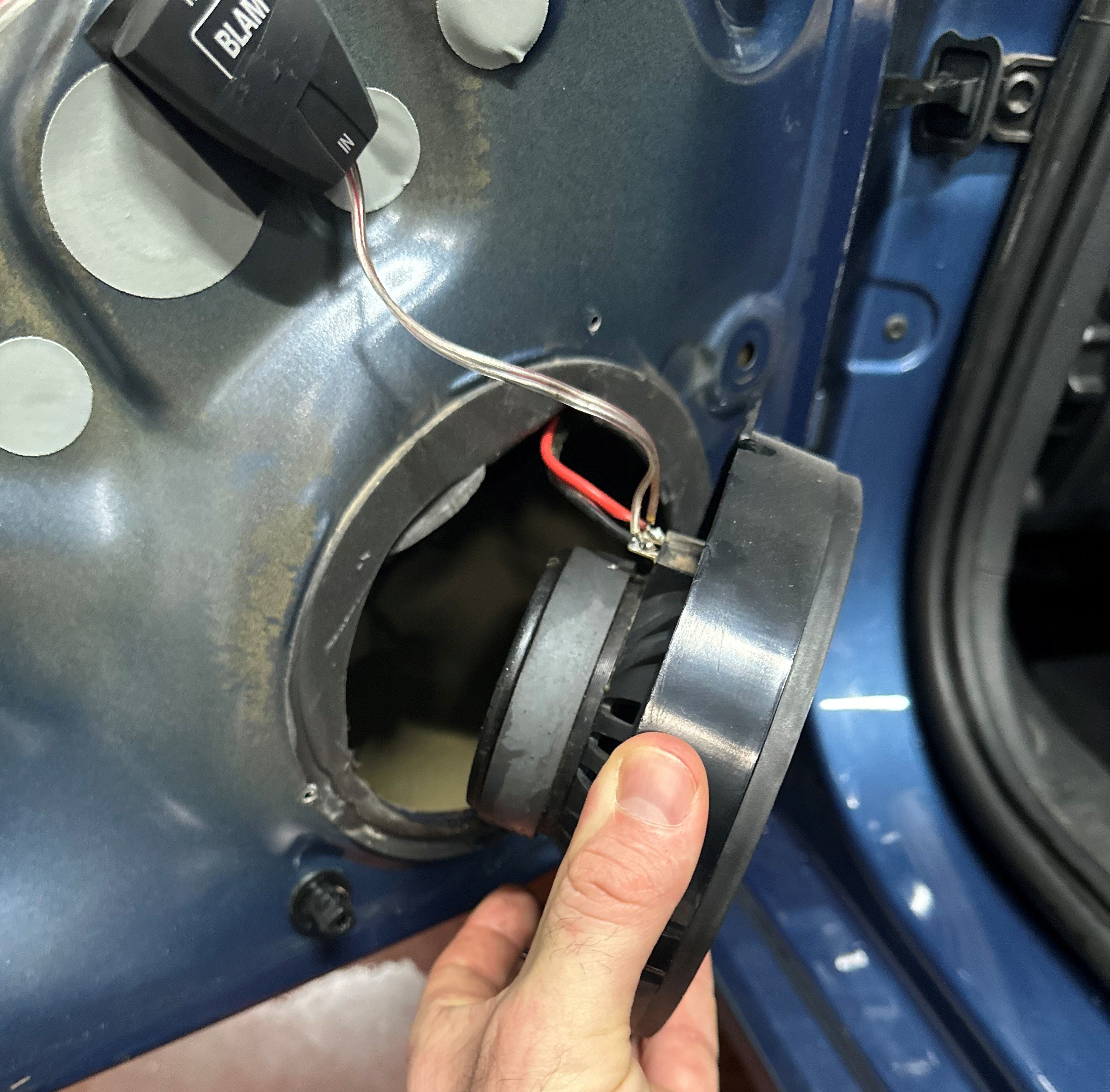

  2. I just called the car modification company. According to the guy in charge: yes, some water could enter the door of course, but never up to the level of the loud speaker. The problem started after 4 watering cans which might mean that the level of water rises up within the door before it reaches the speaker, which of course can not retain so much water. it is either a misconception of the car (too much water getting in OR not enough weep holes) or the weep holes are stuck with something (but they don't seem to). Still, he offers that I bring the car, and check with the technician what to do after door trim removal and analysis. They even offered to drill more weep holes. They have great Google reviews, I have no doubt they'll make a good and clean job. And I can stay with them the whole time, which was not possible with Skoda as they clearly refused to let me stay (I didn't like that, it is clear lack of transparency and let to the situation where they didn't do the "water" test. They just removed the trim and decided the problem was because of the non-origin speaker ie. not from them.) Appointment is taken for Oct. 4th... Stay tuned 😉
  3. Here is how it looks like (photo from Skoda). They say there is no seal, only a kind of foam tape that they claim is not enough to prevent water to get in. Also, see the screw holes they made in the body to fix the speaker. 😱My concern is that I dont have any video to prove the speakers are the root cause. Also I'm wondering : we threw 4 watering cans before it leaked. It might mean that water rises up into the door, until it reaches the speaker, and it passes the tape to the interior. Is water supposed to reach that high? Can it mean that weep holes are not draining fast enough?
  4. Hi everyone, Skoda garage just called, car body team has identified where the leak is... and it is because of rear speakers... ☹️ I'll post the pic when I get it from them. Skoda says they can't do anything for this issue (I guess because they didn't do the installation), except removing the speakers and put a original (and waterproof) shutter instead. Tomorrow I will call the guys who had mounted the speakers on the car 4 years ago. Their installation is far from being correct if water gets in! Pretty mad at them... 🤬

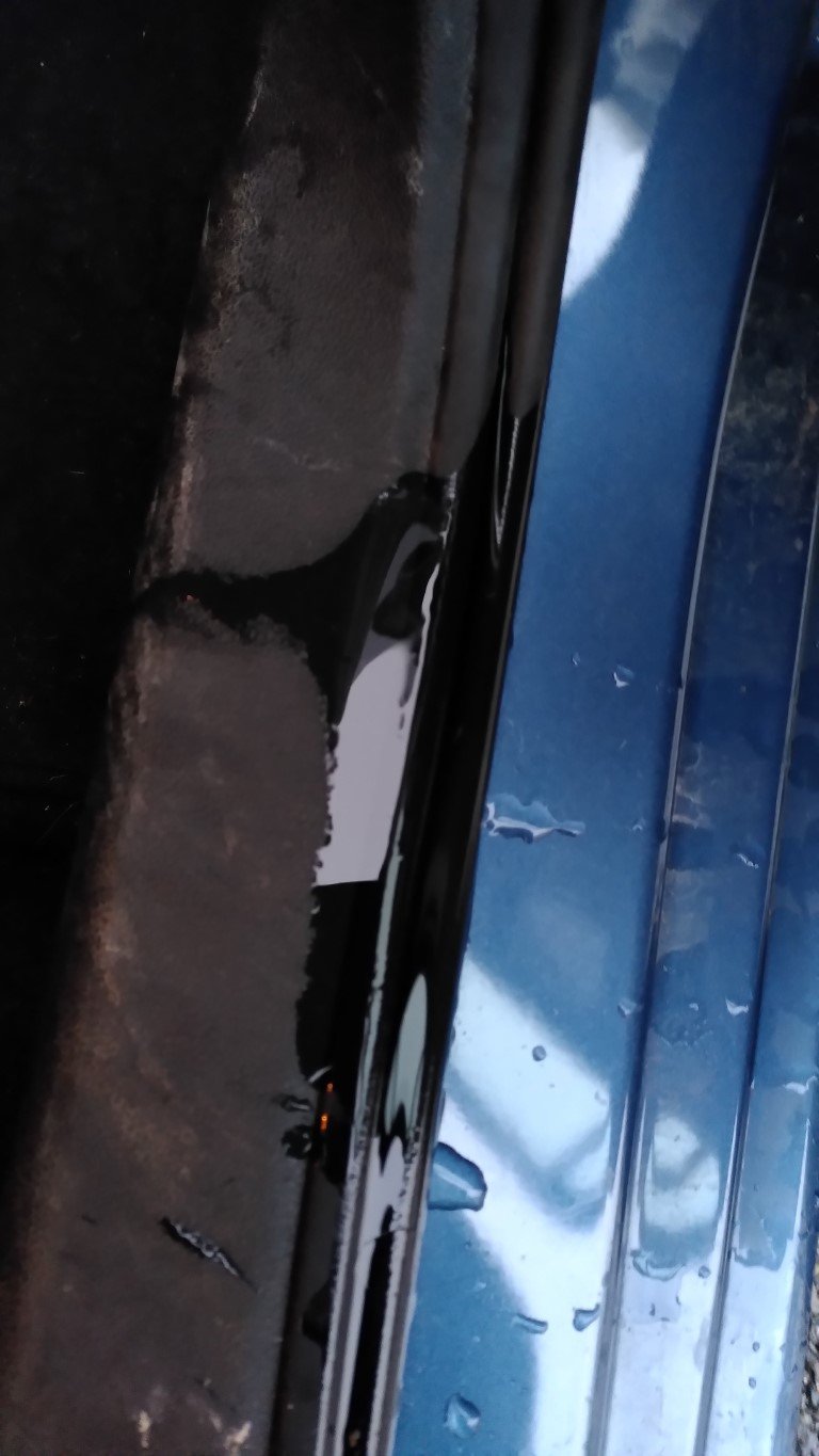

  5. When we did the open door test, I could not see water going out that "join" between the trim and the metal. You might be right but that's not obvious to me. When the door is closed, as the water rises until it passes the inner join, everything down there is wet so it is complicated to see where the leak is. I'm clearly not tempted to remove the trim, as I dont know how to do that and I am afraid I would break some clip or anything else. I prefer that Skoda does it

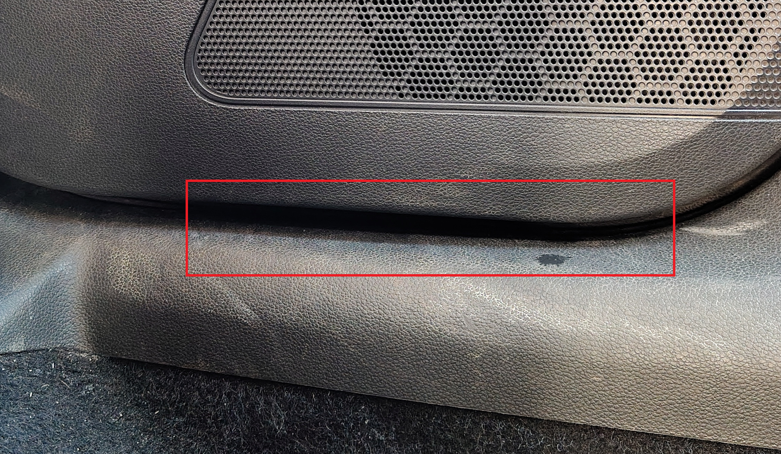

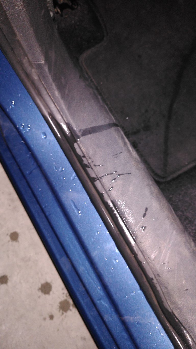

  6. Hi, I made a few tests today, with the help of a neighbor. First, sweep holes don't seem to be blocked by wax or anything else. Then he threw 4 10-liter watering cans in a row over the window. I was inside , monitoring what's going on from the inside. I carefully looked at this zone in red. In the very back, I could see the blue body of the car. During the 4th watering can, I started to see some water in the zone where the body is visible. Very quickly, the water got into the car like shown in the picture below. We moved the seals underneath the door to see if water was accumulating there, nothing came down. Then we did the same thing but the door open, to see if water flows from the trim of the door (speaker for example), from the hole at the bottom of it --> nothing is coming down this hole or from the plastic of the door trim. Conclusion : good point is we managed to reproduce the issue. bad point is that we have no idea where water comes in and goes through. I'll bring the car to Skoda on Monday and tell them how to reproduce. Let's see what they can find...

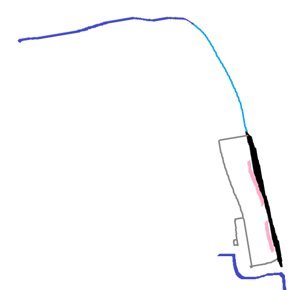

  7. Hum I'm not sure to understand the second part. First part is clear: check if weep holes are blocked. But second part I don't see the link between the water that could get in at the window and sealing the pink zones. I made this very ugly drawing (sorry 😅). The car is parked leaning over. We have the grey plastic of the inner skin, and the metal inner side of the door with the pink zone skomaz drew. Could you please draw what would be the path of the water in my case? If the water gets in at the base of the window, why would it help to seal the pink zone?

  9. Thank you for your replies. I'll try to run some checks on Saturday: I'll thrown some water over the door and check the weep holes. Also I will try the string test. My thought right now is more that because the side slop, it is easy for the water accumulating in the door threshold to get inside the car. When the floor is flat, maybe the level is lower and the water is not getting in. I made the attached drawing to illustrate (note it is a random car pic, not mine). As per the warranty, the problem is that the only thing I told before the end of the warranty was that there was condensation inside the car... Only after I realized it was because of the water getting inside. That's why I don't think they consider it is part of warranty. But I'll contact Skoda Customer center if I don't see any solution, thanks for advising. @skomaz is it easy to remove the door skin? I have rear manual windows BTW. I could remove the skin to check where water is coming in. I remember now that when I got the car, I realized it has audio speakers only in the front (yeah, 4 speakers doesn't mean 2 front + 2 rear 😑). Skoda never agreed to do the modification for me, so I asked a local car tuning company Skoda recommended. Could it be that when these guys mounted the rear speakers, they didn't do the waterproofing correctly?

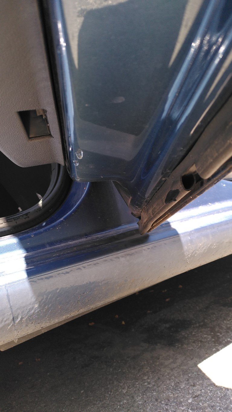

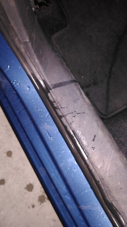

  10. Thank you for your input. I'll do the string test. But if it passes the seal, it means it is on the lower part right? Else I would see water drops from the inside. Could it be these drops that are visible on my 2nd picture? Not sure if the garage will agree to make a smoke test as the car is no longer under warranty. Again, they claimed there is no documented issue, so they say if the seal is new and the door is not crooked, they cannot do much. ☹️ (which seems completely crazy to me: am I supposed to keep a car that is leaking??) So to you it doesn't look like the same door accumulating water issue that on Rapids or other models?

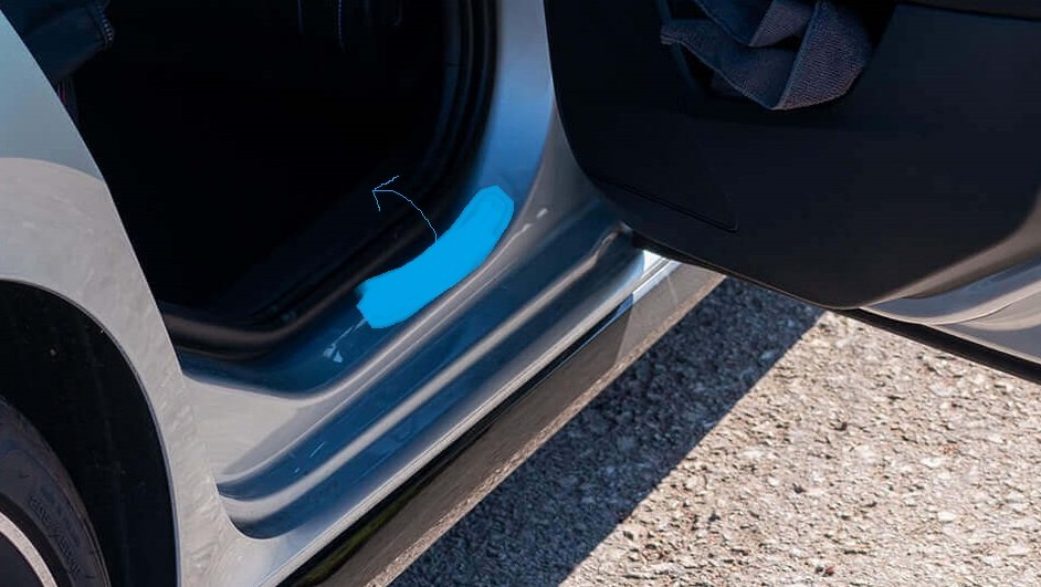

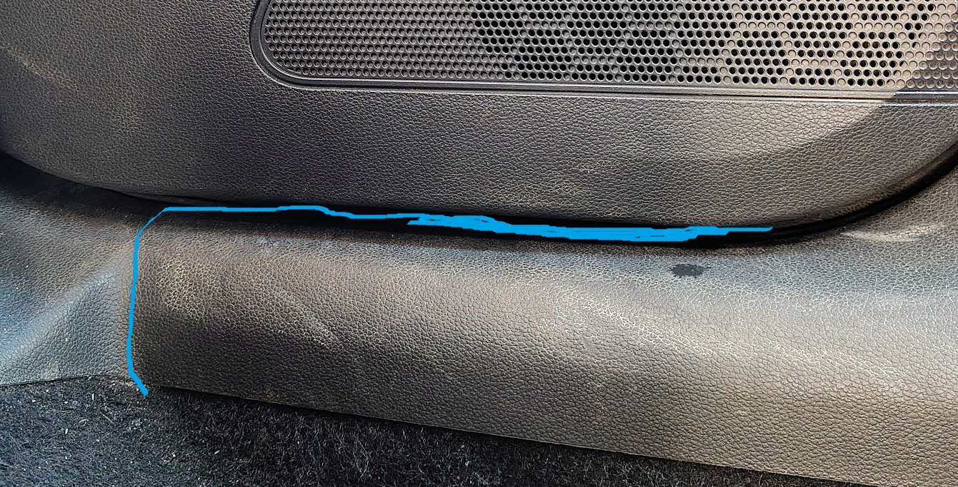

  12. Hi everyone, I've been experiencing a problem with my Scala since many years (bought it in 2021) but still Skoda France is not able to help/provide with a solution. I'll try to explain as english is not my native language. 🙂 This problem occurs when it rains a lot and that my car is parked in my street, which is slightly sloping (right to left or opposite). It started when I noticed some condensation on the windshield and windows of the car. Then I realized that the rear foot maps were wet after an heavy rain. I finally understood the whole story when I once opened the rear door, and discover that water was actually dropping from the rear door seal, on the higher side of the street. (see first picture) I told Skoda. The guy in charge of the car body department told me it looked like a problem with seal/wax that happened with some other models, and that solution was to cut the seal (see my questions at the very end). BTW they said they had nothing in their skoda registry about this issue. So they did these cuts, you can see one of them on one of the second picture. Then I started to monitor if this problem was still happening. I noticed that the cut of the left door was not located at the same position than the right door cut. I think it was too high on the seal, so the problem was still happening, the water was accumulating on a lower level (I must admit I'm not completely sure the problem was solved on the other side). I contacted Skoda again to ask to re-do the cut properly. This is when they offered to replace the seals, claiming that this problem should not be fixed by cutting a part that is supposed to block water. I have now brand new seals but the problem is still happening, as you can see on the 3rd pic with this thin water leak also visible on the foot map. I called Skoda again today, insisting that this problem should be solved. The guy responded again that there is no other report of such issues. He offered that I leave the car to them so that they can try and reproduce. After a quick search, I found out earlier today that some Rapids and other models did have a similar problem, but it was more about water accumulating in the door itself. So my questions to you experts 🙂 are: have you ever heard about the same issue with a Scala ? Is it documented somewhere so that I can told them "SEE? There IS something!"? Is it the same issue as with the Rapids a few years ago? Any idea how to fix it permanently? As the Skoda guy said, cutting the seals doesn't seem like a 'professional' solution to me. 🙄 Thanks for the help!
