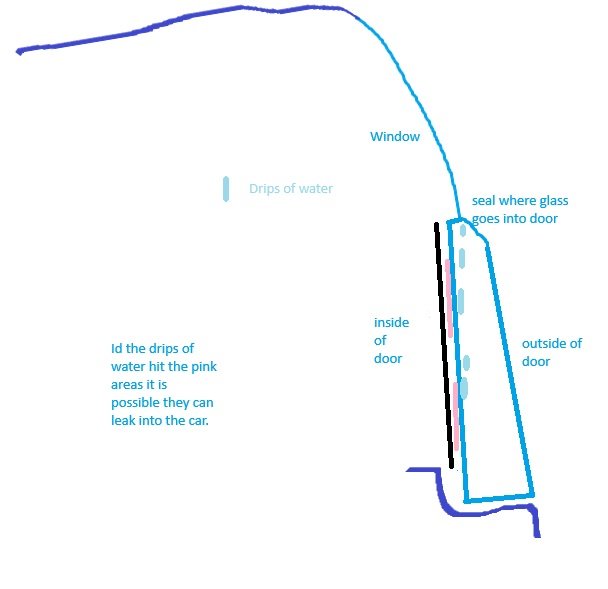

Skomaz I thought the door only had 2 skins inner and outer. Is there a frame in the middle as well?
I may not have phrased it too well but I'd expect the leak is from one, or more, of the areas in pink on the image below

If water is collecting n the threshold I very much doubt that it will get over the seal and into the car, unless the seal is not fitted correctly and water is getting under it instead (albeit that would still require quite a depth of water on the threshold before it happened.
From your pictures it looks like the water is coming into the car from behind the interior door trim - ie it is running out from the gap between the plastic interior door trim and the blue metalwork at the bottom of the door (you should be able to check this by feeling along that join or gently pulling the trim to see if any more water leaks out. If that is the case the only place it can be coming from is those pink areas I noted. That will either be because the original foam seal along those pink areas has perished, or because it might have been damaged during the speaker installation and is no longer sealing properly.
The doors are design such that any water running down the window glass naturally drains into the inside of the door and should drain away through weep holes in the bottom of the door. If they are blocked or the car is on a slope such that the water cannot reach those weep holes it will get out somewhere else at a low point that isn't sealed (for example those pink areas).
If it were me I'd check the weep holes in the bottom of the door are clear and then take the interior door trim off and seal around those pink areas with silicon or polysulphide sealant, which I think should cure your problem.

I made this very ugly drawing (sorry 😅). The car is parked leaning over. We have the grey plastic of the inner skin, and the metal inner side of the door with the pink zone skomaz drew.
Could you please draw what would be the path of the water in my case?
If the water gets in at the base of the window, why would it help to seal the pink zone?
Edited by jenny_pi
See if this helps
It does, thanks!
