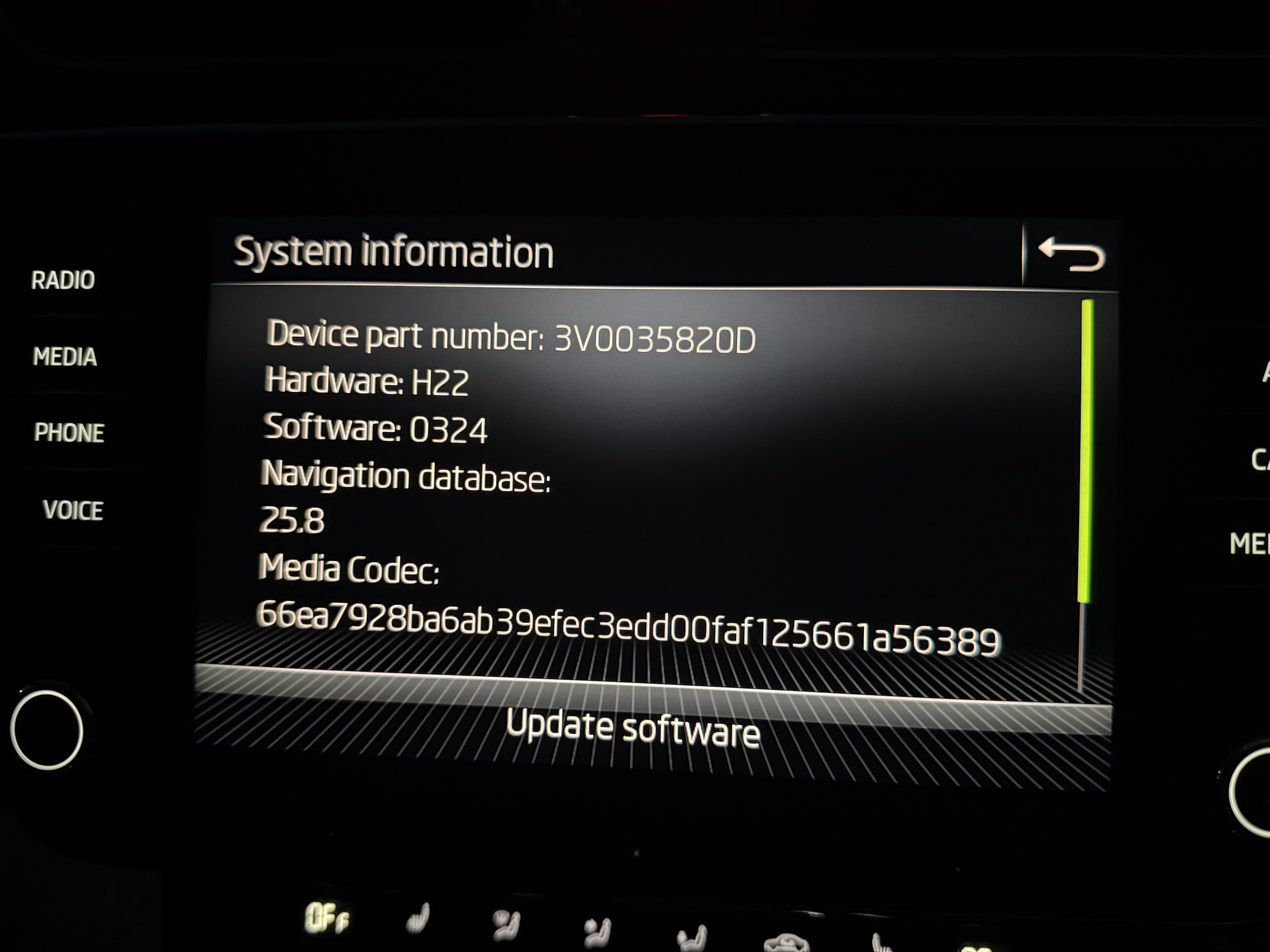

  2. sea118 started following RVC retrofit
  3. Hi all.. new here, been lingering and reading for a while and now proudly own a 2021 iV SEL. What a wagon! Really chuffed with it. It took me a while to find one in budget that wasn’t a million miles away but we got there in the end. The car I found had one option missing that I’d really like to have - a reverse camera to aid visibility backing out of our tight and blind driveway. I expected it would be easy enough to retrofit one. Alas, here I am. Donning cap in hand. Seeking assistance from fellow Briskodians. So, 2021 iV SEL. All the basic options nothing extra. Retrofitting a RVC. I’ve wired it up and the CAN sees it. But I cannot get the thing coded in with VCDS. I had a retrofit expert take a look and he advised the camera I have isn’t compatible with MIB3. Has anyone retrofitted RVC to these models? Can anyone point me towards a compatible camera or offer any advice? It seems there’s some updates with the facelift that makes the normal 2015+ cameras incompatible. Log-MT21JFJ-TMBKW7NP6M7055541-109402km-67979mi.txt Thank you
