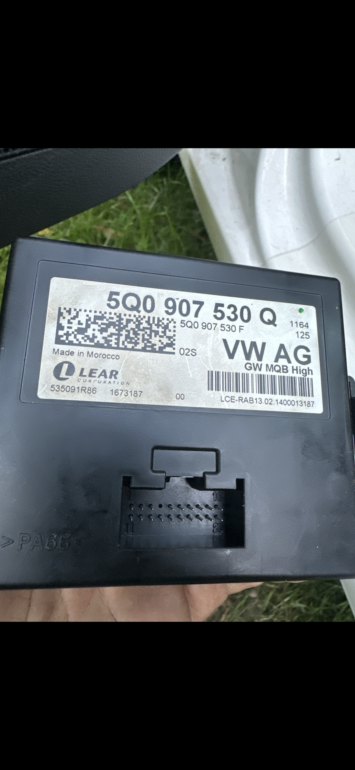

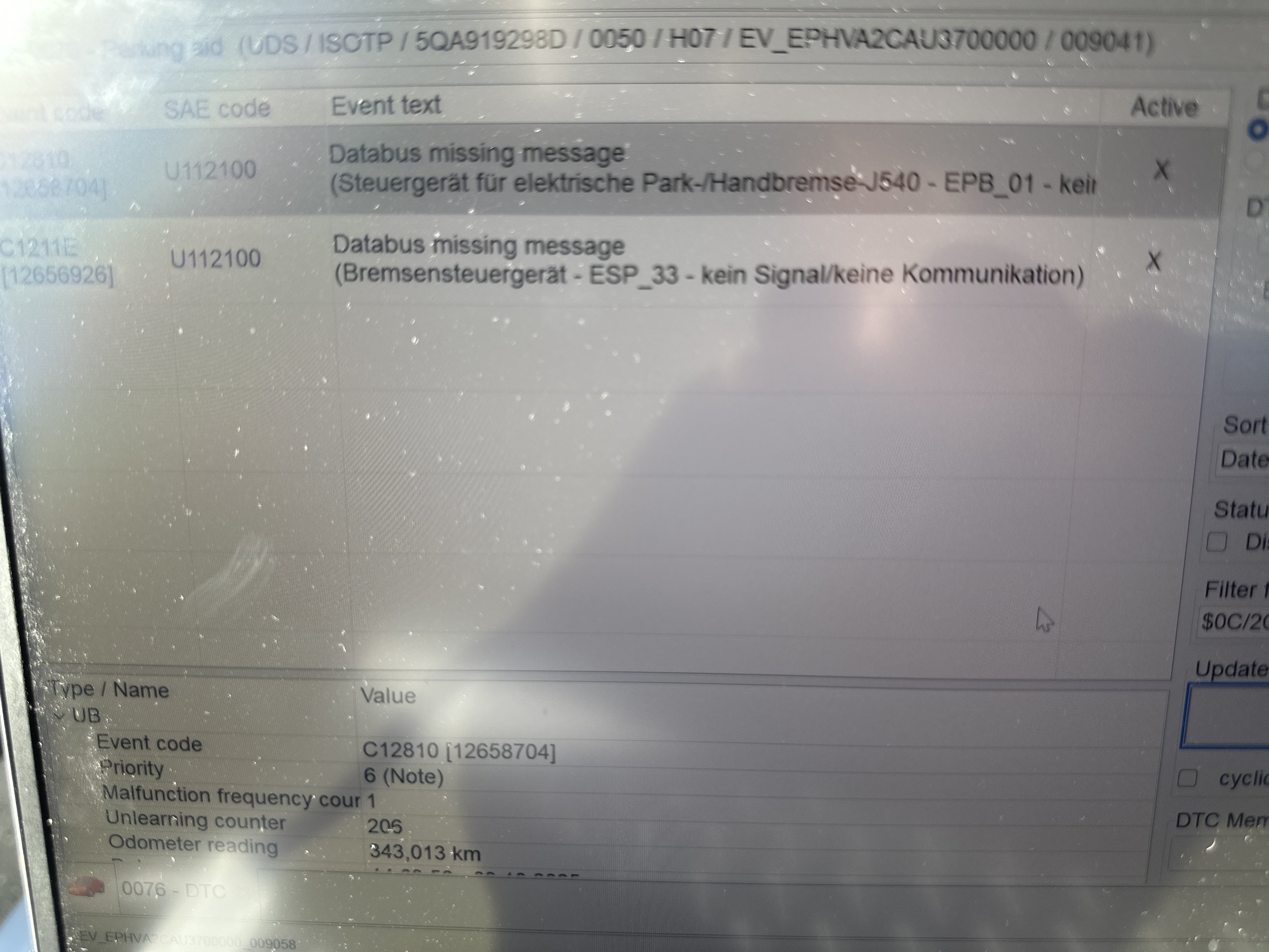

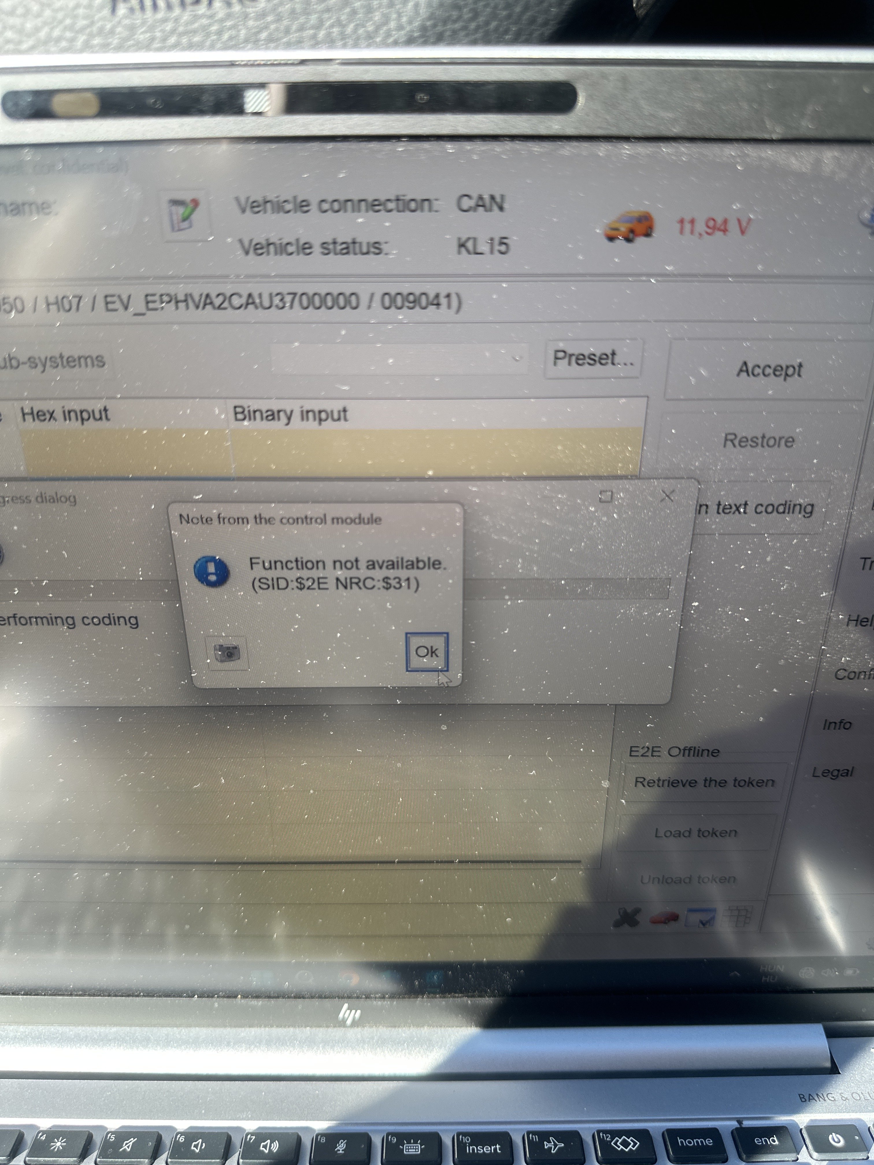

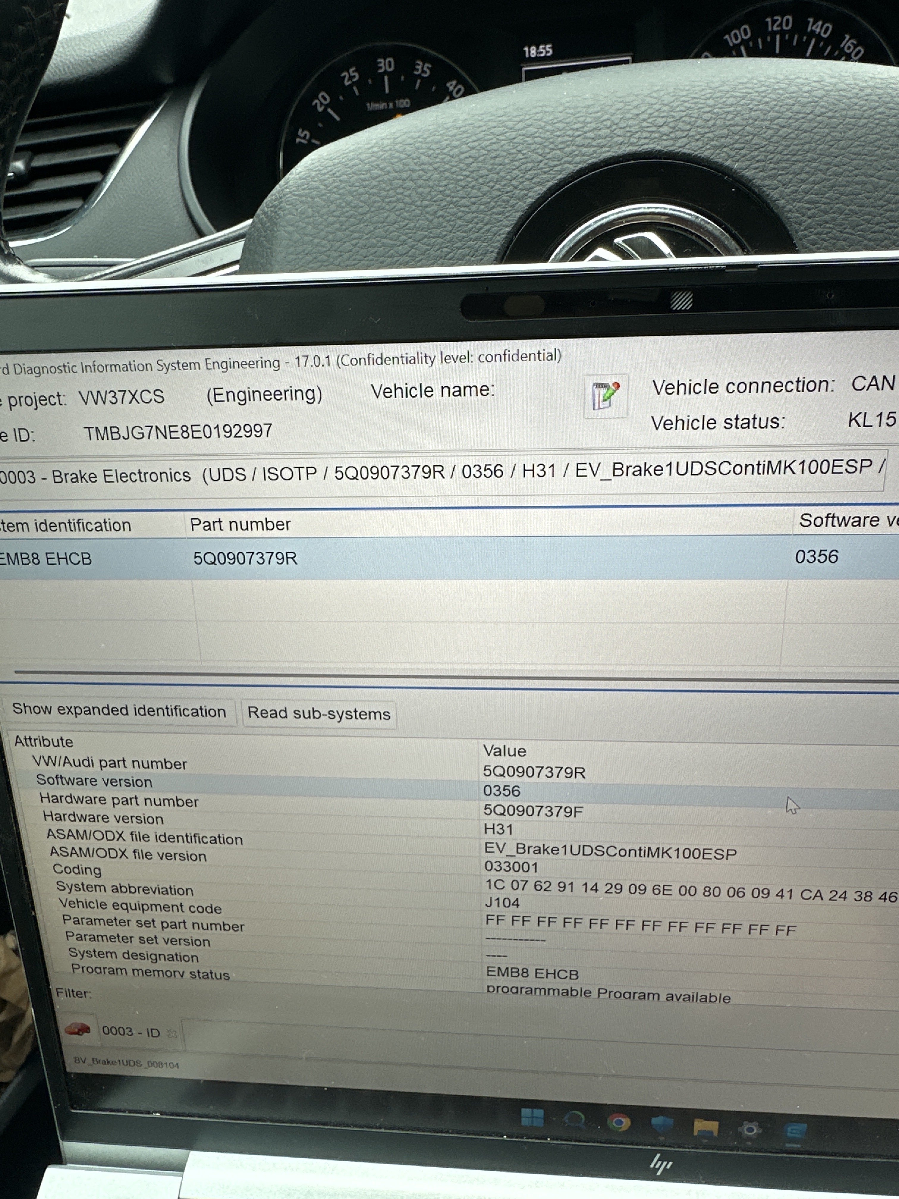

  2. Thanks for the reply! I’ve already checked my gateway module, and it’s a 5Q0 907 530 Q (GW MQB High).
