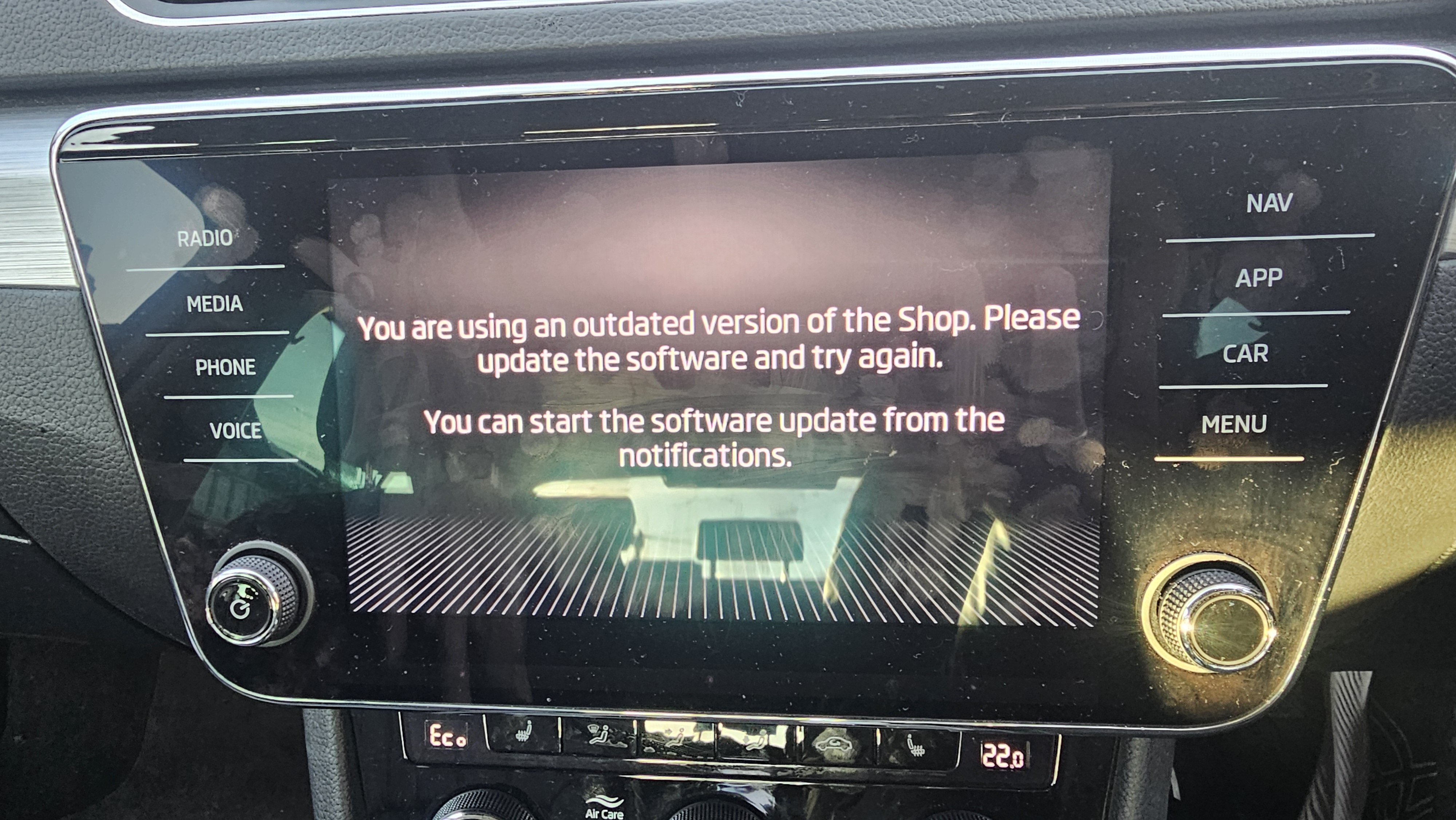

For a week now, without me updating or fidling with anything, i get this message when I try and go into the SHOP section of the infotainment menu. I use it to see how many GB i have left for the internet pack i purchased ( i use iradio a lot). It used to work fine before that. There is no update available in the Notification section... Anyone else had this?

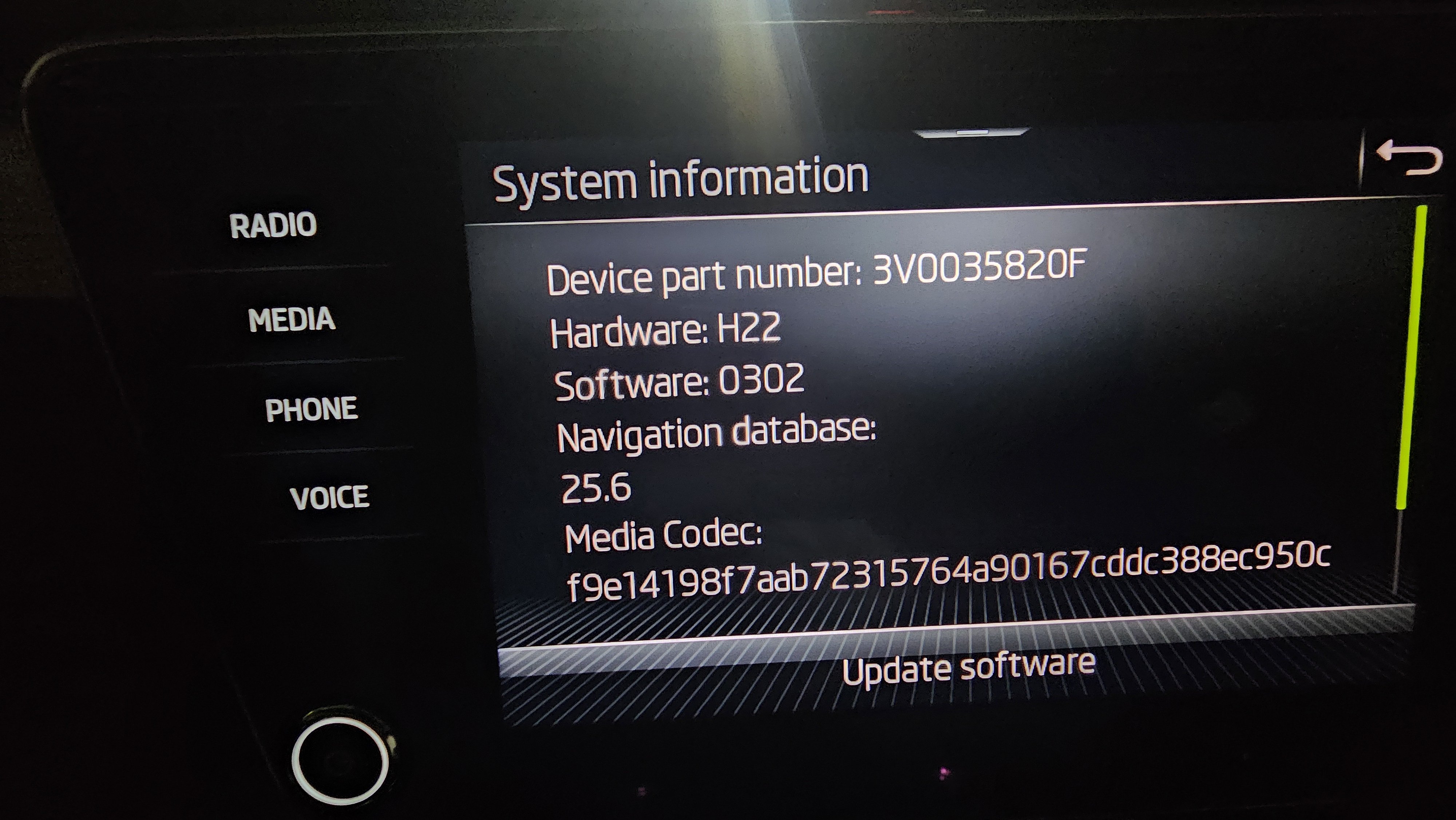

Thanks for the above info to all, very much appreciated. Can I just ask, what kind of infotaiment system is this for? I have the 2022 Superb iV SE Technology with the infotainment with two round buttons either side... 8 inch screen i think. Will the above work for mine as well? I am on 0302...
