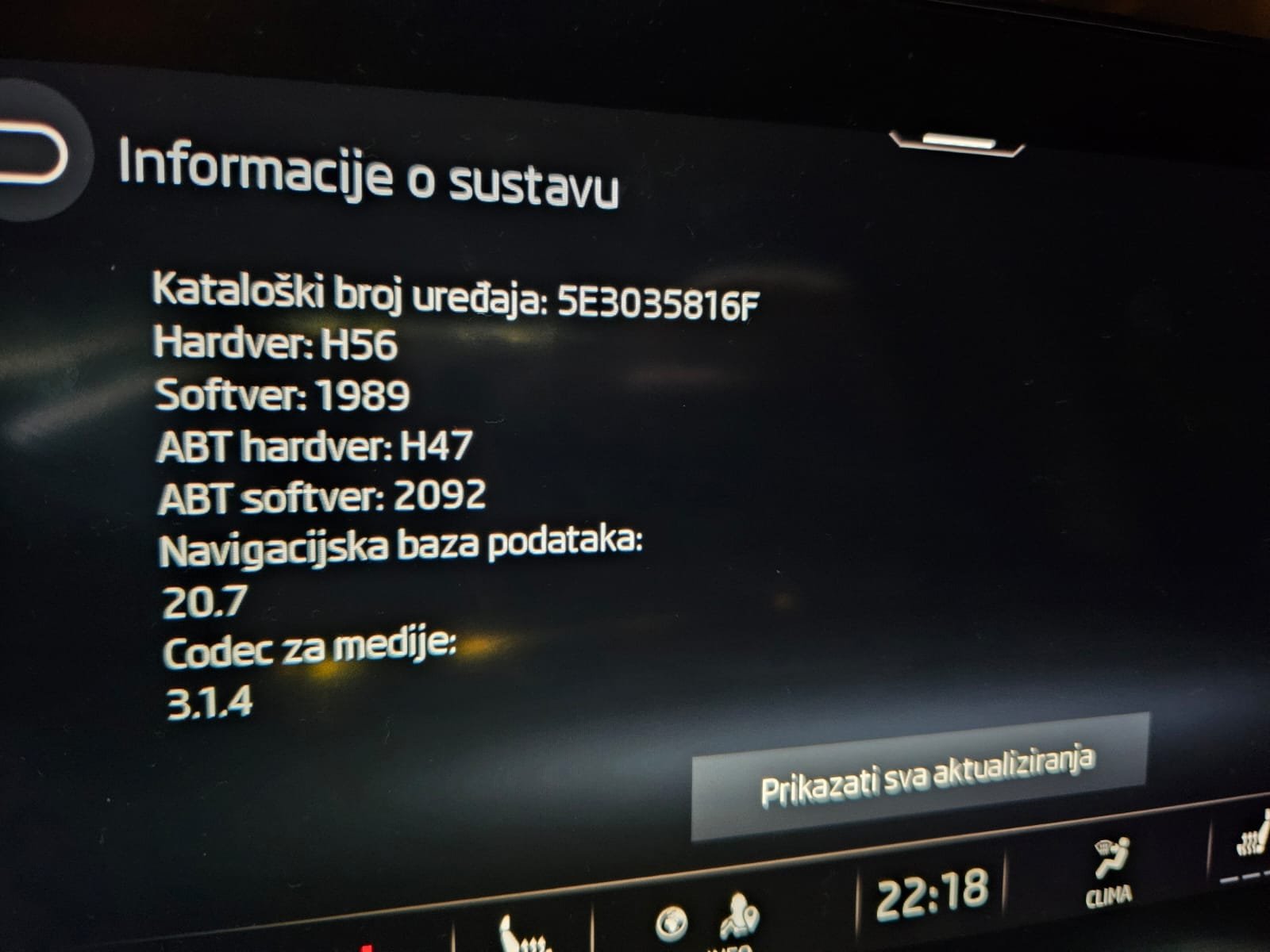

  6. I'm sure you're not alone, especially for cars made during covid
