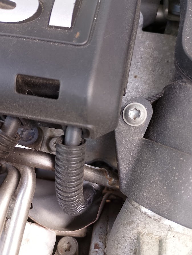

  7. Hello, I tried this and with the wire removed there is still no light! I replaced the oil switch anyway, as this is quite a cheap attempt at a repair, and there is no difference. Also noticed that the old one, when I took it out, has no oil on it, nor could I find any oil in the recess it screws into. Picture below. So, the oil way to the switch is blocked? And someone (previous owner) has disabled the red light, so that it doesn't constantly display? Apart from this, the engine is working fine. Not sure where I go from here!
