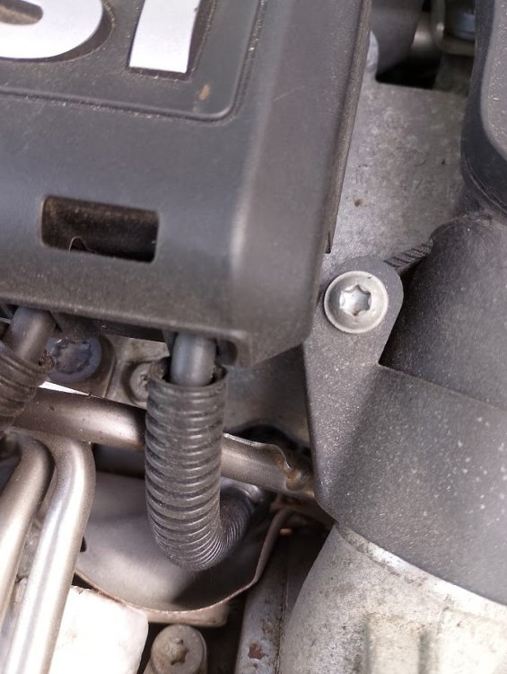

  1. Yes, this is still confusing me. I would expect some residual oil if it "drained away". Normally oil is difficult to disperse, but this sensor was totally dry. It led me to think it isn't operated directly by oil at all, but by a plunger inside the head. I've thought some more about this since my last post, and I think it's worth doing as above suggestion, i.e. unscrewing it and running the engine - at the weekend, I'm busy working until then ... Luckily I can use a different car.
  2. The oil is below threshold at first startup, yet there is no light .... that's because the on/off switch has been routed through the computer, to interpret it, instead of just displaying the result on the dashboard, like most other cars I've owned in the past. 🙂
  3. Hello Breezy-Pete, thank you, you are right! When disconnected, the oil light eventually shows (after nearly 20 seconds) but it's on the MFD (Multi-function display) in this Elegance model, not on the rev counter with all the other lights (where it should be in my opinion). It takes a long time, and, if there was no oil, then some significant damage could be done in that 20 seconds. Video link is below, so that others can see how it works. (The wire comes off easily in the video because I'd previously unclipped it, so I could remove it with one hand, holding the camera.) I think Skoda have tried to be too clever here, and an on/off switch would be adequate. So it's possible my old switch is fine. By the way, the new one was a proper Skoda one. Thinking this through, my test doesn't actually prove the pressure switch is working, merely that it's providing a signal all the time. To test it more, and prove it drops the signal when there's no oil pressure, I'd have to unscrew it, re-connect it and then run the engine with it unscrewed. But I think I'll leave well alone now. Thank you for your help. Video link: https://youtu.be/Ae1Ofbnhhtk
  4. ok, will do, thank you, will try early this week.
  5. Ok, I'll try (not tonight, now it's dark) but I thought at idle it would need to alert if the oil pressure somehow fell to nothing. The engine would be damaged at idle. Also, I thought it should show at a cold startup, just to show the light is working, like the other lights do.
  6. No, I shall do if that's what it takes, but I'd assumed that with the connector unplugged the light would be red?
  7. Hello, I tried this and with the wire removed there is still no light! I replaced the oil switch anyway, as this is quite a cheap attempt at a repair, and there is no difference. Also noticed that the old one, when I took it out, has no oil on it, nor could I find any oil in the recess it screws into. Picture below. So, the oil way to the switch is blocked? And someone (previous owner) has disabled the red light, so that it doesn't constantly display? Apart from this, the engine is working fine. Not sure where I go from here!
