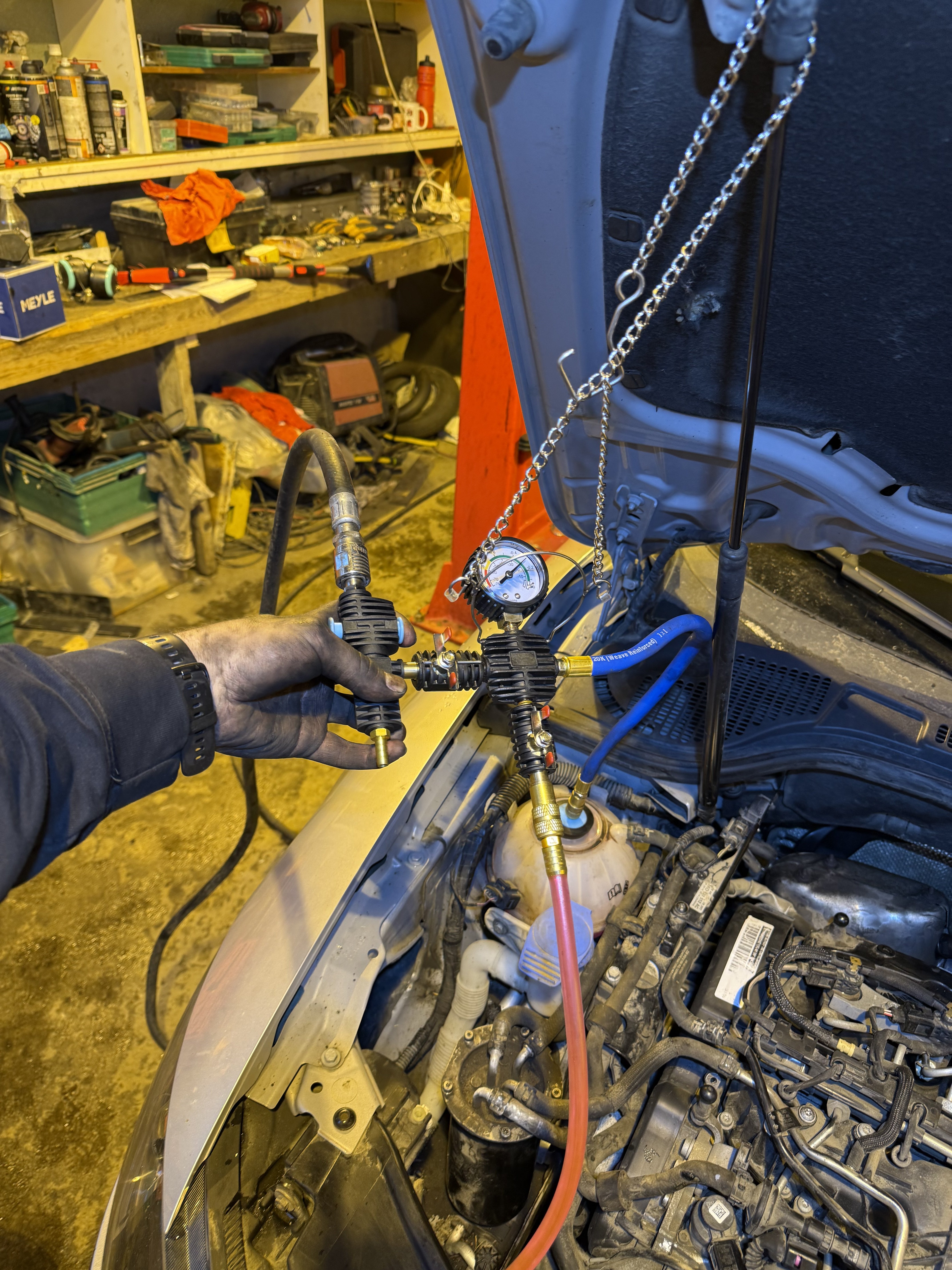

  7. Yes pretty sure, the oil temp follows the coolant temp about 10 degrees more than the coolant temp which is normal
  8. yes, the new and old T-stat both work, visiual confirmation, read with OBD scanner, the cars gets heat from the climate control and all hoses are hot but its just not gaining oparating temp.
  9. Engine not reaching or holding operating temperature – 2.0 TDI CFGB Hey everyone, I’m having issues getting my engine to reach and hold proper operating temperature. It warms up very slowly and often drops back down when driving, especially downhill Here’s what has been done so far: New main thermostat (OEM spec) New DSG thermostat EGR cooler delete EGR delete (software + hardware) New timing belt kit New Continental water pump System has been vacuum-bled and refilled using proper filling equipment Car: Škoda Superb 2014, 2.0 TDI (engine code CFGB) Despite all this, the car still won’t stay at full operating temperature — it hovers around 70–75 °C, only briefly touching 90 °C before dropping again. Any ideas what else could cause this? Could there be something with coolant routing, the secondary loop, or a bypass issue? Thanks in advance!
